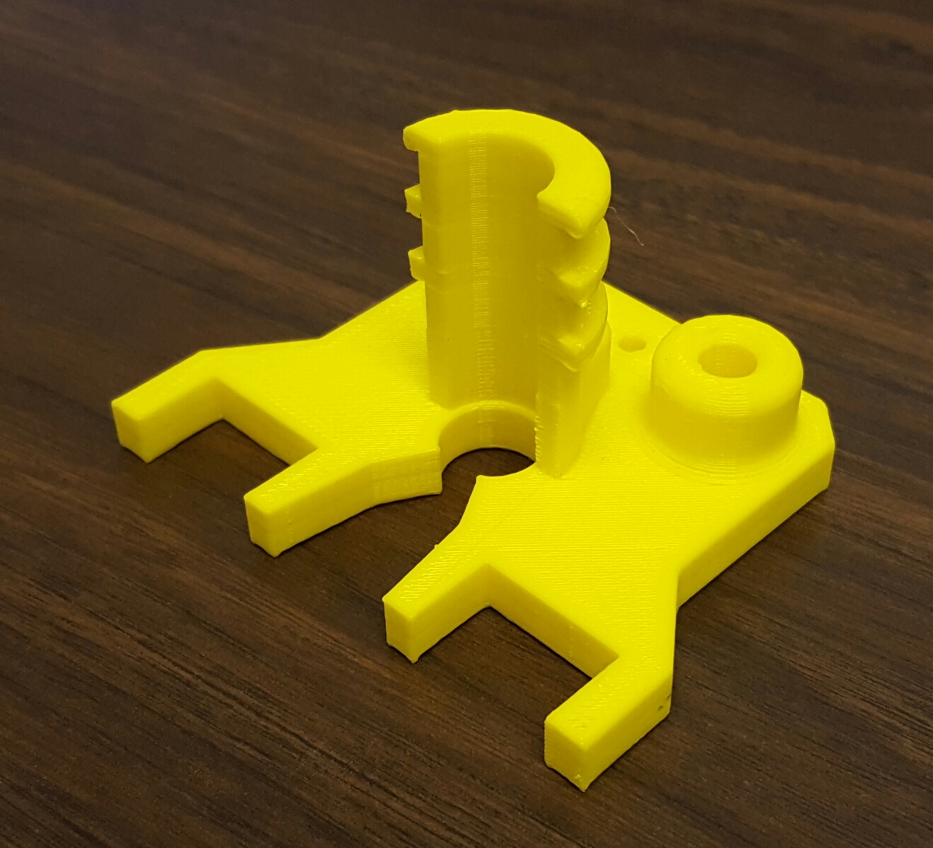

There are tons of spool holders on Thingiverse, but I’m attaching the ones I came up with. These plug up the side handle holes, plus allows you to put the spools on the sides. They are designed to handle the large-hole spools that Microcenter sells. I generally feed the filament around back and under the same-side, back factory-installed spool holders, then up into the filament guide tubes. Haven’t had an issue after printing dozens of spools through the printers (I have two PowerSpec 3D Pro printers).
The next things you’ll want to do is go get a glass print bed set up (buy a sheet of glass or mirror at Lowes/HomeDepot, have them cut it to size, print bed corners and a Z-shim, and a couple cans of Aquanet hair spray).
Other things on the horizon would be active cooling (not sure if the 2 comes with a print-cooling fan), and nozzle upgrades.

new_powerspec_side_plugv2.stl 11 (120 KB)
new_powerspec_side_spool_holderv2.stl 15 (43.1 KB)

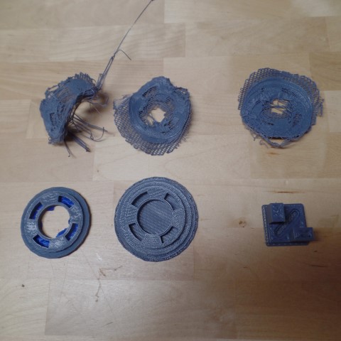

I am attaching my first few parts.
The first pic is a progression. Top left is the first print. Bad. The bottom left is the 4th print. I tried painters tape since I was having a really hard time getting parts off the bed. Doesn’t work very well with the heated bed at 100C!!! It also wasn’t right size wise.
The next print to the right is after I bought Simplify3D and found all the parameters for bed temp, raft layers, etc. It popped off pretty easy and fits. These were the spool adapters.
The last print bottom right is the glass bed clamps. They turned out pretty good except for the drooping.
The engine block I printed on fast, .2mm layers, 60C bed and 205C nozzle. It’s ok but the drooping is bad. I printed this before the glass clamps so I thought the clamps would be ok.
The FU hand pics show the better quality of a smaller layer level, better temp control, and supports.
The main questions I have now that I learned a bit about temps feeds and supports is
1: Why would the finger have such a different texture than the bottom? (granted, this was before I put the duct on the fan)
2: What could I change to make the clamps without adding supports? Or is that not possible since it is a 90 degree overhang.
3: What do you use to get the supports off? Some snap off, but the ones inside the palm of the hand look like a problem. I do have a few dremel tools and various bits but when I tried some they grab and dig in.
