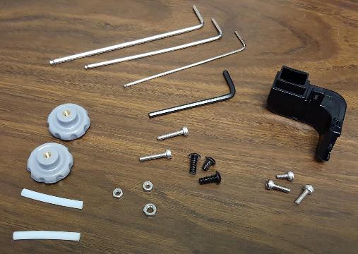

I also just picked up the same PowerSpec 3D Pro 2 printer yesterday at MC. It’s all together but I do have a few parts that I can’t figure out what to do with. There are screws, nuts and 2 little thumb-wheel grey screws with brass inserts.
Are these just spares?
Also there’s the little black piece that I have no idea what it is for. The “sensor” cable shown in the pdf manual didn’t come loose in the box and looks like it’s possible already installed. Guess I will find out on that one.

Yes, majority are spare parts. One thing you want to watch out for on these printers is to print a replacement plastic plate for the one that sits above the extruder that better strain reliefs the loom of wires. As the print head moves around it can (and does) flex the brittle thermocouple wires at to much of an angle causing them to break inside the insulation. They can not be repaired and have to be replaced at that point. I’ll be uploading to ThingIverse one later tonight that I designed and seams to be working quite well (dmyers7). The others on there where tweaked for oddly different mods and therefore the dimensions for the stock parts are slightly off.

Sounds great, thanks for that tip! Any idea what the 2 white tubes and the little black plastic piece are for?
Still scratching the noodle on those.
Two white tubes are replacement Teflon tubes that go up inside the print head just above the tip. These eventually brake down from the temps the print head runs at, especially at 250c for PETg. Don’t change the length. Will have to review the image again for the black parts you mentioned.
The black part in the image is the fan duct for cooling freshly printed layers of PLA. Install that.
