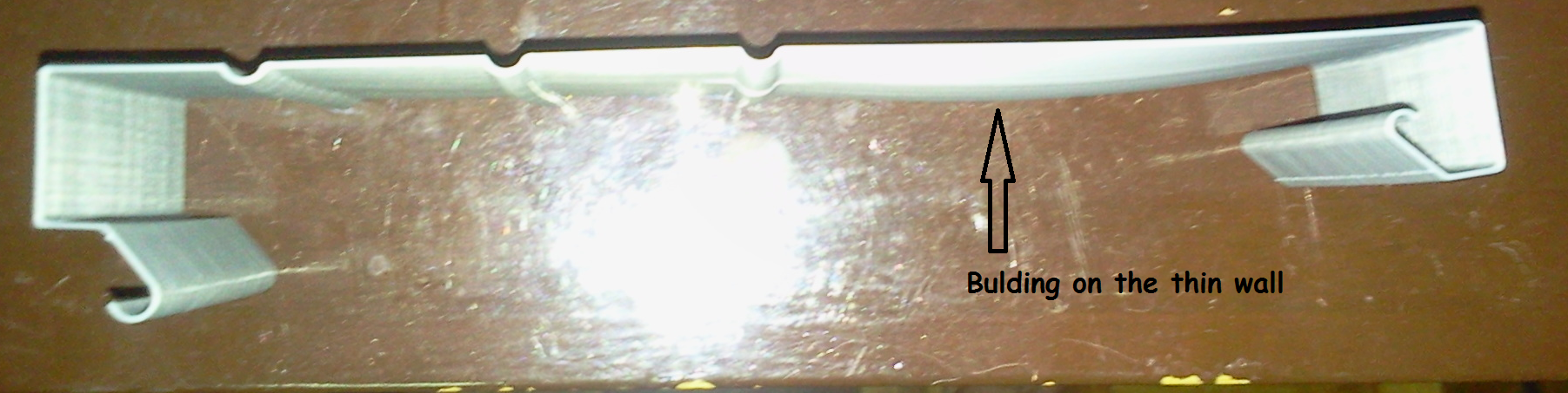

I am trying to print this thin wall object vertically from print bed. As you can see from the image it has a bulging part. This happens halfway midprint. My settings are as follows. By the way I do not have any first layer warping issues with this one, only problem is the bulging or bowing part.
Material : ESUN ABS+
Extruder Temp : 225C
HBP Temp : 110C
Speed : 60 mms
Tried Turning on a fan in front of it, and it just cracked. So I need your help guys, please. Thanks is advance.

I don’t typically print in ABS but you usually don’t want to cool ABS while printing. You want keep that environment as warm as possible and let it cool over time. Do you have an enclosure on your machine or is it in open air?
Try slowing print speed down to 40mms.
Also so that bed temp seems a bit high. I print at 100C.

Yes I do have an enclosure, but I opened the enclosure as soon as I saw that bowing effect, thinking that my chamber was too hot. It is a very thin walled object, actually two peremiters thick only, and without infill. Do you think I should go hotter on my extruder temp or cooler? Thanks for your response by the way.

This happens to me all the time with ABS or ABS +. I personally have resorted to making a custom support structure to reinforce the area that I remove later, might take a bit more time to print but it helps to avoid bulging, in most cases.
S3d has a feature called “ooze shield” for dual extruders… I use this feature to build a wall around ABS part for insulation. The heat remains between the ooze wall and the part. Yes, this works for single extruders. Printing With Multiple Extruders | Simplify3D Software 6
I suspect that those 3 grooves are your issue, As the part cools, those grooves widen out and push out on the wall. Try adding a few more grooves where the bow is, Thus the part is even down the entire length.
If more groves are not an option… Add small beams across the grooves and cut them out when done. The small beams will keep the grooves from expanding/shrinking.

I never thought of that analysis, regarding the grooves. I could not add or remove the grooves since it is a design from a client of mine. I’ll try that beam method, but can you show me an image example maybe on how it would look with beams. Thank you very much by the way.

The method I use is very simple, just add thickness to the piece by copying and extruding extra walls. In the picture I choose to print flat because heat dissipation through the print is not bad at all and this method inherently avoids warping (at least it works for me). However, if you have no choice but to print vertically, simply add some extra to the center without connecting. I have a 0.1mm gap between my piece and the added support walls, they sometimes stick together but break away easily at the end. Hope that helps.

Its a rough sketch… Make them as wide as your nozzle diameter, and line them up so they are easy to cut with a razor blade. Since it a relatively straight edge, It should be easy to cut… I prefer flush cut PCB pliers over a razor blade.
Oh and… measure your grooves at the top, middle and bottom to confirm if that is the issue.
