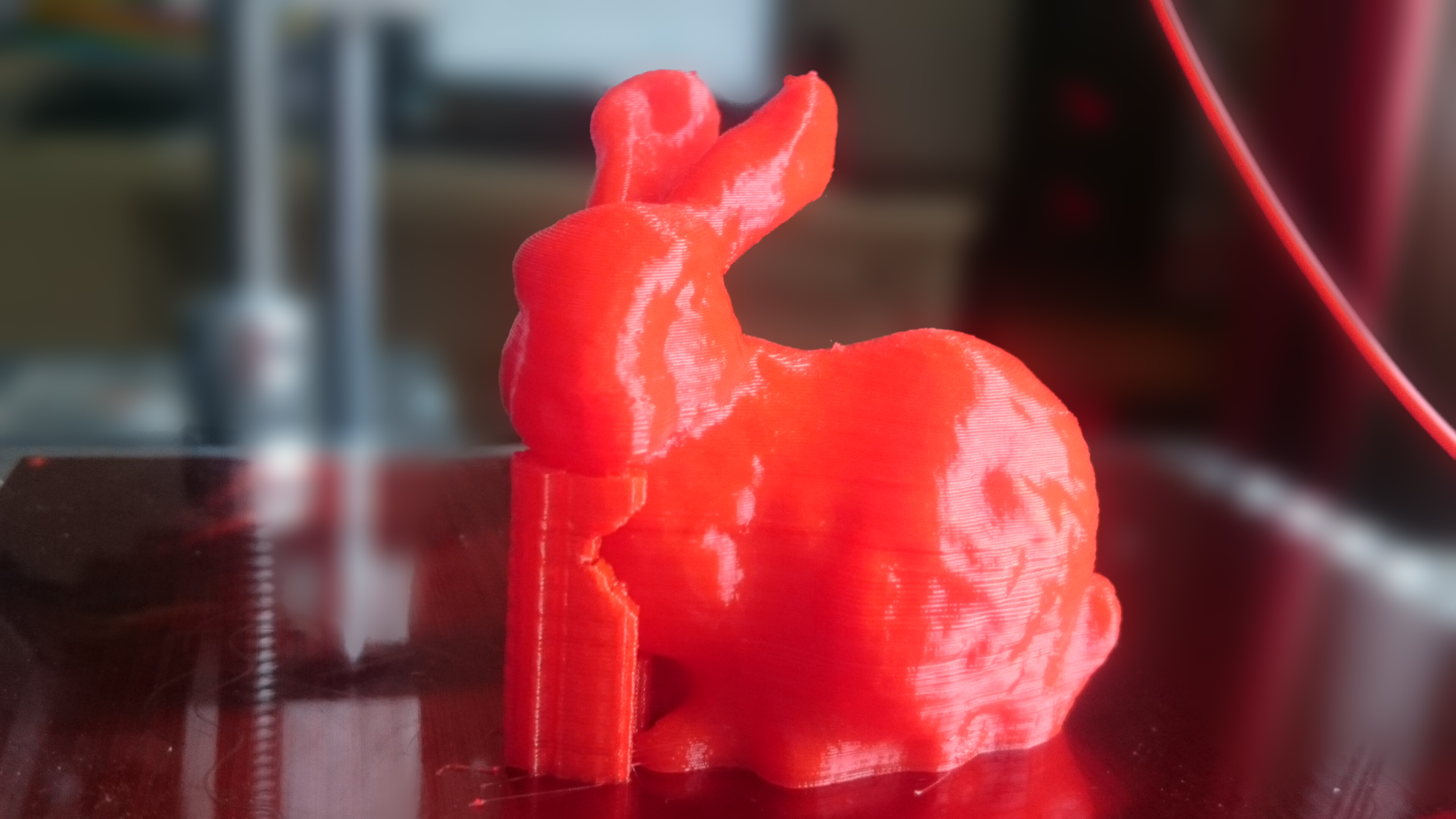

After solving my last problem a new problem occurred literately overnight (yesterday everything was fine!).The only thing that happened is that I moved my printer to a different location… So there something went wrong - but I cant imagine what
When printing the extruder stepper is moving way to slow. This results In under extruding.
The strange thing is; this happens only when printing. When I use the repetier / proterface manual interface and I click on extrude the printer extrude just fine.
Only when printing I can see that the steps the stepper makes are to small/slow. To the contrariety the retraction seems okay. Strange right?

UPDATE: as many suggested I removed the nozzle and cleaned it out. Same for the the ‘screw’ part on the extruder. I checked every screw and tighten it where needed. Furthermore I took the ‘tensioner’ apart and screw it back together.
That worked!
Here is a freshly printed bunny to thank you all for your suggestions!
