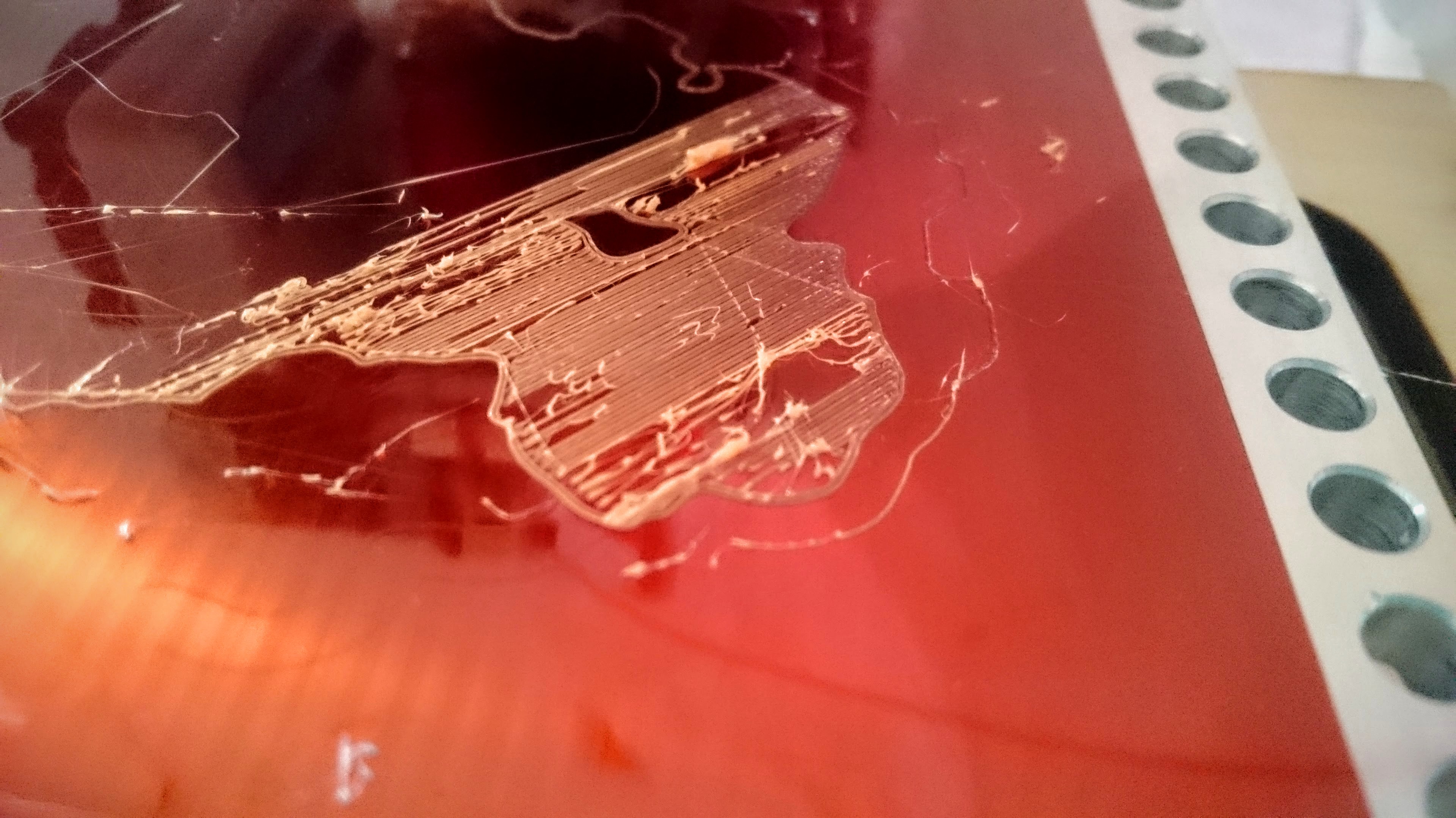

After solving my last problem a new problem occurred literately overnight (yesterday everything was fine!).The only thing that happened is that I moved my printer to a different location… So there something went wrong - but I cant imagine what
When printing the extruder stepper is moving way to slow. This results In under extruding.
The strange thing is; this happens only when printing. When I use the repetier / proterface manual interface and I click on extrude the printer extrude just fine.
Only when printing I can see that the steps the stepper makes are to small/slow. To the contrariety the retraction seems okay. Strange right?

To me looking at the photo it almost looks like the nozzle is too close to the print bed causing the nozzle to drag across the print and lifting what has already been put down.

okay, if this is PLA, you should be using Blue Tape… If it’s ABS, is the bed hot enough? Not directly related, I know, but just to clarify.
This looks like the Jr V2 with the Aluminium Extruder upgrade and I have worked with one of these for ages and they’re quite stable. Have you tried different sliced models? do you have some previously sliced GCODE that you can try and print with?
The first layer does normally print slower, but parts of the print look okay, apart from a little squashed and not sticking particularly well (which is why I asked the first question).
