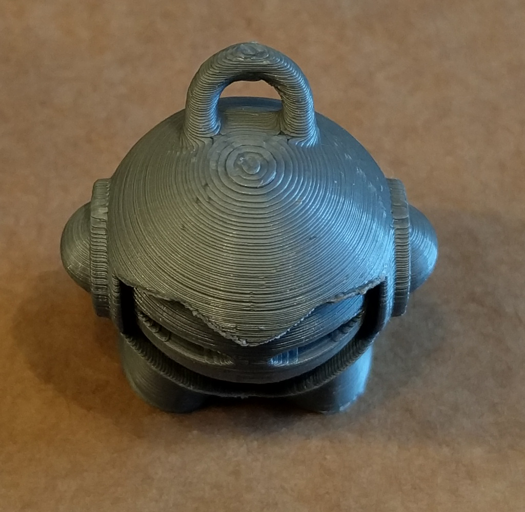

Ok so I tried printing Marvin that came on the SD Card. It still not as good as it should be…
Printed with 100 microns
Hi Bavilo, I also had those issues and what I ended up doing was buying the silicone socks from e3d and did the PID tuning with the sock on. After that it came out perfect
It has to do with the temperature deviation being to big… Here is a link to a video explaining how you can do it: E3D Silicone Sock on Original Prusa i3 MK2 + PID Tuning - YouTube

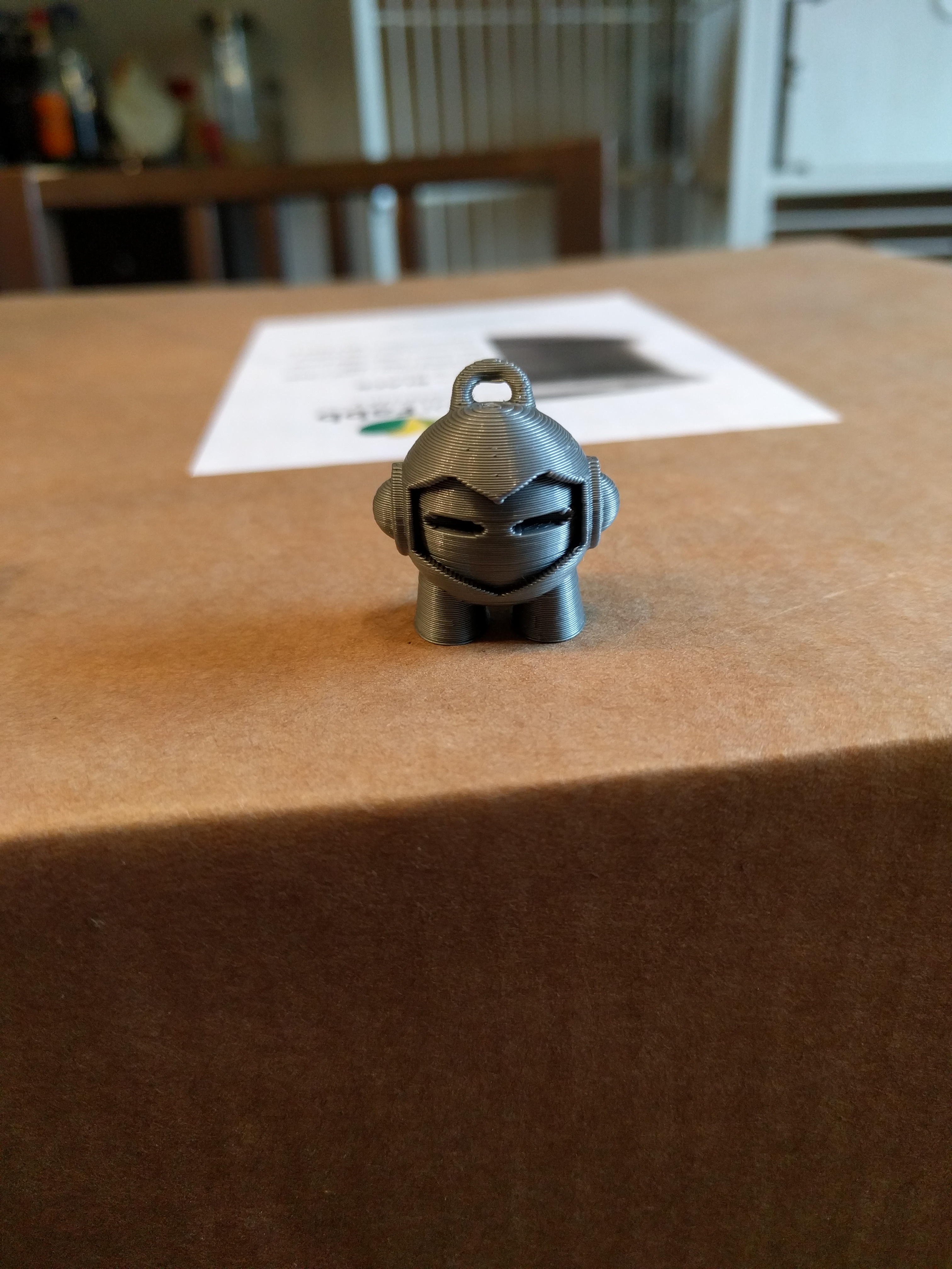

I have done another print yesterday, I will upload the result in a few hours. I have reset all my changes in the printer profile and used the default setup. On top of that I have tensioned the belts a little more (Not sure if this had any effect). But the print came out much much better.
Pictures will follow soon as I probably need to tweak it some more!
He looks pretty good.
I would work on a .2 version and get that nailed first before fighting with .1!
Remember temps are going to be one of the big issues on Marvin so printing 2-4 at a time can help. Temp on yours doesn’t seem bad though. Speed may be a factor. I printed at about 20mm/sec but then heat can become a factor more.
I think the settings are close so small changes and one at a time to see the effects of the change.
Some of the problem areas are good on yours like the key chain ring.

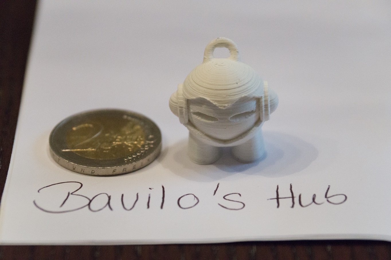

Ok so here are my latest prints:
200 microns looks good. 100 is still screaming for improvement. Is it still printing too hot? This was 205°C
I haven’t used slic3r much, but is there a minimum layer time? It looks kind of like the layers aren’t having much time to cool. Try printing one with a cooling tower next to it (print a Marvin and a simple small cylinder at the same height as the Marvin) at the same time and see if that helps. It also looks like you may have some z wobble. Make sure you y and x belts aren’t too tight, as that can cause the same issues. Print a 20mm calibration cube with low infill and extended in the z axis to 100 or 200 as well. This should give you an idea if you have z wobble around a certain height. Once it’s done if there is ringing around 110mm you know that something goes wrong at that height. I had an issue where my smooth rod for the right side of z was a little bowed, and at 140mm it bowed inwards, causing the x axis belt tension to get thrown off, causing some issues. Let me know if any of this helps.
What speed are you printing at? Maybe try slowing down a bit?
