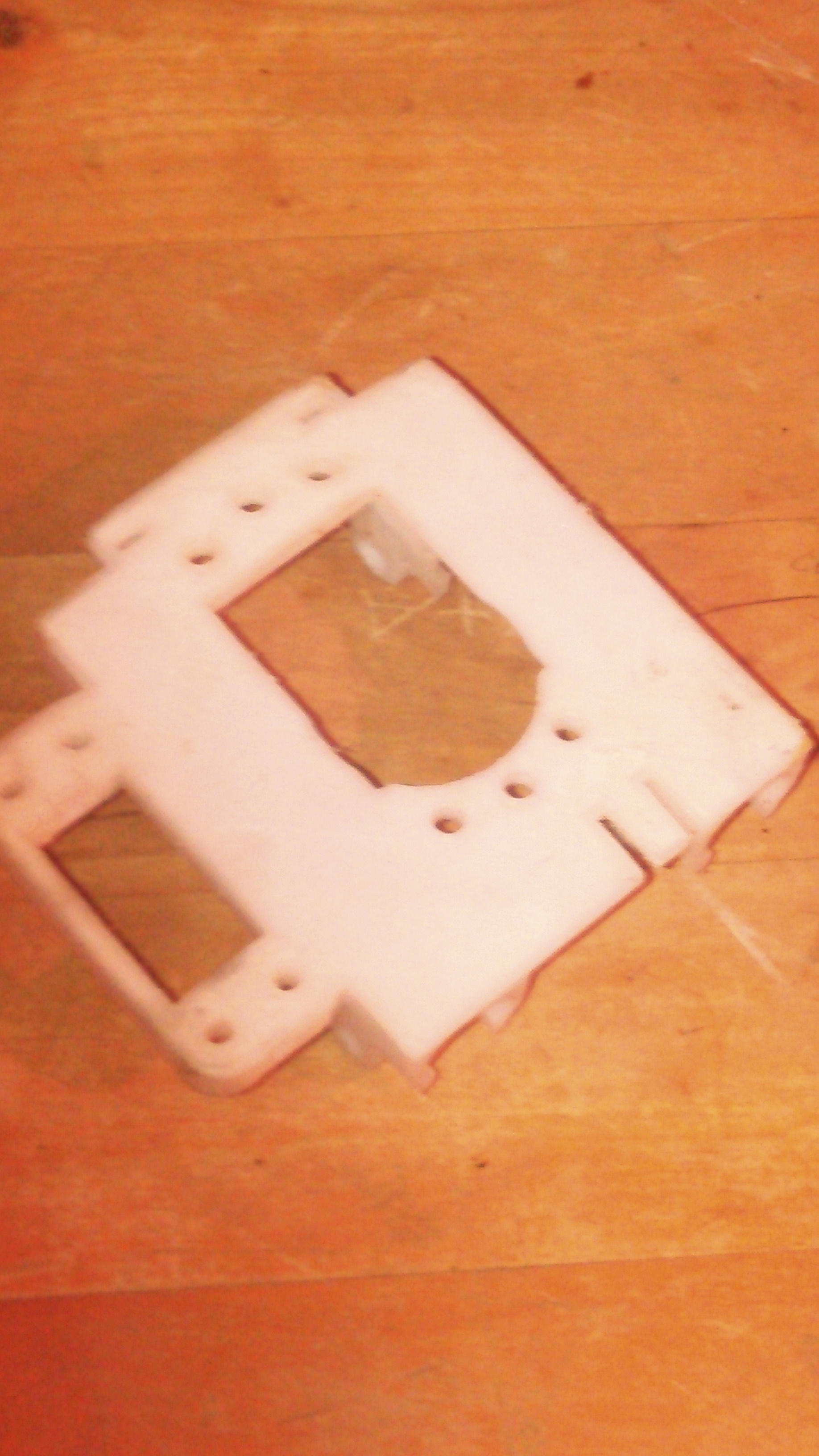

here is a link to the carriage I made
http://www.thingiverse.com/thing:226440
I will have to update the pics on this maybe tonight
but if you look in my collections as well you will find many great prusa mendel upgrades

this is the extruder I am using
http://www.thingiverse.com/thing:42495
