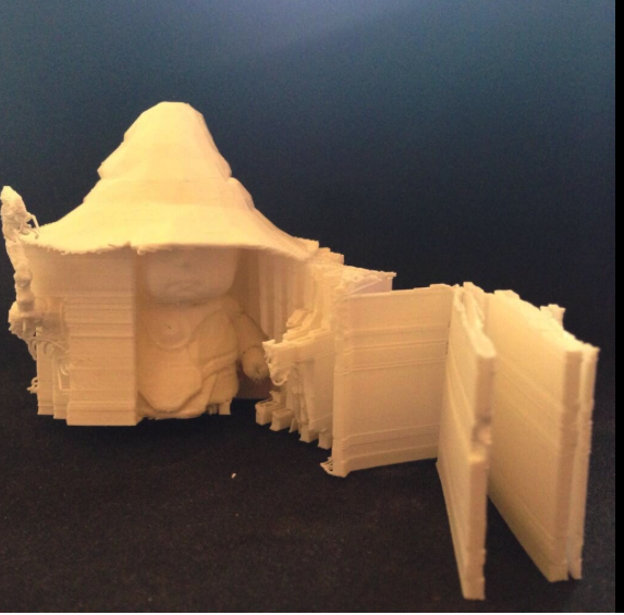

Based on info on the excellent (but now defunct) Makerbot Operators google group, I bought the Rep2 version of this http://devilsinthedetails.ca 31
It supports Rep2X too, I’m happy with it, although I’ve not managed to get ninjaflex to extrude yet, need to use the alternate spring I think.
Personally, I think it’s awesome, and well worth it, it does have some quirks and takes time to get settings ‘dialled’ in.
Being able to manually place support material in the GUI is a great feature.
The automatic support material generation is kinda cool too; it kinds generates a concertina that can be easily removed(see attached)
The slicer is *fast*, it is multi-threaded so uses all your CPU cores.
