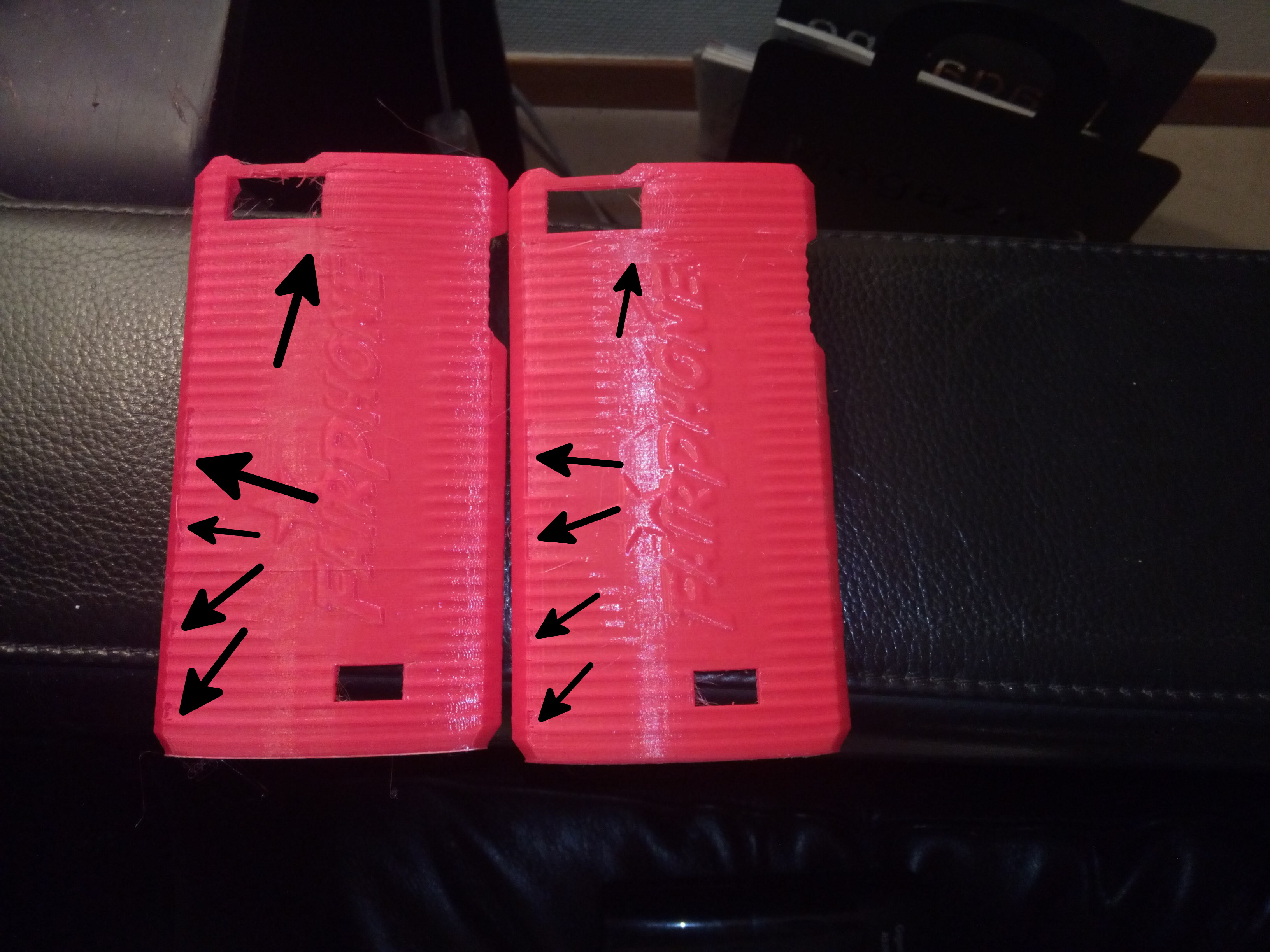

I have a problem with the branded Fairphone case. I use a Replicator 2. In my cases, we can see holes. They are always at the same places.
I use Simplify3D with these parameters:
Layer: 0.15mm
Infill: 20% <- perhaps it should be changed to 10%
Number of shells: 3
Speed: 4800mm/min
By writing and verifying my parameters, I perhaps found what is wrong…
Please, let me know if you had same troubles.

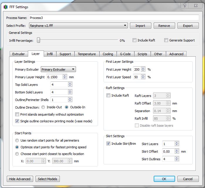

What are your nozzle width settings in Simplify3D?
Nozzle dia: 0.4mm (which is the real diameter)
Extrusion multiplier: 0.9
Extrusion width: 0.4mm

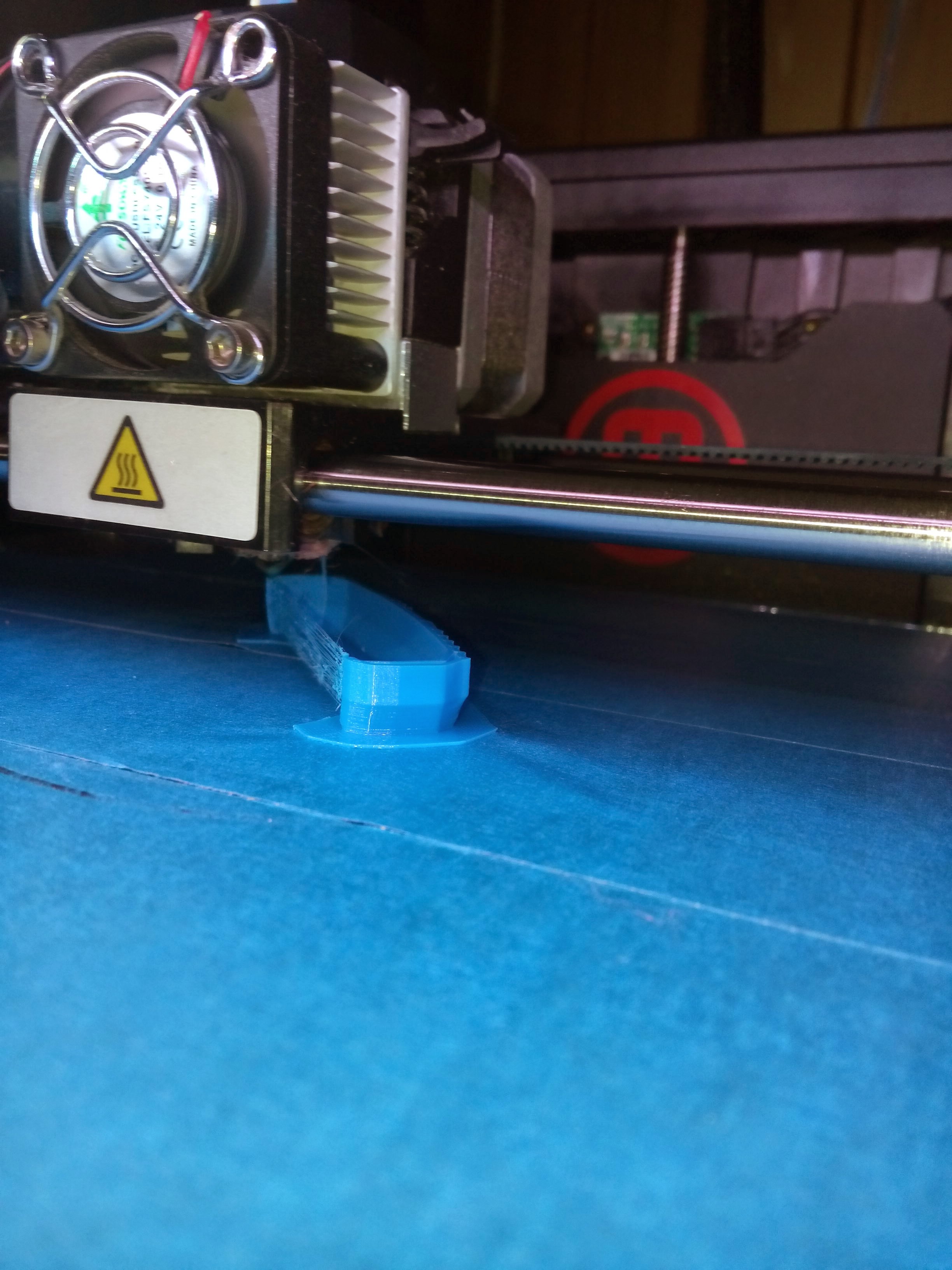

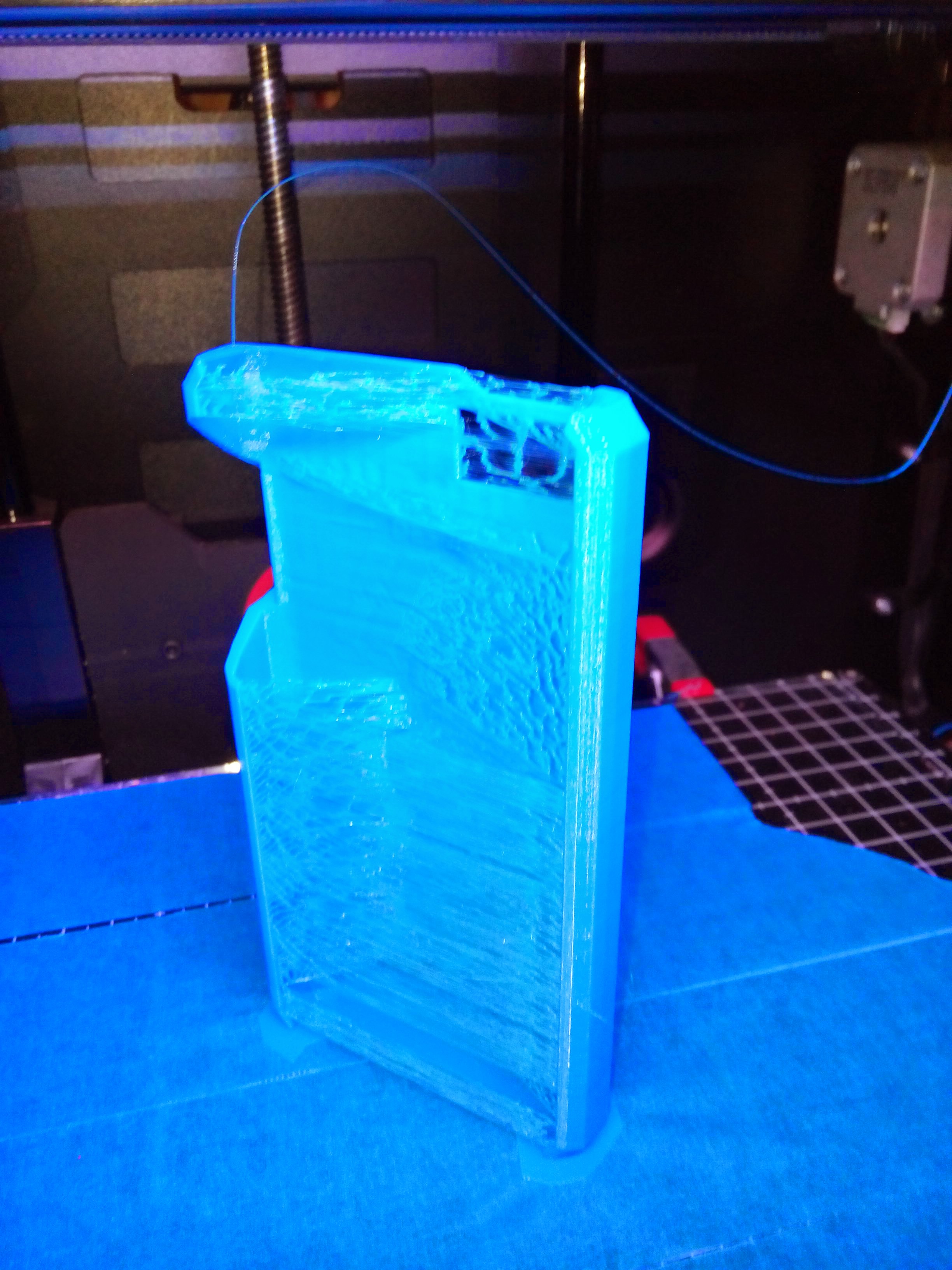

I printed about 10% of my print and it seems that you resolved the mentionned problem AND another one I was dealing with for a long time now.
My problem was to deal with retraction filaments. The back of the cases were messy at the end of the print. I had to do too much finishing (cutter and THF). For the moment, the filaments are only between the two end sides of the cover. It will be very easy to remove them using a cutter.
On the photo, you can see the current print.
I will come back with the final result for this print.

That’s good. I’ve seen problem when you set the extrusion width on auto. The other obvious one is filament size.Have you checked that?
Sorry, I didn’t notice the extra images at first. The last one makes it look like it’s the number of shells that could be the issue. Try printing with 1 or 2 shells.
And if you preview your print, perhaps you can see whats wrong. is it printed concentric or rectangulair?
How many top solid layer do you us ? Reducing infill won’t help
you should not be getting that stringing - the trick is to use single outline corkscrew printing - like drawing without taking your pen off the paper!
then randomise the remaining strt points.
I print at 3000 an it was fine.
And use a brim - otherwise it gets tricky at the top.
James
oops - noticed you are using a brim :slight_smile:
Launching a Fairphone branded case with your parameters (exactly the same) and I will come back to you in 3.5h! :wink:
Here is the result with these parameters… For the Technology case, the result is good… not perfect. I have quite a lot of strings and there are some tiny holes on the front side.
Then, I tried with the Fairphone branded case… As you may perhaps see (sorry for the quality), directly on the right of the Fairphone text, on the front side, you will notice many holes.
I am currently trying the corkscrew method (see below in this post).
@GloomySparker reduce your print temp to as low as you dare to get rid of the stringing and help the bridging.
The slower speed should help with this - but it is a fine line as you need to get good layer bonds and yet good bridging.
I always had to do a small amount of hand finishing with a scalpel and wet/dry sandpaper, but you want to keep it to a minimum!
