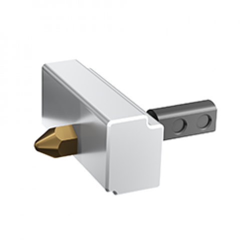

For the record, there are no HotEnd v3 and v4. There are v1 for regular Z-ABS, Z-HIPS and Z-Ultrat. HotEnd v2 for Z-Glass, Z-PETG and Z-PCABS, plus everything what v1 is capable. In addition ZSuite is not defining HotEnd, but it is allowing to chose material during build.To be clear v1 is still good with v4 ZSuite as long as you chose proper filament.

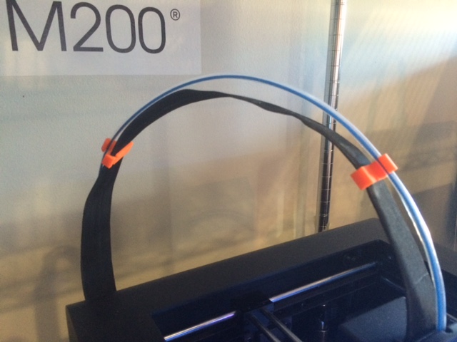

As these helpful members mentioned, there are software updates and a couple hardware changes (v1-v2 hot end) however, what has not been mentioned is that there were multiple hardware changes to
1. the extruder cable
and one change to
2. the perforated build plate (thicker)
So in reality it is not just a software change, some of the hardware does change from v1-v4.

Base printer in US is around $1,990.00, other elements varies. New printer generally are shipped by Zortrax with HotEnd v2 and plate v2 and side covers can be purchased separately, as they help preventing model warping.
