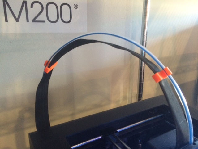

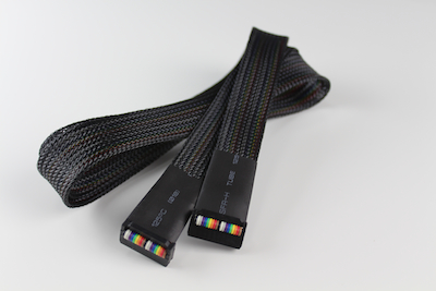

Hi Tareq!
As these helpful members mentioned, there are software updates and a couple hardware changes (v1-v2 hot end) however, what has not been mentioned is that there were multiple hardware changes to
1. the extruder cable
and one change to
2. the perforated build plate (thicker)
So in reality it is not just a software change, some of the hardware does change from v1-v4.
I have absolutely LOVED using the Zortrax m200! So much that we started reselling them!
If you have any more questions regarding v1, v2, v3, or v4 of the printer, please email me at:
service@protoripe3d.com
We would love to help you gain information so that you can make a great purchase!
Cameron
p.s. check out the pictures to see the differences…
early extruder cable.jpg v4 extruder cable.png v2 hot end.png v1 hot end.png
