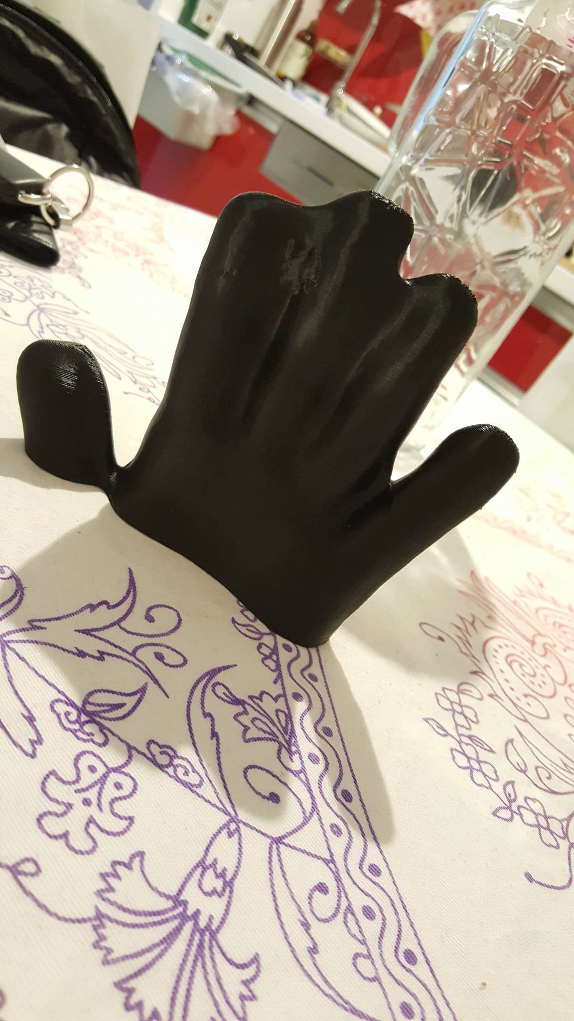

Well, thanks to everyone who put effort for my question, and here is where I get so long:
This problem first occured after 3.4 upgrade of the software but also it was a coincidence that I first time tried to print a Catia modified 3d scan file to print (I cut the arm scan into pieces to fit print volume)
I tried several different things I figured out by your helps, tried different stl generation processes no help, tried getting smaller slices so smaller files no help, and finally I tried to upload on website and Voi La! It just uploaded and synced the file perfectly and you can see what I got now.
So the problem is, Cubify is decided to steal every bit of printed documents in their cloud, even if you don’t want to share it anyone including the company. Now fraudulently have to give your designs to cloud system I suppose. It works like, if the sync time took so long, software says “cannot read” if you are logged out on software and the file is bigger than 1-1.5mb, it says “cannot read”.
So far, it seems we have a rip-off of ideas and designs here.

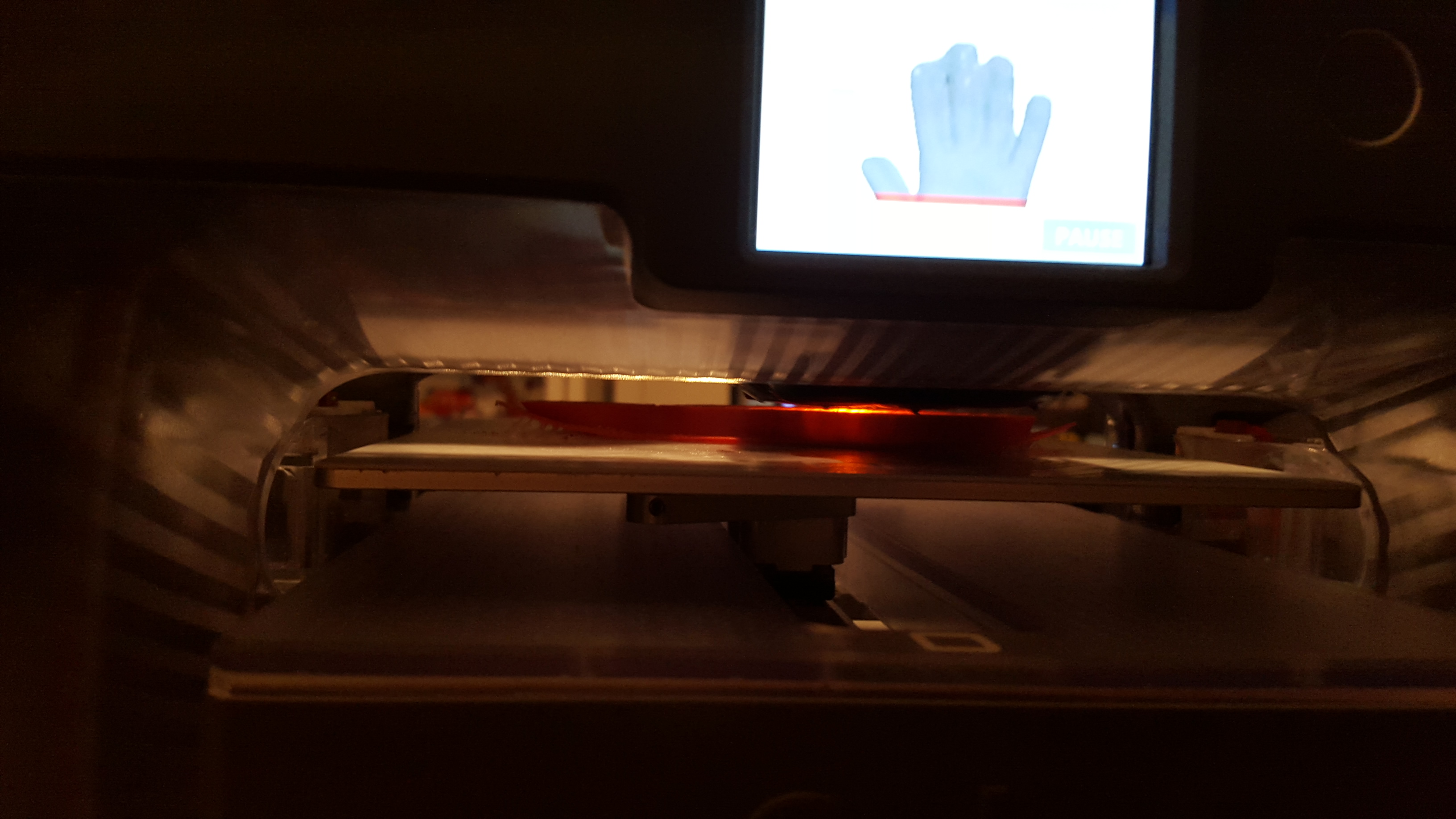

Sorry it took so long to get back to you. I hadn’t used my cube in almost 2 weeks and it forced me to update to 3.4.
I imported your hand1.stl into Cubify and it is printing now without any problems. I made no changes to this file at all other than import the .stl from you, create the .cube3 through Cubify, and print it through the USB key. Were you able to get it to start printing, or did it fail before it would print?
I will upload the cube3 file that I am printing shortly.
This is where the print is now. Of course, I didn’t put enough glue or heat up the bed enough (I put it next to a space heater or heater vent to get it warm) and it is warping terrible, but still printing without any issues.

Sorry for late response, I have no problem while printing. I have problem while loading .stl file to cubify software, so I can’t get a .cube3 file. However, I think I have find the reason. I’m posting as answer to root message.
Thanks anyway.
Thanks Luis,
I have reached same conclusion too.
