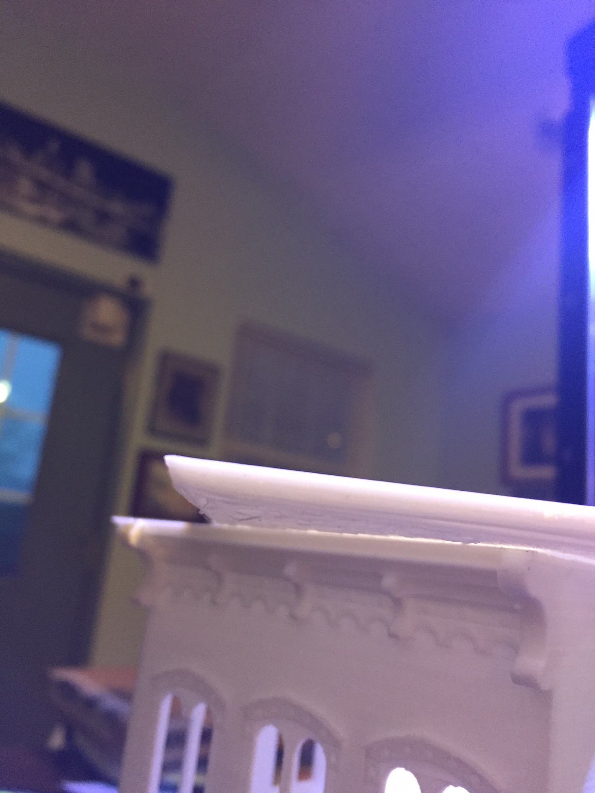

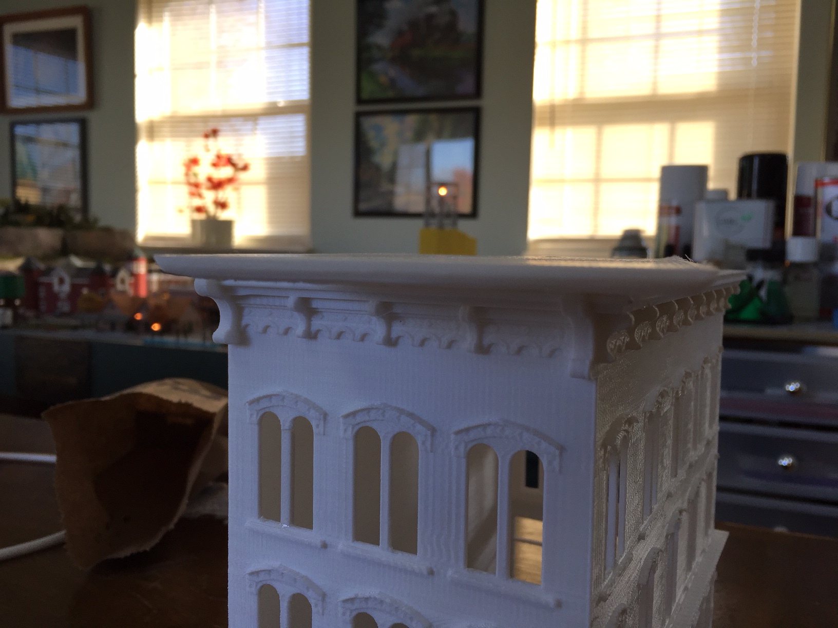

Hello all. I just purchased a Formbot TRex2 3D printer. I have been working with it all week trying to learn how to use it. On my third print, I had a small, very uncomplicated job. I was simply trying to print a rectangle 3"W x 8"L x 3/16"H to serve as a floor for a building model that I had 3D hubs print for me earlier. The edges did not come out square. From a side view, the printer made the edges at about a 45 degree angle, though this was not in the model. Any Idea what could cause this? I was using PLA at 230 degC.

Hello Tamas, thanks for responding. Yes below are some better pictures of the corners. No I didn’t print a test cube, that might be a good thing to do huh? I have made some test prints that have come out very nice. This one in particular however needed square edges.

Hi Frank!
The stl file looks fine, its just a simple rectangle no errors in it.
Was the print stick well to the print surface at all corners(bed leveling)? As this looks like the corners lifted /curled up during print and this caused the issue, so check the bed level again, and watch it during print if its lift up or not.
I would suggest to print a smaller test cube, to check how the printer prints walls.

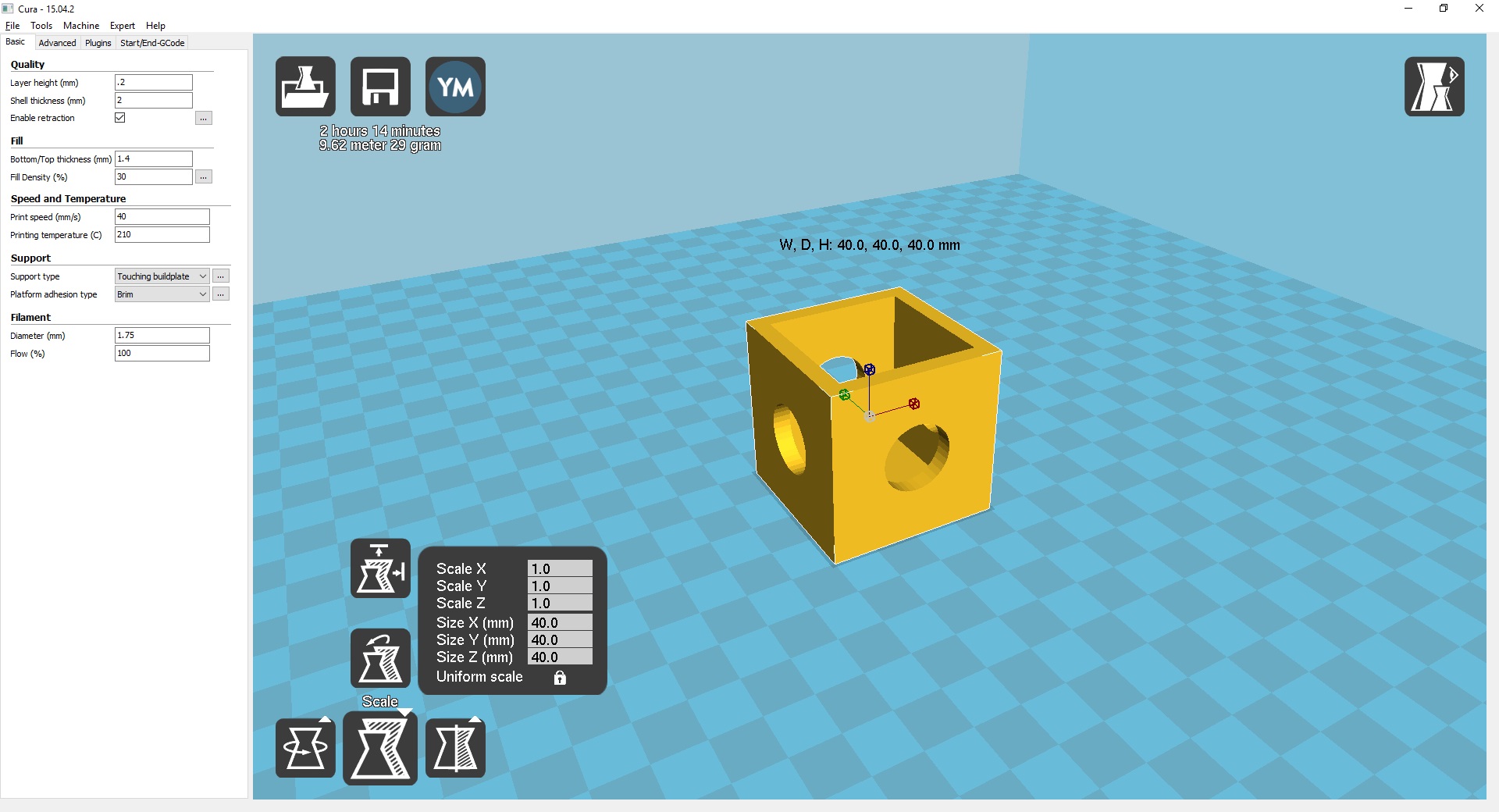

Make sure the print surface is super clean, use alcohol or acetone and wipe it to really clean. Make sure the first layer height is correct, to get the best adhesion you need to push the a filament into the bed a little. You can increase the bed temperature also to 75-80degC it will help with adhesion.Also to cooling is critical with small prints and PLA. Make sure the print cooling fan(s) are not on full speed in the beginning of the print so they should switch on around 0.4-0.5mm Z heights (it can be configured in the slicer).
Check also extruder, that its not extruding too much plastic. Just order the printer to extrude 100mm filament mark with a pen the filament and check if its really moved 100mm. You can tweak this setting also with FLOW value in the slicer.
There is also an option called Z-HOP in the slicer witch will raise the print head during movement so it will not collide with the print even there are some raised edges.

Hi Tamas, I am interested in your suggestions, I need some clarification. I am using Cura software I think the settings are different from your’s. I see a setting for flow in %. I have mine set at 100% There is a printing speed setting that I did lower from 50mm/s to 40mm/s. Is that too slow is that what you mean by extruding too much? Since it prints slower it will leave more plastic no? My printing temperature is set at 210 for PLA. I had quality set to 0.3, I’ve changed it to 0.2. For cooling I’m set at “minimal layer time of 5 sec”. I am using a bed temperature of 64DEGC. I have retraction set to combing off which is supposed to mean it retracts over holes. I doubled the size of the model I was concerned at the time I was having a problem with the print slipping after a couple of hours of printing. I think we’ve fixed that problem. I took some screen shots of my settings. Would you mind looking them over?
My plan is to clean the bed as you suggest and then lower the nozzle a little (That was Formbot’s suggestion) I was also going to raise the speed up to 50mm/s. That should decrease extrusion no? I like the bed temp of 64 DEGC. It seemed at one point I had raised it to 68 and the initial llayer showed more warping. I got the impression it was too hot. Any help you can give I would surely appreciate.

The extruded filament is adjusted with the speed automatically, so it will not make a difference in the quantity of the amount extruded per movement if you change the speed.
By calibrating your extruder I mean this:
https://www.youtube.com/watch?v=YUPfBJz3I6Y 21
or
https://www.youtube.com/watch?v=w_Wb0i0-Qvo 10
The program the guy uses in the second video is pronterface: http://koti.kapsi.fi/~kliment/printrun/ 5
download the latest for your OS. Connect the printer with a USB to the PC start the program and set the correct COM port your printer electronics serial port is recognized at and port speed(usually 115k or 250k) on the top left and hit connect.
After checking the extruded length, you have the option configure this in Cura in the File - Machine settings page where you can enter the new Extruder steps value into (top-left corner) E-steps per 1mm filament box.
This will be your new 100%-flow value. The flow values percent is modifying this value basically so you don’t have to change this step/mm value setting just decrease on increase the FLOW in the Cura setting page.

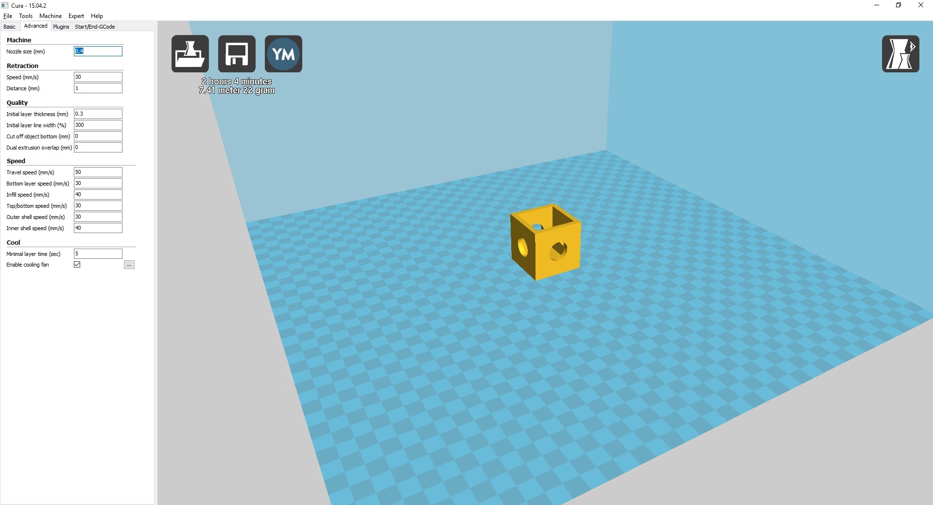

You missed the advanced tab and uploaded the basic tab twice, no problem.
I suggest:
Layer height: 0.2
Shell thickness: its the multiply of the nozzle diameter so for a 0.4 nozzle 1.2 if you have 0.5 nozzle 1 or 1.5.
Bottom top thickens: 1mm should be enough.
On the expert setting:
Enable combing set it to ALL
Z-hop: set it 0.1 or 0.2 so this will raise the head when moving the print head to prevent collision with printed object.
Brim line amount: 6 should be enough no need for 20 lines.
The rest should be fine for now.
I would also suggest to use a different type/manufacture filament to check if it makes better adhesion.

I attached my advanced settings tab, sorry about that I should have checked. Getting older, I need to double check myself. Tonight I’ll look into the calibration software.

First:
There is one big mistake in this configuration: Initial layer line width % is 300 !!! so it means for the first layer you try to extrude 3X times the amount of filament. Please set it back to 100.
Also the initial layer thickens(first layer height) I recommend 0.2mm.
You retraction values should be tweaked a little : speed to 50mm/s and distance to 4mm.
