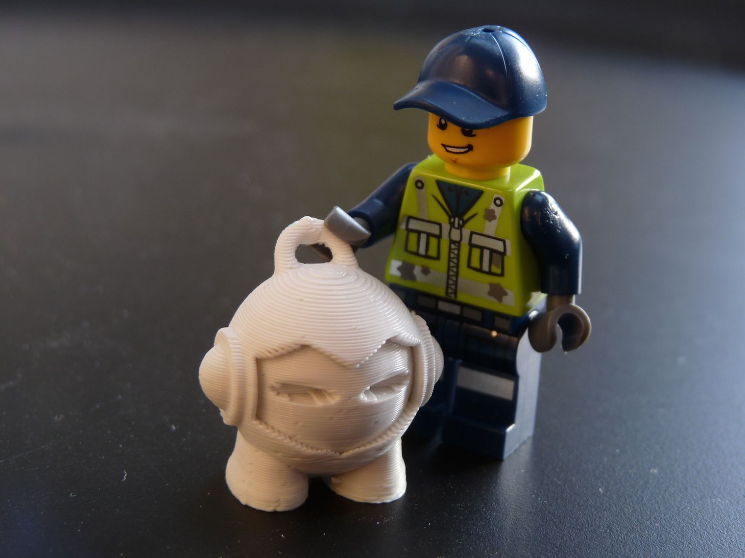

A bit like myself marvins abs and rear are not very toned when I try and print him, the upper half is all fine though, the legs are fine, I wondered if it might be a support issue, has anyone come across this before please. I’m also trying to print him in different areas of the plate to see if its a heat near the bottom thing, its ABS and on an up mini, any help appreciated. Thanks
What kind of filament brand do you use? I did a few Marvin with white ABS from UP! Premium filament and it worked well (see picture on my hub page). I read a few times that other filament brands can be difficult to print on the UP Mini due to high printing temperature for UP! Premium filament. And the parameters setup on the UP Mini are fixed!

I was seeing this very thing on my FFCP and played around with many different settings. The problem I noticed was warping. The previous layer warped up and interfered with the current layer and marvin’s butt just looked flat. I also noticed the same problem under the ears and, to some extent, in the eyes as well.
The changes I made that helped the most are as follows (listed from least improvement to greatest):
1. Slowed down the print speed.
2. decreased the print temp as much as possible.
3. installed an active cooling fan (I am not sure if this is an option on your machine).

The problem with the Up is the software was designed to work with support so it does a poor job with bridging because it doesn’t know to print a little faster/cooler when bridging. Your biggest issue here is being too hot for your filament. If you search the Up forums there is a software hack to allow you to lower the printing temp. Alternately, if you prefer a hardware solution you can build my hardware mod for under $10 http://www.thingiverse.com/thing:528396
Once you have a temp mod you can print with or without support just like it is Up genuine filament.
While you don’t have a temp mod having the fan door open (handle in the up position) will also help but usually I don’t like to print that way for ABS as it will make bigger things than Marvin warp. Also printing on Fast will help that bridging but you will need to the fan open because those layers may not cool fast enough otherwise.

It was the UP abs filament, 0.2, standard temp settings, minimum fill, support base only, with raft add support for 10 degrees or more 3 surface layers.

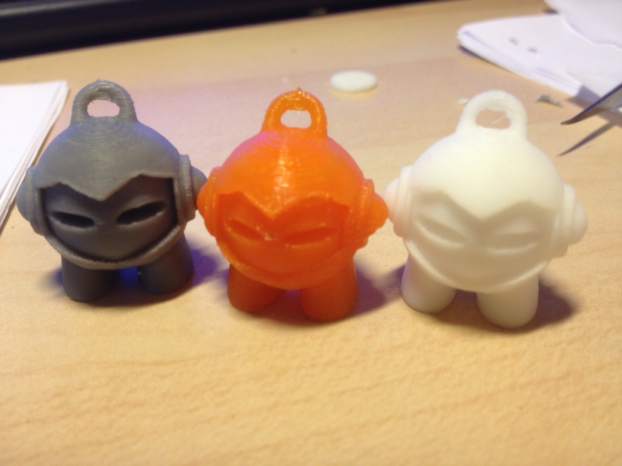

I have now run the OEM white Marv as uploaded lastnight and today the silver Marv with extra cooling and tweaking temperatures a bit, I’m really happy with them. I am as we speak printing off an orange PLA version again temperatures tweaked through the s/w mod and a bit of rapeseed oil with the filament load(I have read it keeps PLA sweet in the Up! box, I did have an initial bit of clunking when it started but not since on the 20min print in fine mode all fans)

well here is the orange PLA (faberdashery) the first one didn’t print too well using standard UP temperatures, I changed the print temp to 230, the under extruding problem seems to have gone now but its just not quite as sharp on the bottom of Marvs helpmeet, its the only place I notice it really, grey and white are ABS ,PLA orange in the middle, welcome any thoughts on sharpening up the edge of the helmet in the PLA
You should eb able to go lower on that temp - 230C is more an ABS temp. Faberdashery stuff is usually a better grade of PLA so it would be on the higher end, like 210C. Just listen for a jam towards the first few minutes so you can catch it early if it’s too low and save yourself having to clean out PLA dust form the jam.
Other than that, front and top open of course and a fan direct on the print (wind barrier fan is not enough). If you can’t direct it well on to the print insulate/screen your hotend and nozzle as best you can. Forcing the hotend to work harder can result in more heat working up in to the top of the extruder.
