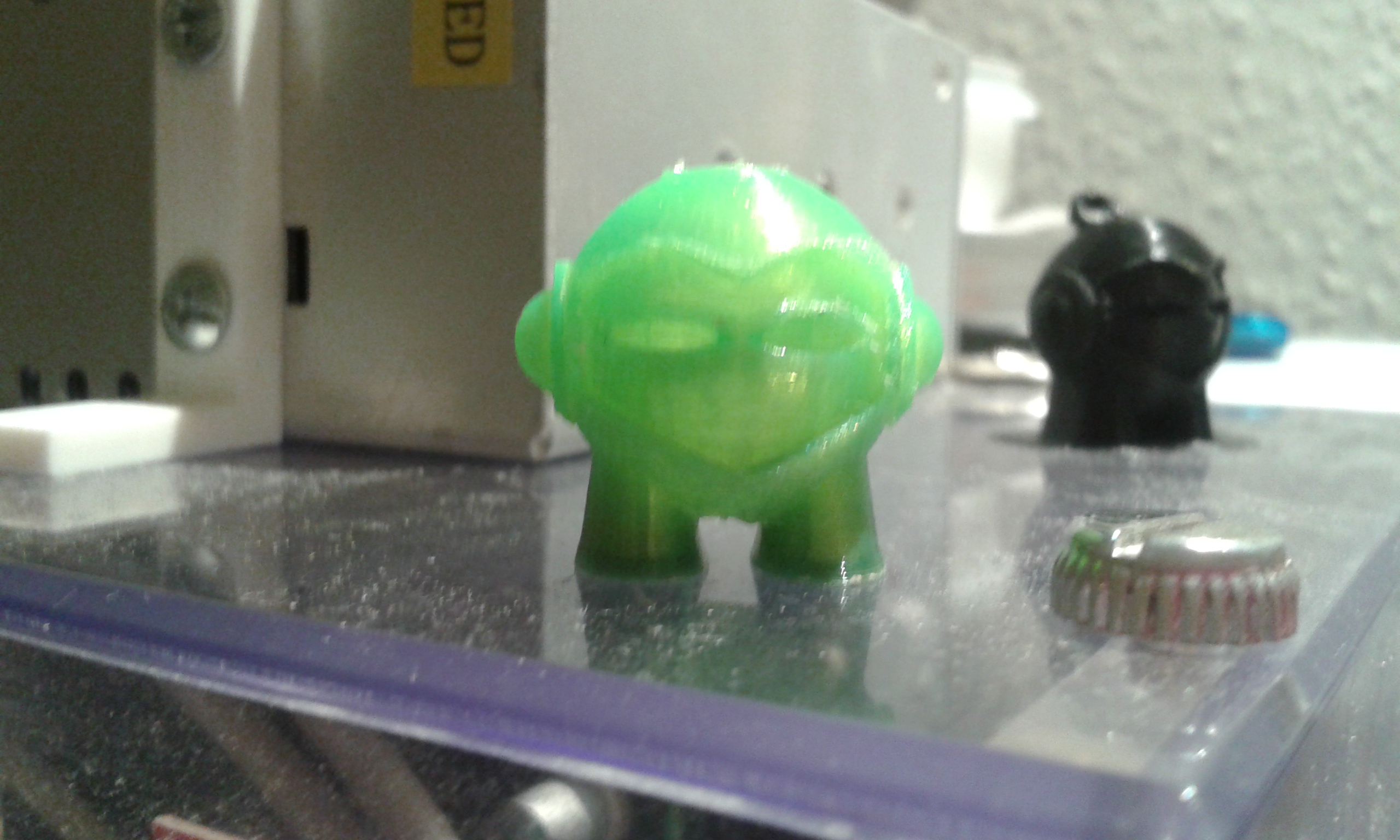

So just to get it right i have a 0.35 nozzle should i try to set extrusion width higher or lower?
or should i use flow tweak settings instead?
coasting… can you explain what that means so i can find the similar setting in kisslicer?
but so far i have upped each layer time to 15s
and upped temps by 5C… first layer 185 and the rest 180
bed temp is set to 60, if i go lower nothing sticks… mind you i’m printing directly on glass (ikea mirror)
what speed should i use? currently i have set X and Y to 250 mm/s… first layer 10mm/s and it adds 3 for each layer after the first one. accelleration is set to 2000 mm/s^2
If you use the 0.35mm nozzles you should increase the extrusion width to 0.38-0.40mm since the filament line will flatten out due to gravity. I have best results using 0.40mm width in the settings. Good luck, Marius
Coasting (a value set in mm) means, that the printer stops extruding for a certain length before going into a retraction. If you enable this you compensate the possible oozing when the printhead moves to another location. I have used 20mm/s as print speed and 10mm/s for the first layer. I also print on a glass plate and smear some glue stivk stick (solvent free) on the plate when it heats up. This creates a really good sticky surface, you might even need to use a knife or blade to remove the print. A small, barely visible layer of glue is all you need. Marius

upping temps by 5C and lower the speed just a tad helped a damm lot.
The face edge is now spot on and only have to get rid of some tiny strings in the hook part and some blobs on each side of the face…
i have been at a birthday all day and i did not have time to change filament before i went out so i only have it in black… have upped suck on destring to 2mm and will see what that gives me.

doing one in semi transparent green right now… even thou my hub is activated i want to get it right…
it was not so much the temp that did it, it was more the speed when doing the perimeters… suck was also not the thing (i tried going from 1 to 2 mm and it only made it worse.
this time i have lowered the temps again but upped suck to 1.1mm and lowered the speed a bit more
Please make some pictures, even if Marvin isn’t finished it might be helpful and some pictures of the final print are required so that I can help you further.
the black marvin is almost the same settings… except the extra suck that ruined the hook
Can you explain what exactly the “such”-feature does?
it “sucks” back the filament…
it can also be called retraction… not sure why kisslicer uses that wording
Does it only pull back the filament or does it also push out the same length at the end of a “retraction”-move ? On such a small print it should not compensate oozing by using extra restart distance (that means that you pull 2mm in and push for example 1,8mm out to compensate 0,2mm oozing in the nozzle). The extra restart distance in this example would be -0,2mm because 2,0mm + extra restart distance (-0,2mm) = 1,8mm
Please look up the settings and adjust the settings so that the printer does not compensate oozing. Did you adjust the extrusion length (if possible for your printer) ?
