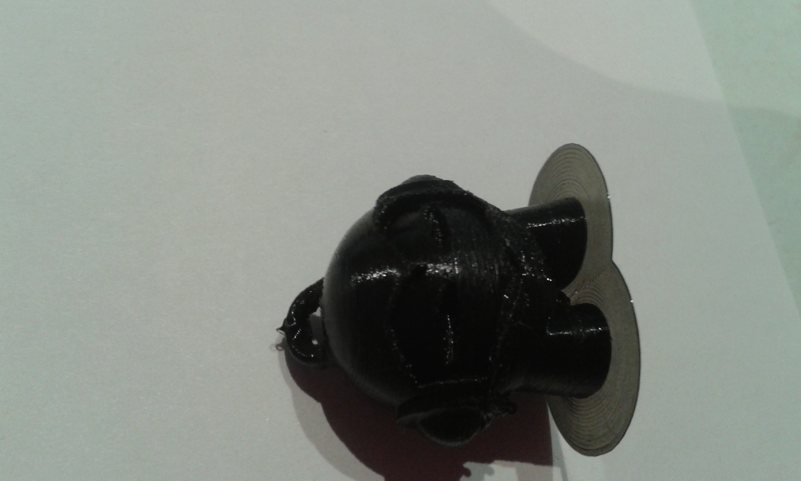

upping temps by 5C and lower the speed just a tad helped a damm lot.
The face edge is now spot on and only have to get rid of some tiny strings in the hook part and some blobs on each side of the face…
i have been at a birthday all day and i did not have time to change filament before i went out so i only have it in black… have upped suck on destring to 2mm and will see what that gives me.

doing one in semi transparent green right now… even thou my hub is activated i want to get it right…
it was not so much the temp that did it, it was more the speed when doing the perimeters… suck was also not the thing (i tried going from 1 to 2 mm and it only made it worse.
this time i have lowered the temps again but upped suck to 1.1mm and lowered the speed a bit more
Please make some pictures, even if Marvin isn’t finished it might be helpful and some pictures of the final print are required so that I can help you further.
the black marvin is almost the same settings… except the extra suck that ruined the hook

Does it only pull back the filament or does it also push out the same length at the end of a “retraction”-move ? On such a small print it should not compensate oozing by using extra restart distance (that means that you pull 2mm in and push for example 1,8mm out to compensate 0,2mm oozing in the nozzle). The extra restart distance in this example would be -0,2mm because 2,0mm + extra restart distance (-0,2mm) = 1,8mm
Please look up the settings and adjust the settings so that the printer does not compensate oozing. Did you adjust the extrusion length (if possible for your printer) ?

it has seperate settings for retraction and prime… and yes on such a small print its not needed and can end in a catastrophy
i trimmed the settings and its now working as it should

Did you make another print with those settings ? Another thing that might help and is pretty obvious is that you need a clean nozzle, if yours is full of filament blobs etc. heat it up to ~150°C (depending on filament) and brush the extruder with a brass brush. I usually clean the nozzle and heater block while it is heating for the next printjob. Depending on the extruder you have you should be very carefull and use a soft brass brush, however this wouldnt clean up as fast
yep i printed with those settings and have not had any issues since…
about the nozzle… yep i clean mine too, its easy to spot if blobs has formed… i just use a small nail scissor and gently scrape from from top to bottom where filament comes out… in many cases i aim to do this at 150 where all the filament comes off in one ball of “goo”
