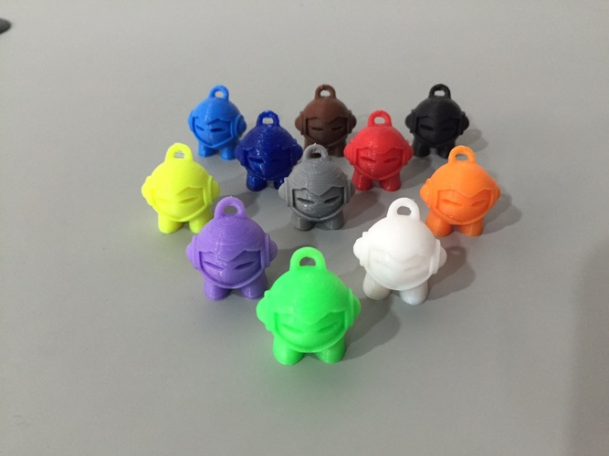

Designed it myself.
Try this settings for your marvin print:
Prep bed with Aqua net hairspray
Nozzle: 200°C
Heatbed: 55°C
Speed: 40 mm/s
No supports
Check that your Z offset is adecuate.
After printing the double fan mount check air volume, set fans to 75% first.
Edit your firmware, change overal acceleration to 300-500
Hope this helps!
Sergio R.
