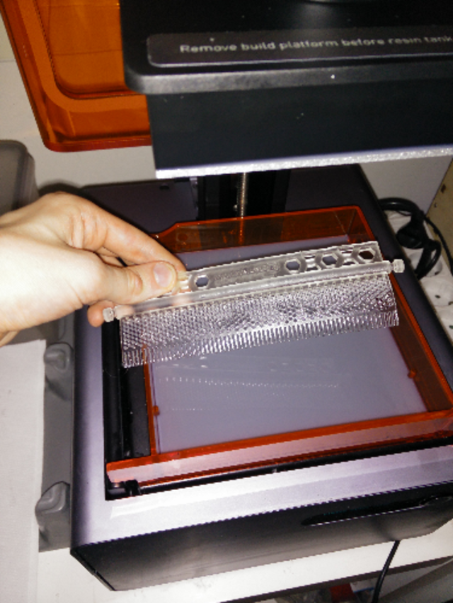

This must be the most unexpected, yet a such a obvious thing we could have done to start maintaining our Form 1 + resin tanks. If the print fails (which barely ever happens), it is always a struggle to remove all those parts from the tank.
@Alan_Nguyen pointed out an obvious solution - why not printing one of those Tank Combs for it. And apparently there was one already designed and placed on the Thingiverse.
We have just printed it with the Form one to clean the Form one and it works perfectly!
Just make sure to clean it afterwards for the holes not to get filled in. Since it’s made out of resin I guess cleaning it with alcohol is not the best idea - so I clean them with water. Any other ideas?
Make sure to share any of your tips in the comments bellow! :wink:

Cleaning it with alcohol should not be a problem. The resin is cured. The only real risk is not getting the uncured resin completely off it and catching little drops of alcohol in with the resin and then introducing the alcohol to the resin tank.
Another options would be to wipe the comb off as best you can and then set it out for the remaining wet resin to solidify in UV light. When it gets too clogged, toss it and use a new one.

I printed that comb and have a word of caution. I had used a regular comb before, it was cut to width and worked well. This one printed great on a replicator after I sliced the back flat. I could not get it to fit in my Form for printing. I went to use it with clear resin the way I had used the hair comb and moved it too quickly causing a wave to go over the top front edge of the tank.
The tank was on the machine because it had become stuck in place. There was no amount of prodding I could do to get the tank loose. I ended up sawing a tab off one side, removing the top, front and back covers, removing the 4 nuts that are spring mounted under the tray frame to finally get the tray and frame out. After pouring the resin out. I proceeded to use the metal spreader and an exacto knife to break the surfaces between the plastic tray and metal frame. It was covered with semi cured resin. To do a thorough cleaning job I bought denatured alcohol to soak the metal frame in. It turned out part of the problem getting the tank out is that the spring loaded ball bearings in the metal frame had become stuck and would not move any longer. That got fixed.
As a preventative measure I applied some silicone lubricant to the ball bearings and will no longer be leaving my tank of clear resin in the printer for extended periods of time.

Let the comb dry after (a short) IPA bath.
Yes, uncured+IPA in the resin tank will be a bad mix.
