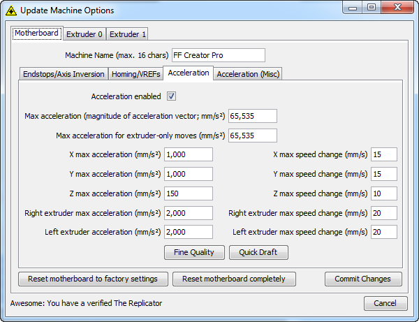

I am going to post a pic from RepG of the acceleration page and see what you guys think and advise!
I see a button for “fine print” and it seem to change only the first two items “max acceleration” settings down to 2000.
I would be ok with going in the direction of “fine print” settings as long as it doesn’t bring the overall speed to a crawl!!

Looks like “max speed change” is the equivalent of “jerk” on marlin but I would defer to @perry_1 on this because he has more experience with the specific firmware/software you are using.
