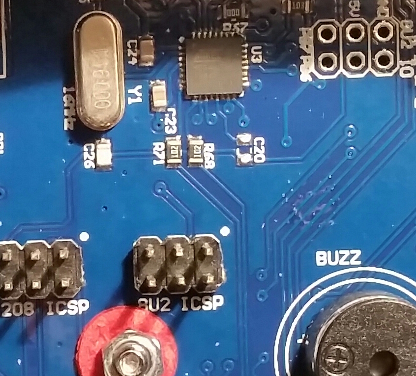

Flashing can be fiddly and it’s very dependent on timing which is quite likely what your issue is. There were, a few years ago, some boards which came without the arduino bootloader and those are not serial flashable from replicatorG. That’s unlikely though so first, check some things:
1. Verify your USB connection really is working - can you connect to the printer from makerbot desktop, replicatorg or whatever host software you’re using? If not, you may have some driver issues that you need to resolve.
2. Verify that your reset button works. Bear in mind it’s recessed quite a lot and you’ll need something that can push it firmly. Pressing the result button successfully (don’t try and flash right now) will reboot the printer, and you’ll see on the LCD that that is happening, so you can verify and satisfy yourself that the reset button works.
If (1) and (2) are good, then you really ought to be able to flash. For me, what worked was to press the button on the PC to start the flash, and then IMMEDIATELY (i.e. within less than a second) press the reset button on the printer.
There isn’t really any feedback to let you know it’s working, apart from the LEDs on the board near the USB port will flicker a lot more than normal. Flash takes probably a minute or so, from memory.

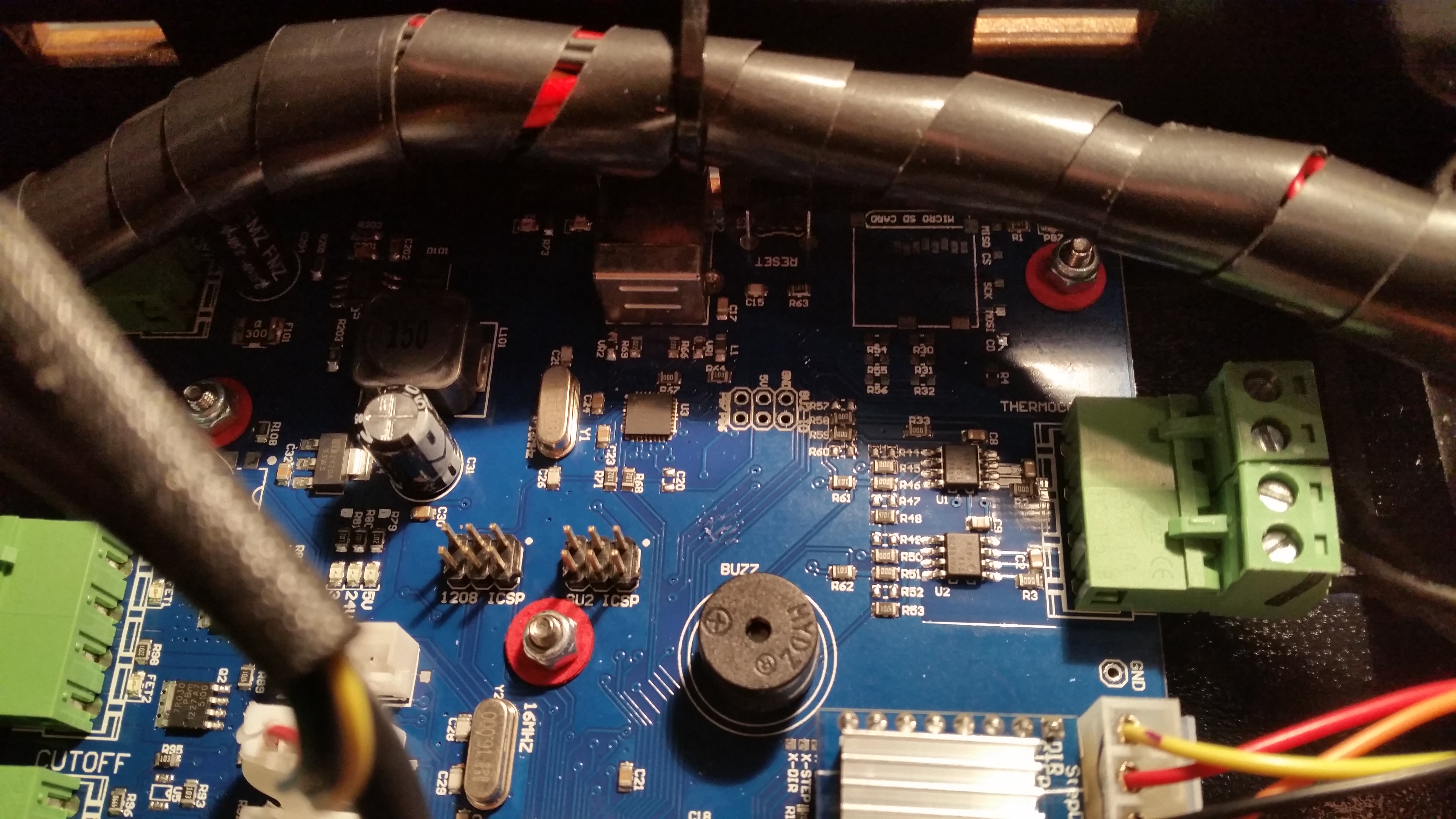

If you really really can’t do it, or if your board really doens’t have the arduino bootloader, there is, of course, another way - that doesn’t involve soldering.
There are two ICSP ports on the mightyboard. One is for programming the 8U2 micro that handles usb comminications (ignore this one) and the other is marked 1280 ISP - that’s for the main microcontroller.
If you get yourself an AVR programmer (e.g. tinyisp, see ebay) then you can plug it in to the ICSP port and then use arduino ide (or avrdude) to flash the arduino bootloader, or you could skip the arduino bootloader and just flash sailfish itself.
Getting an ISP programmer is 1,000 times better an idea than trying to resolder the chip.

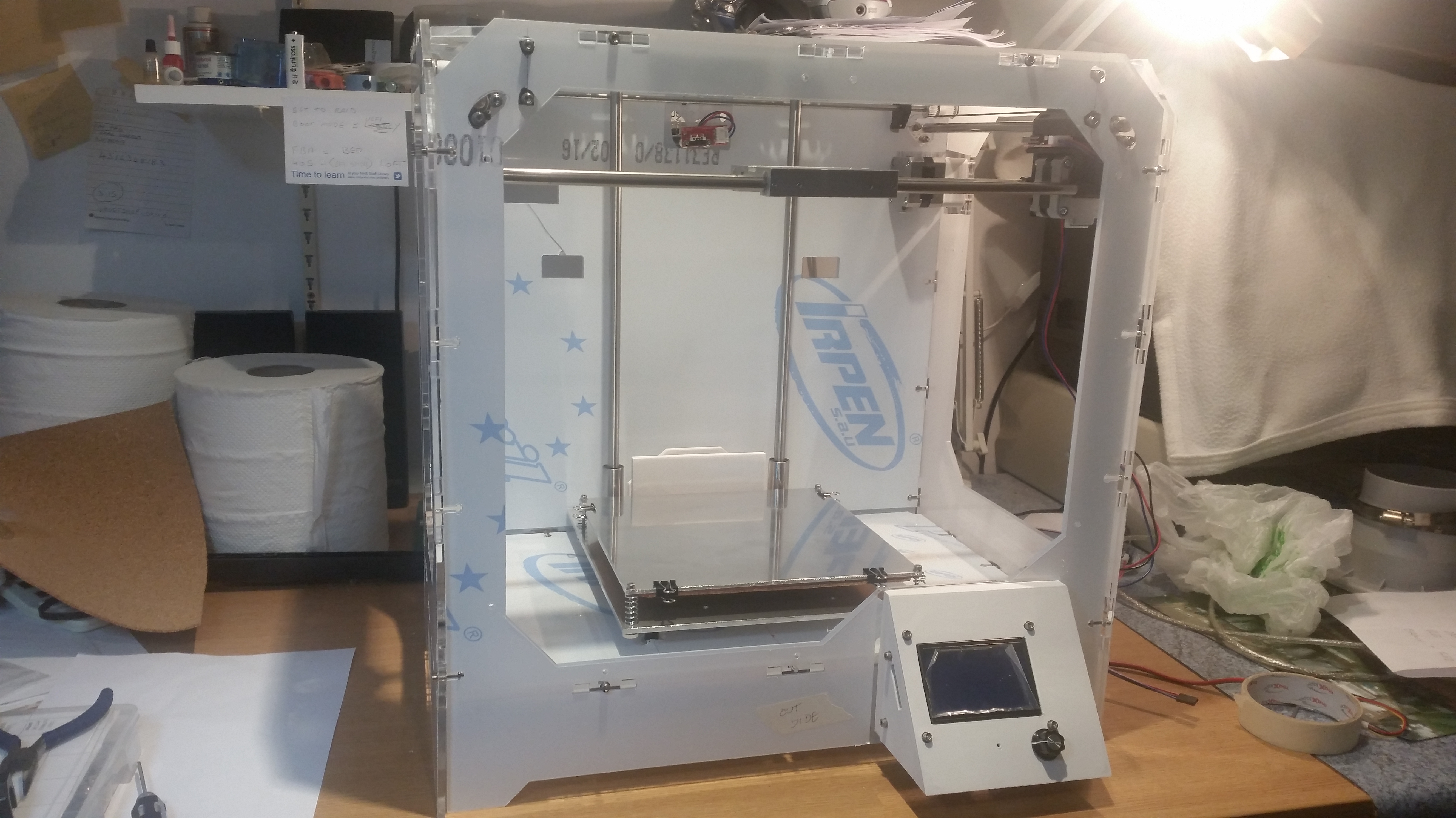

Sailfish is for mightyboards, not RAMPS. I think there has been some work in the past to get sailfish running with thermistors etc, tbh it’s a bit of a dead end and sailfish will never run that LCD (which looks like a reprapdiscount graphic controller)
Try marlin instead. There are a lot of guides out there on how to get marlin going. You’re going to have to get nitty gritty with build dimensions, steps per unit, endstops and stuff like that. But it will be better in the long run.
If you really need it, i can help you a bit (i run marlin on a ramps compatible board on my ctc now)
It 99 perent setup with marlin. All cogs are GT2 20 teeth. The z axis is a proper 8mm lead screw and not a 8mm threaded bar. Extruder is direct feed with 26 teeth (mk8 I think) on it. Line 752 #define DEFAULT_AXIS_STEPS_PER_UNIT {80,80,3000,2507.8982} don’t know if it’s right? Ian
Any help you can offer would be much appreciated.
I also want the extruder fan to come on when the extruder gets to a set temp, fan is wired to the 2nd extruder and only come’s on ver sliccer or menu/on board controller

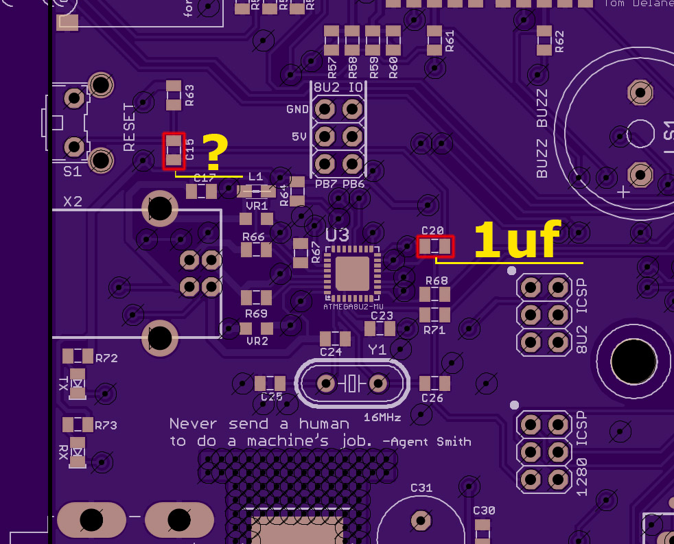

no but there is a Trace that gose to a chip leg if you look the thing is i was looking for I was looking for tutorials on updating me printer and i found someome on redit saying the reset button time is bad and 6 hours is two long and someone sed put a cap on c20 and the timimg has no issues press 1 time to flash trying fine out if anyone has done it
