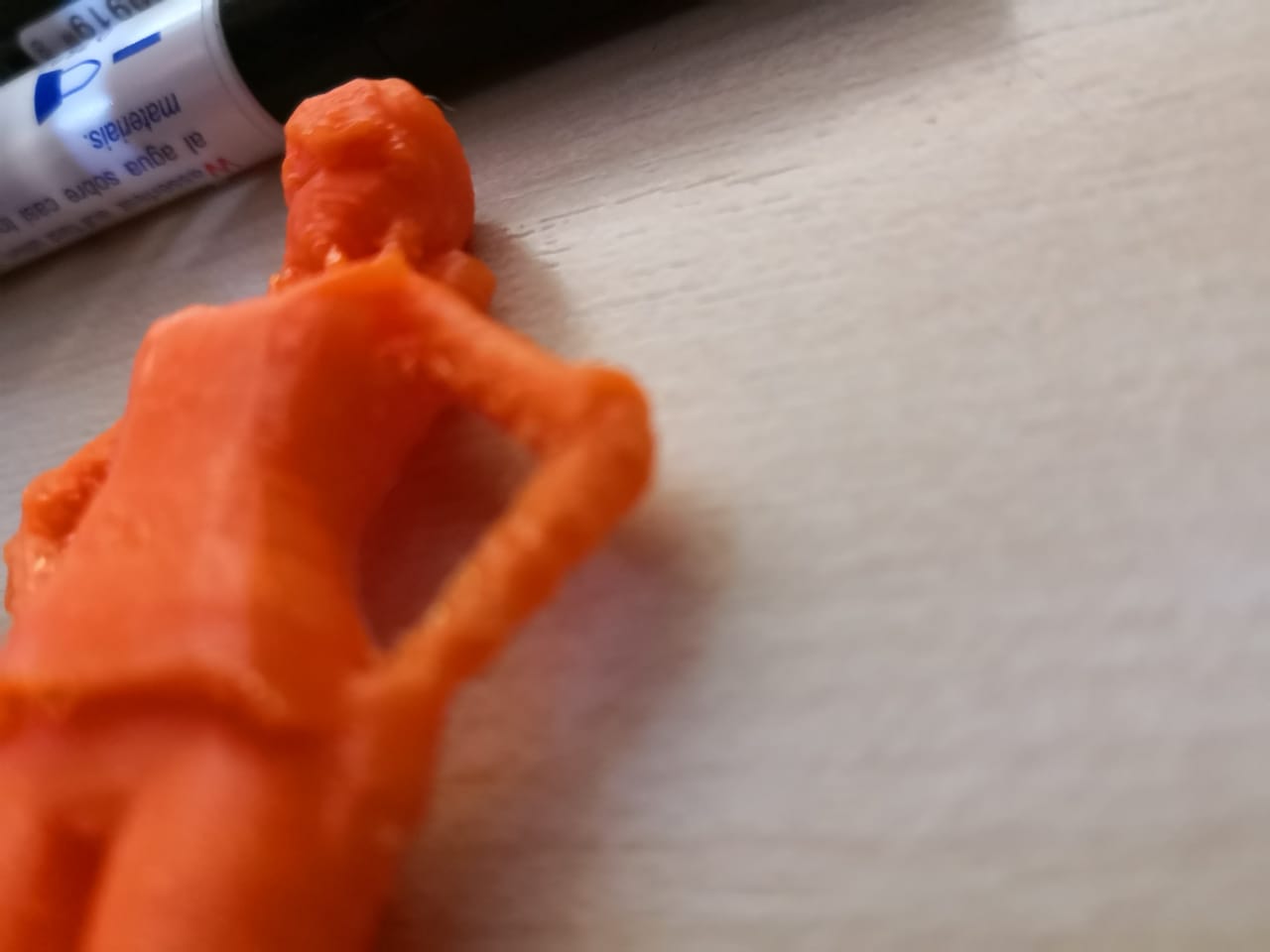

I bought a creatbot D600 last week, and I have a really hard time to make it work properly. I humbly require your help to resolve this mystery.
-The problem : As I do with every new printer I get, I try to print the 3Dbenchy 20, in PLA, with a 1.75 mm filament, and a 0.4 mm nozzle.
-The main issue is : at one moment during each print, the filament gets stuck in the nozzle, resulting in a quick underextrusion then no extrusion at all (pic n°1). When I remove the filament from the extruder, I can see it is gnawed by the filament feeder (pic n°2).

The two biggest problems are that the filament, especially the SILK, after a few minutes clog the nozzle.
What I could notice is that on the side of the wheel the filament is bitten and on the side of the nozzle it is thickened as if it had a drop (the filament is 1.75mm, it is the only option that they had in my country). In large pieces it is very rare that I can finish without being covered which is very annoying, since if I was waiting for 7 or 8 hours … then throw everything because the nozzle plug is exasperating.
The second problem is that the surface has problems, the vertical angles are ill-defined, for a moment it is shrunken, for moment they drip outwards, also the upper layer has a very bad termination, there are lines below and above the expected surface lvl.
Typer, with your config, but with 20mm/s and 2mm for retraction (i have 1.75 filament) calibration cube prints ok. Good definition, good size… but then ill try to print a bigger model. And clog again 5 times… in total print of 4hs… i stay at side of machine, and didnt figure whats happening… I also read a post that you use DX setup in S3d… do you change any value to make it work? or simpy change x y z parameters?
Thank in advance.

I think the issue is mostly the 1.75 mm because I believe the Creatbot was really desinged for 3mm. Are you sure the Bowden tube is the right size of 1.75 mm?
Do you get a clogged nozzle also if you use no retraction at all?
Thanks Typer your help guide to me to resolve the issue.
The problem its that machine works with 3mm at factory defaults, but local provider set to 1.75mm… they didnt say to me that, and when you talk about it… i use m503 command to see all parameters, and se it says M200 D3… I search for M200 (im new in 3d print) and Marlin wiki says its filament diammeter… correct it and can print my first model ok… now i need to do some minor changes, silk pla at 210 º its to much… maybe 200 or 190… and i need to improve retraction again…
