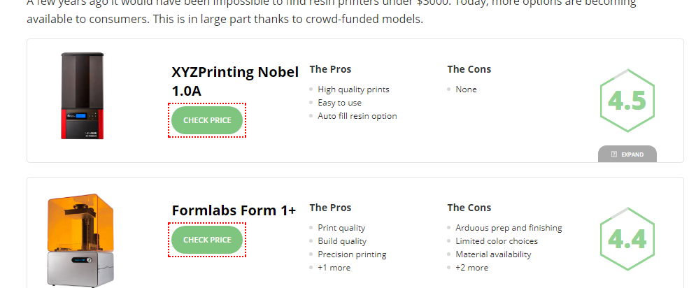

Some of the SLA printers are
SLA/DLP 3D Printers Under $3,000

I think its for XYZ Nobel 1.0 A which seems to accept only the cartrige made by the company. Wont accept 3rd party as each container has got a chip, so each container can only be used once. Dont know… may be its for other printer… (right now its mostly PRINTER overload) will check on it later and confirm
