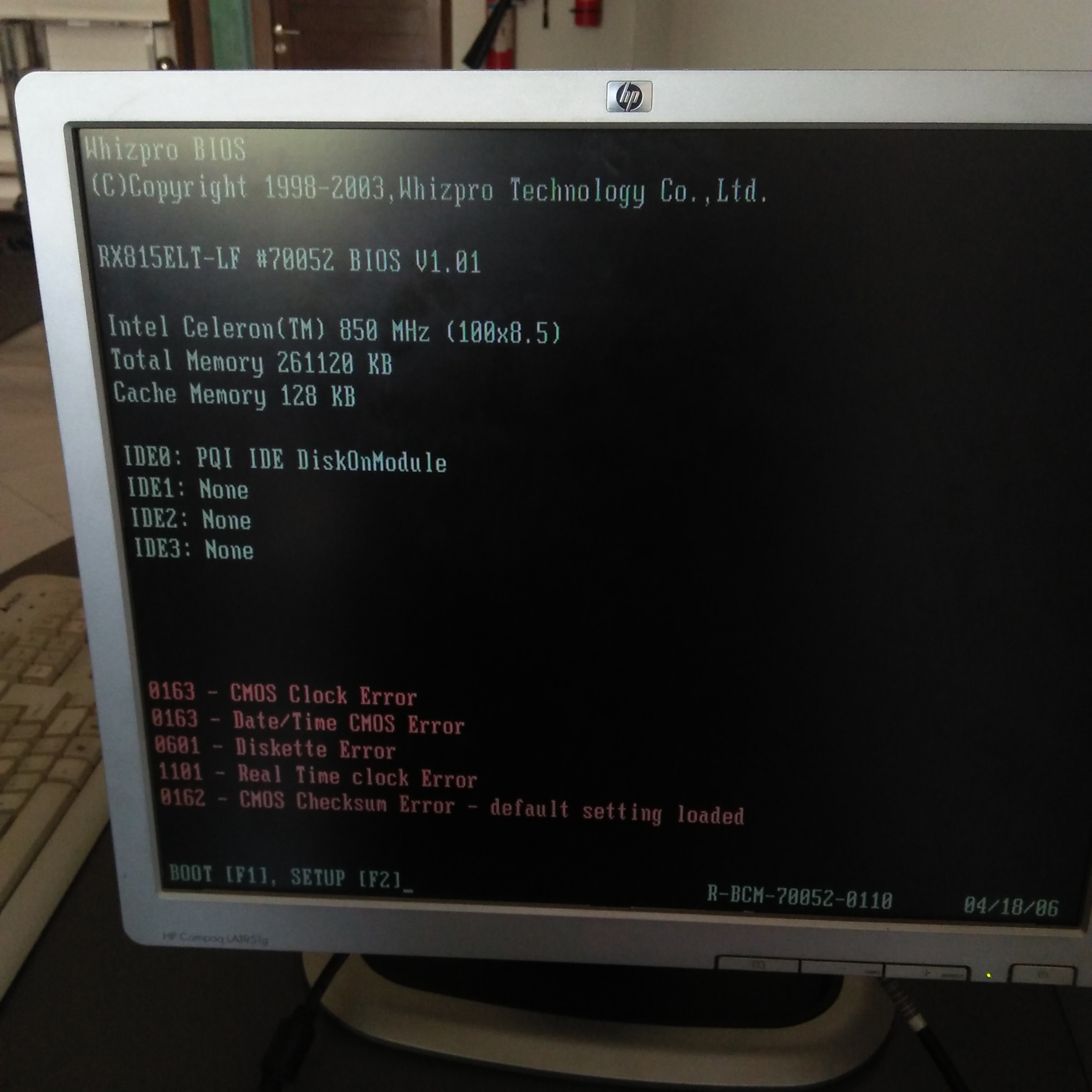

Hi!!
I’ve z510 for long time and I give some break using the printer. Now I’ve started it and LCD shows only the welcome note “high quality 3D printer”. Printer isn’t working and not even responding to keys.it would be great if anyone suggest what can be the issue?

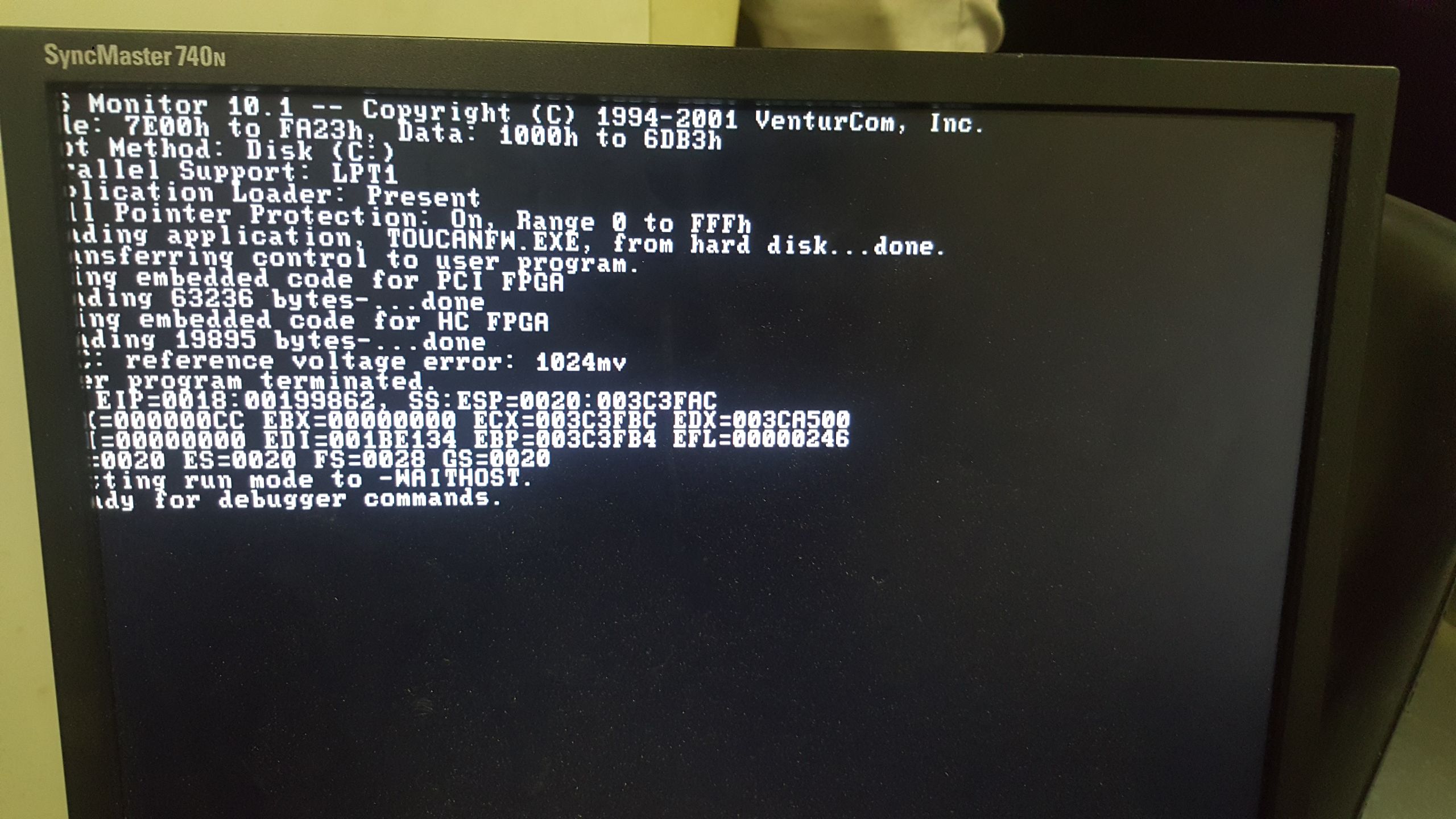

Plug in PS2 keybord and VGA plug monitor at the back to see what is going on. First thought stuck on BIOS setting or the BIOS battery is down.
Thank you for help.
What should appear on monitor when I connect it in vga plug? Am I supposed to give input through keyboard? If yes then how?
Like I wrote, you will se the BIOS starting up (normal like in every PC), if you are familiar with PC you will find on the screen some info. Probably BIOS battery dead. Just plug the monitor and PS2 keyboard and you will see.
Typical, I as mentioned the BIOS battery is dead. You must replace the battery on the motherboard. Diskette error will probably does not matter in booting but can be switched off in BIOS setup.

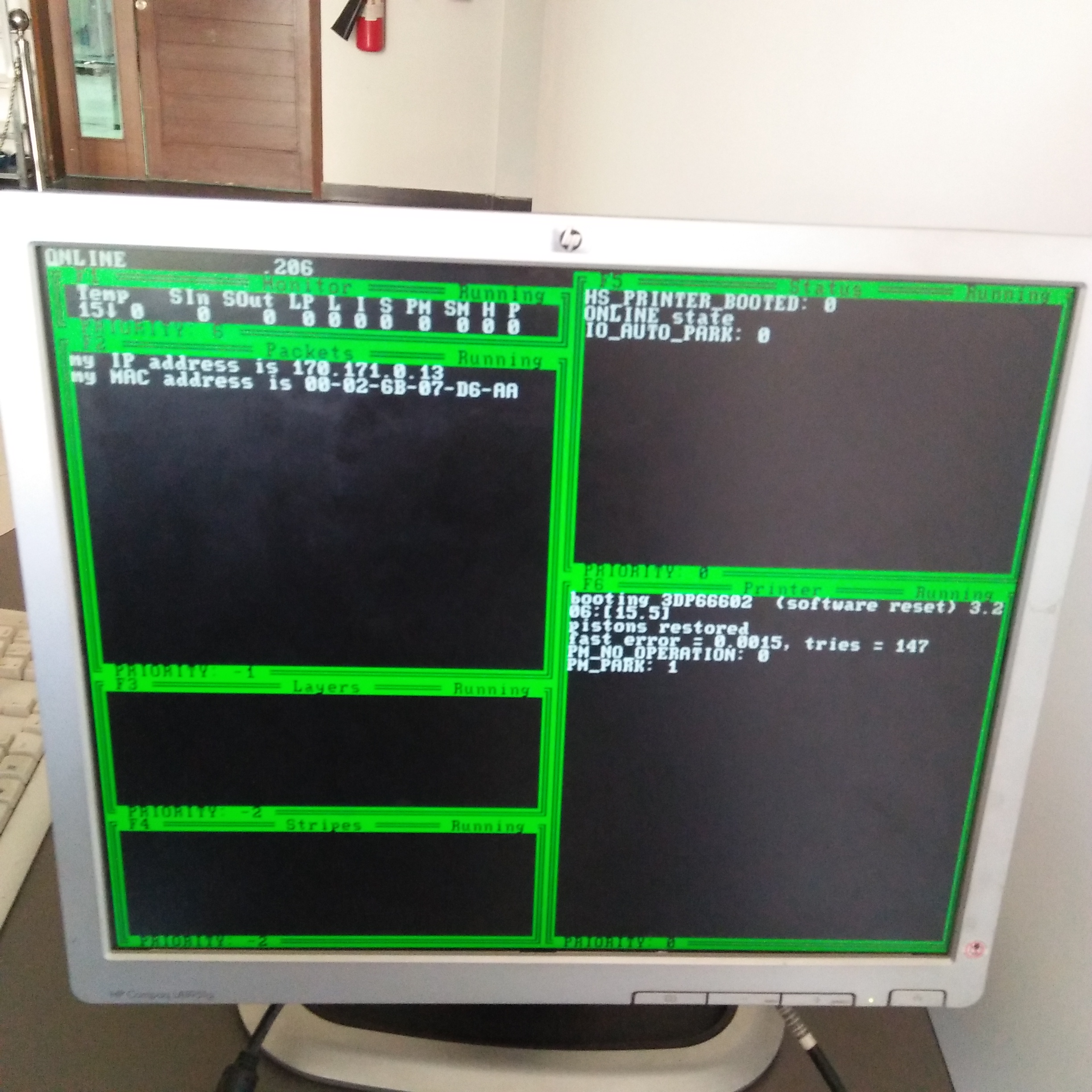

The other photo shows online state and normal operation I think so this means you can print. If you need any cheap quality binders for the printer send me a message.
