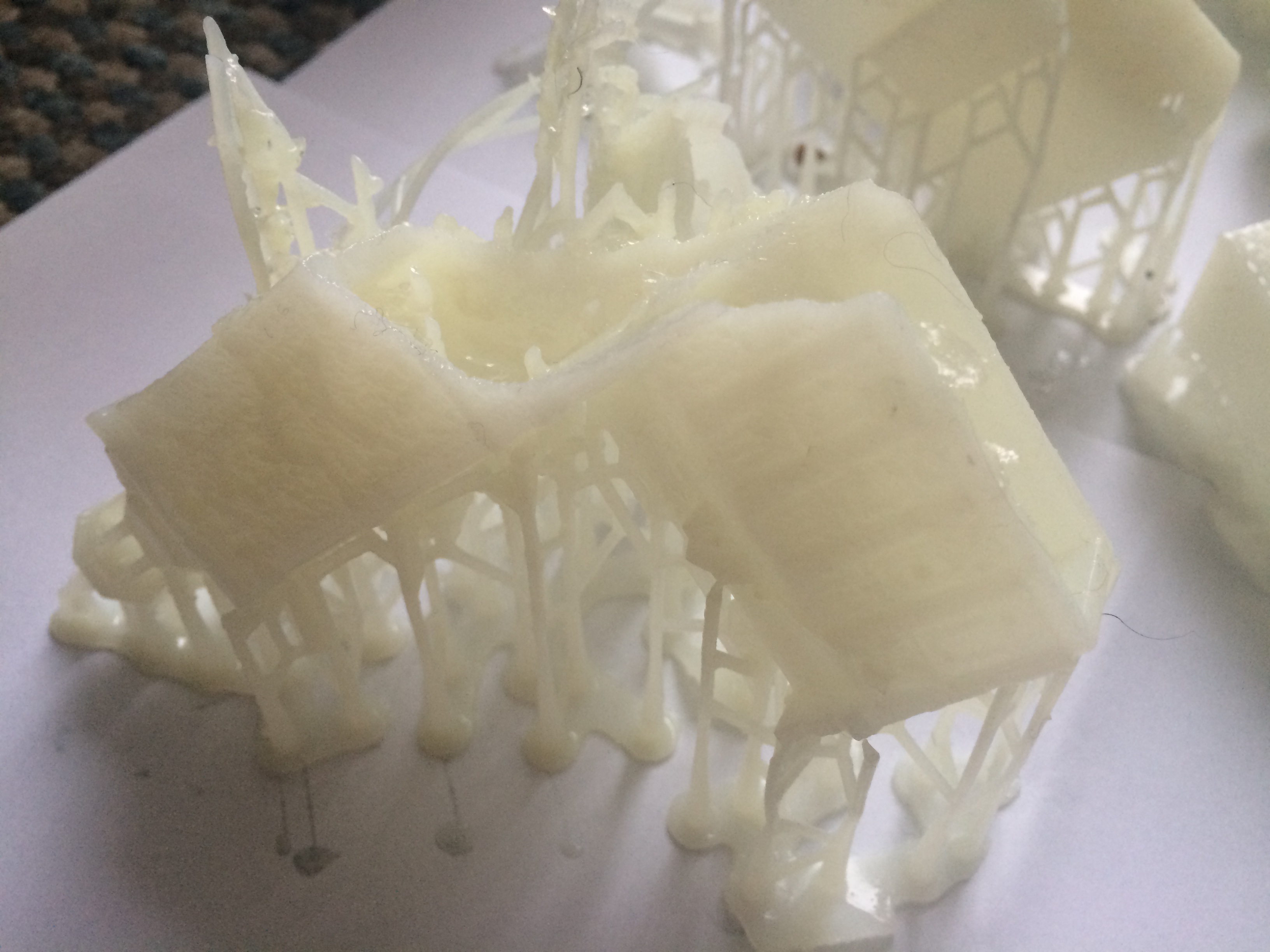

I do not recomend Fromlabs printers. I bought Form 1+ in July last year. First prints were awsome, but after few months it print worse then cheap FDM printer. Simply terrible. Stops in the middle of print, blistering, wholes etc. See pictures below.(should be architecture). I read formlabs forum and a lot of people have the same problems. At the beginning super quality after few prints really terible - especially bigger prints, which sometimes are impossibile to print without failure.
That product has simply bad design and catch a lot of dust from outside, which is impossible to clean after without disassebling. Warraty say - when you open you lose it .
It happend in December, i still didnt get new product or money back. Support want me to open printer by myself, there are not normal service just online. They dont take responsibility for thier products.
Really worst purchase ever.

I see… sorry for that. In the new Form2 they should have solved that problem making the laser chamber sealed. I was oriented toward the Solus DLP Printer
I have taken apart my form1+ twice, per their instructions for mirror cleaning, they took the machine back for service, and then replaced the printer with a new one. I guess everybody has different results.
As for a sealed chamber, how would you dispense the heat generated by the laser other than air flow. I added a air filter to the outside of the air intake after the cleaning the mirrors twice, no issues since.
Additionally the Solus uses an external projector, so the air flow through the printer to dissipate heat is not an issue.
The biggest issue I have with the form1 is the print quality for jewelry. If you get away from the notion of it being a printer for fine jewelry, micro pave, and less than .8 mm detail work your fine. I have found for heavier jewelry, and making pieces to be molded with resins other than the Castable Blue. Your Golden.
I would like to work with someone to try resins other than Formlabs to print on the form1. I believe their biggest “Jewelry” fall back in the resin, not the machine. I can get exceptional 25 micron results with any of their resin other than their castable.
