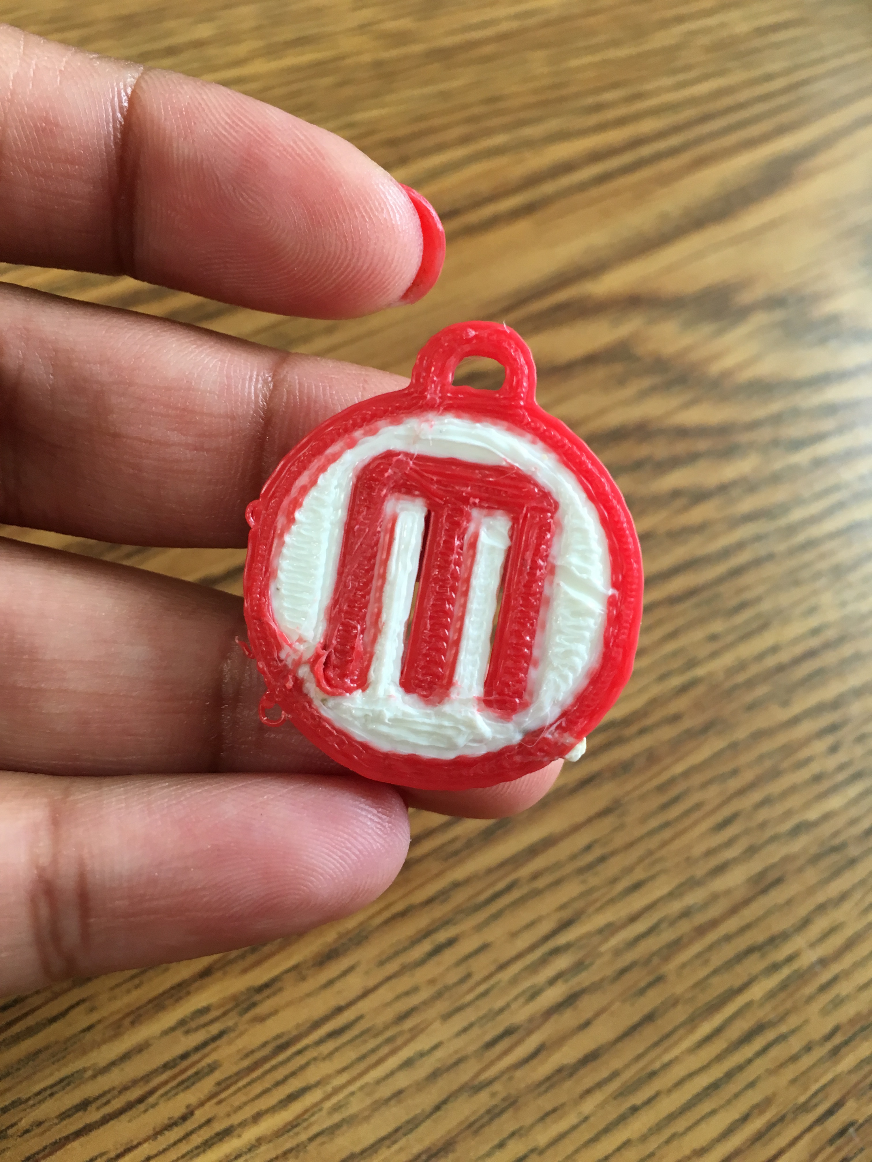

I’m brand new on the 3D printing scene and just got put in charge of my company’s new 3D printer (we basically drew straws…), a MakerBot 2X. We want to see if 3D printing will be useful for us for prototyping/making fixtures before we purchase more printers.
After having a huge number of issues, including a massive, unclearable clog in the thermal tube after only two prints, we got our replacement printer and I’m curious about how to improve the print quality that I’m getting so far. I suspect that the printing temp (230C for each extruder) might be too high, as I’m getting leakage from the idle extruder that gets stuck to the print as the extruder moves over it, but I’m not sure what the minimum printing temp for ABS (MakerBot brand) is. And I’m desperately trying to avoid a clogging situation, which may have resulted from a high temp, like last time.
I’m also getting a sort of rippled pattern on the surface of the print instead of smooth. I recently relieved the bed to give the nozzles a little more distance from the bed, but is this surface texture a sign that they’re still too close? From what I’m seeing when watching the quick test prints I’ve done, this also seems to be a results of the filament leaking and clumping at the nozzle end and getting dragged across the print surface. so I’m not sure moving the nozzle even further from the print bed will help.

What settings did you want to see? The print in the picture is a test print that came off the Makerbot’s SD card; I didn’t adjust any print settings from factory defaults. I actually can’t adjust print settings unless I’m working with an original design in the Makerbot Desktop software before it goes to the SD card for printing. I just don’t like what I’m seeing so far with these test prints and am curious what I can change when I do have the option of adjusting the settings.

This is good if you are new to 3D printing. It means that you can practice diagnosing problems that you have. From looking at it the print my first thought would be the print speed may be to high. Try doing the print again and you should be able to slow the print down manually on the printer i would try 25% and see how that looks.
When diagnosing a problem you don’t really want to change to many settings at once.

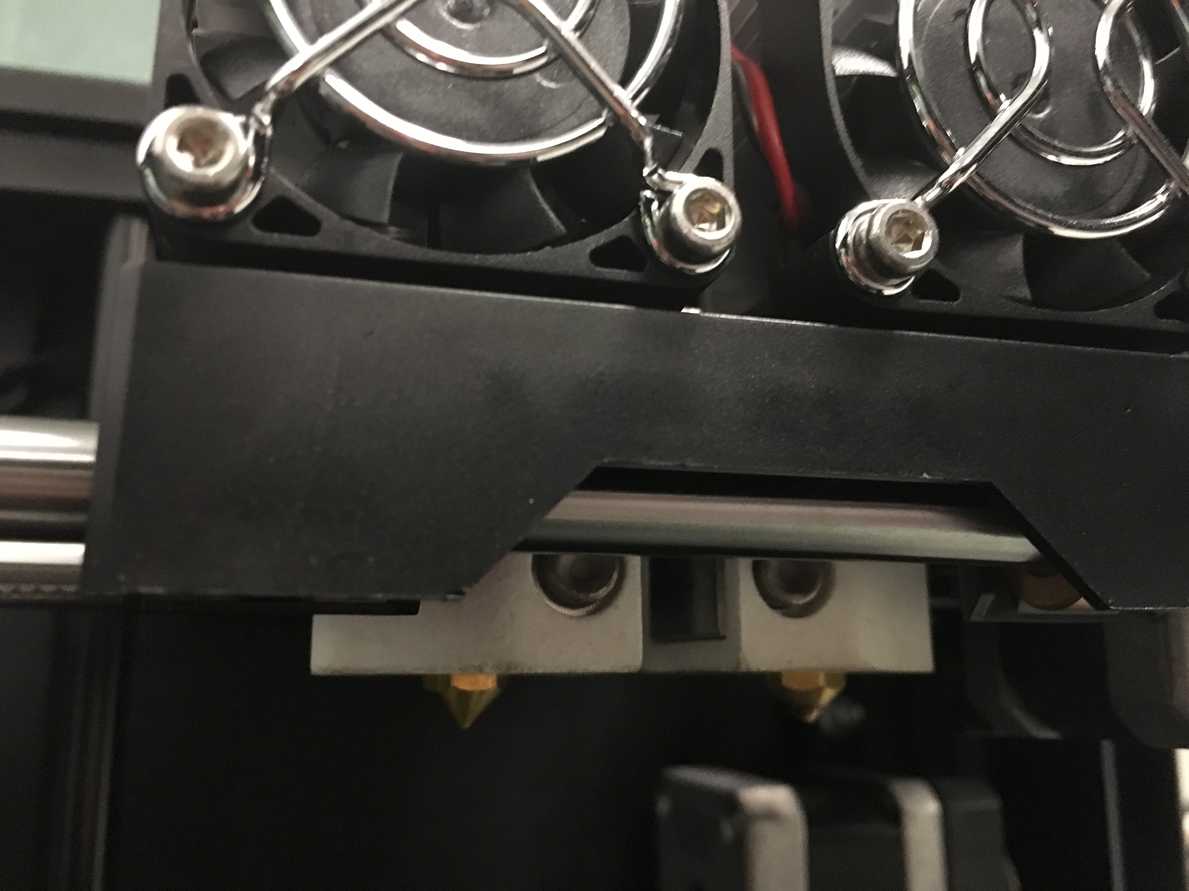

A very important question to ask is if your 2x has all the upgrades put out by Makerbot, can you send some pics of your extruder so I can see. Otherwise, using makerbot print would make things easier. Also, the 5th and 6th gen makerbots do PLA instead of abs but they’re much easier to use. (provided you have an extruder +)

do not use the test files to gauge your quality. The test files nearly work as they stand. Open MB desktop and upload your own small model with default settings and go from there. 230c is okay ABS do not go above 240.
I’ve been reading that 230C is within range for ABS, but is the filament leak from the nozzle head during preheat a sign that I should drop it a bit?
Yep, that looks good, you can remove the tubes and blow compressed air down the hole to clear any ground plastic, then I would say slow it down a little.
do
60mm/s shell printing
80mm/s infill
60mm/s first layer
Also, make sure to relevel!

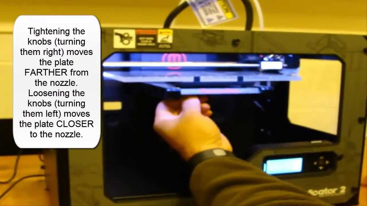

2. Does the filament leak out of the nozzle or between the nozzle and the heat-block?
3. Look at this video of leveling:
and also this video for leveling between nozzles:
Usually if it’s making blobs while printing then your nozzle is to far away from the bed…
Filament will almost always leak when at rest, you can drop the temp and see how it reacts but a little oozing filament is pretty much normal operation.
It’s not as much a big deal during preheat as it is during the actual print. The idle nozzle almost always has leaking filament that tends to clump and drag across the print surface with the nozzle (you can kind of see the drag marks on the coin).
1. I know that some of the prints we’re going to require will need dual extrusion, so I guess I’ll just stick with Makerbot Desktop.
2. It’s leaking out of the nozzle, not near the heat block. And the leaking happens with the IDLE nozzle, the one that shouldn’t be extruding any filament while the other nozzle extrudes. That’s when the resulting clumps drag across the print (getting stuck in it) and become a problem.
3. I’ll definitely relevel. I felt like it was pretty well leveled for the most recent test print, but it can’t hurt to try again. My tendency is too level with the nozzle too close to the printbed, so that’s what I’m usually wary of.
It’s normal to leak a little during heat up but generally it should go straight down, if your level is good the string or blob will come off when the print makes that initial priming line to get things started.
so what we’ve established so far:
1. Properly level the bed
2. Properly level the extruders between each other.
3. Maybe sllow it down a little.
