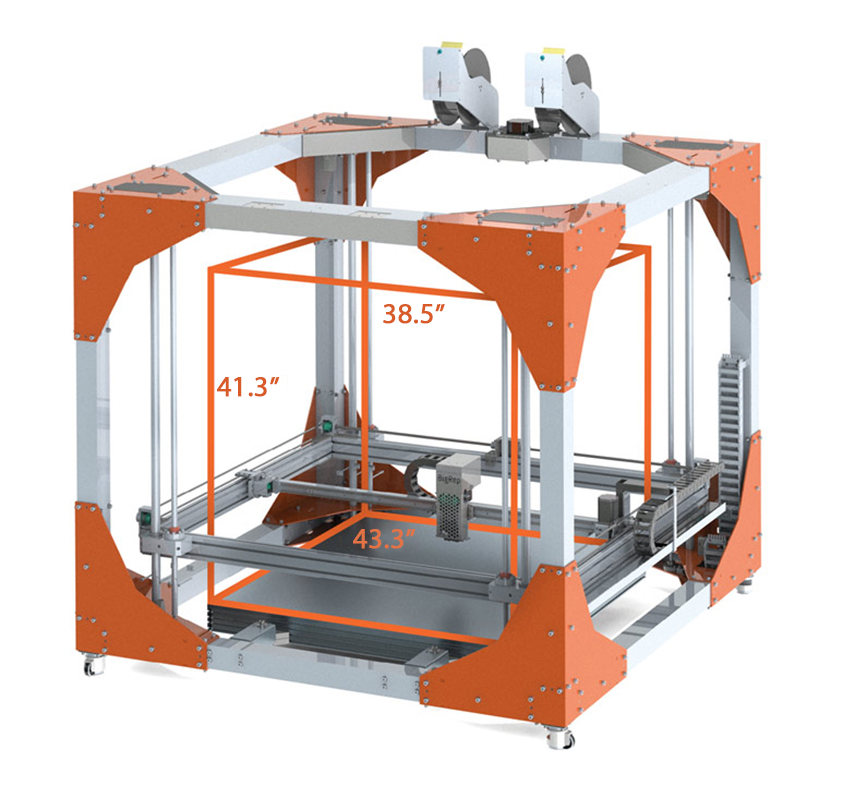

We here at Expose Yourself are exited to announce the arrival of our BigRep ONE.2 3D printer with a 1 m³ working volume (27 times the volume of a large desktop 3D printer). This opens a gateway to a new dimension in 3D printing and 3D manufacturing. There are virtually no limits to your creativity, from human scale robot parts to full-dimensional sculptural artworks, anything is possible.
The BigRep ONE.2 can print in PLA, ABS, Copolymere, Laywood, Laybrick, PC, PA, and TPE. We look forward to working with local makers and businesses to produce some of the most mind blowing 3D prints in the world!
I was wondering if anyone had any suggestions on any cool samples we can try to print on this beast.

Great! Lookig forward. Btw. What’s the nozzle size on this thing?
It actually has 2. The one installed on the left is a 1,0mm nozzle and on the right is a 0,5mm nozzle.
