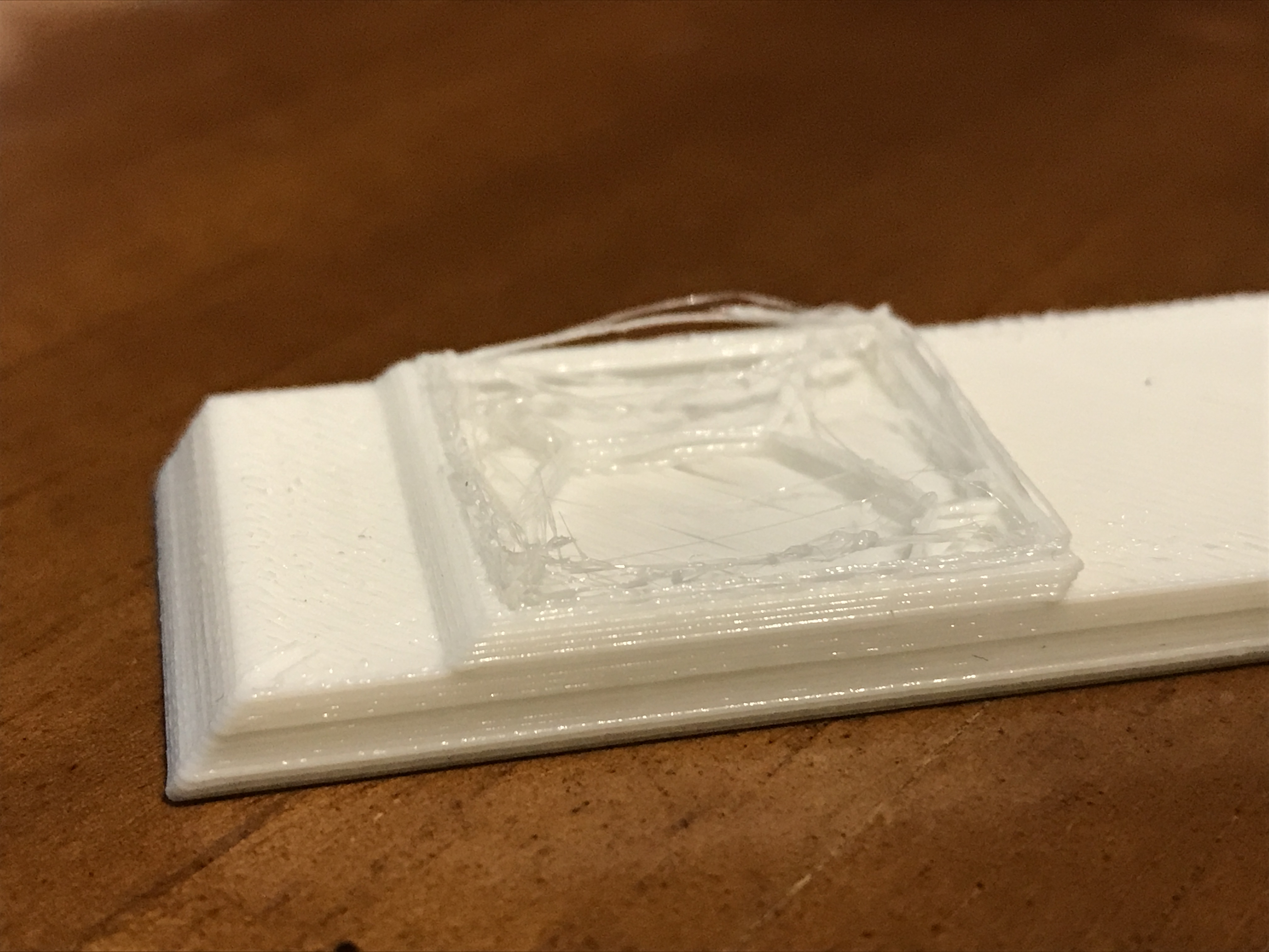

Ok I’m about to give up. It’s been several weeks that I’ve been trying to do a decent print but unfortunately my printer stops extruding the plastic after 15-20 mins of printing. I already replaced the nozzle several times, check the correct installation of the ventilation fan, check different printing settings, leveled the building plate. I think I’ve tried all now. Does anybody have an idea of what could be the problem??
In the pictures you can see how the extruding layers slowly disappear.

Sounds like heat creep- heat moving up the heat break and causing the filament to
expand and clog.
I had the same problem, it was because it is summer and I am in the garage at around 100 degrees F. I fixed it by pointing a floor fan into the printer and the prints finish now.
yeah like @Frantic says.
The thermal break tube did you replace it when you changed the nozzle? some times incorrect installation wear on the PTFE lining or using one that doesn’t have a thermal break in the threads has ptfe tube through the whole throat of the tube, or no ptfe in the tube at all will cause symptoms like you are describing.

This usually happens when the nozzle gets hot and somehow dissipates the heat into extrusion mechanism. Make sure feeder teeth doesn’t get hot, otherwise it skips. Turn off the fan and try to print very slowly with lowest temp (like 180C for PLA at 10mm/s), give it a try and see what happens. If it happens after like an hour later then that’s it. You need better isolation.

when was the last time you cleaned the feeder ? sometimes the filament can grind and leave residue in the teeth. This caused the motor to slip on the filament and grind your filament.

What material are you using? Always happen to the same height and with the same piece?
Once I was printing a piece in abs and at certain height the impression was suspended; The strange thing is that it always happened at the same height.
After trying everything, I realized that the piece had a thin wall at that point and due to the machine trying to make it, it performed constantly retractions that ending up on a bearing eating the filament.
Try several things:
1. Suspend retractions. The piece might look terrible but you will try if that is the problem.
2. slow the print speed or increase the minimum duration of the layer, in the Makerbot software
3.If it is a mechanical problem, adjust the bearing pressure
4. In this link Print Quality Guide | Simplify3D Software 129, check the “Stops Extruding Mid Print” information, you might find it usefull
