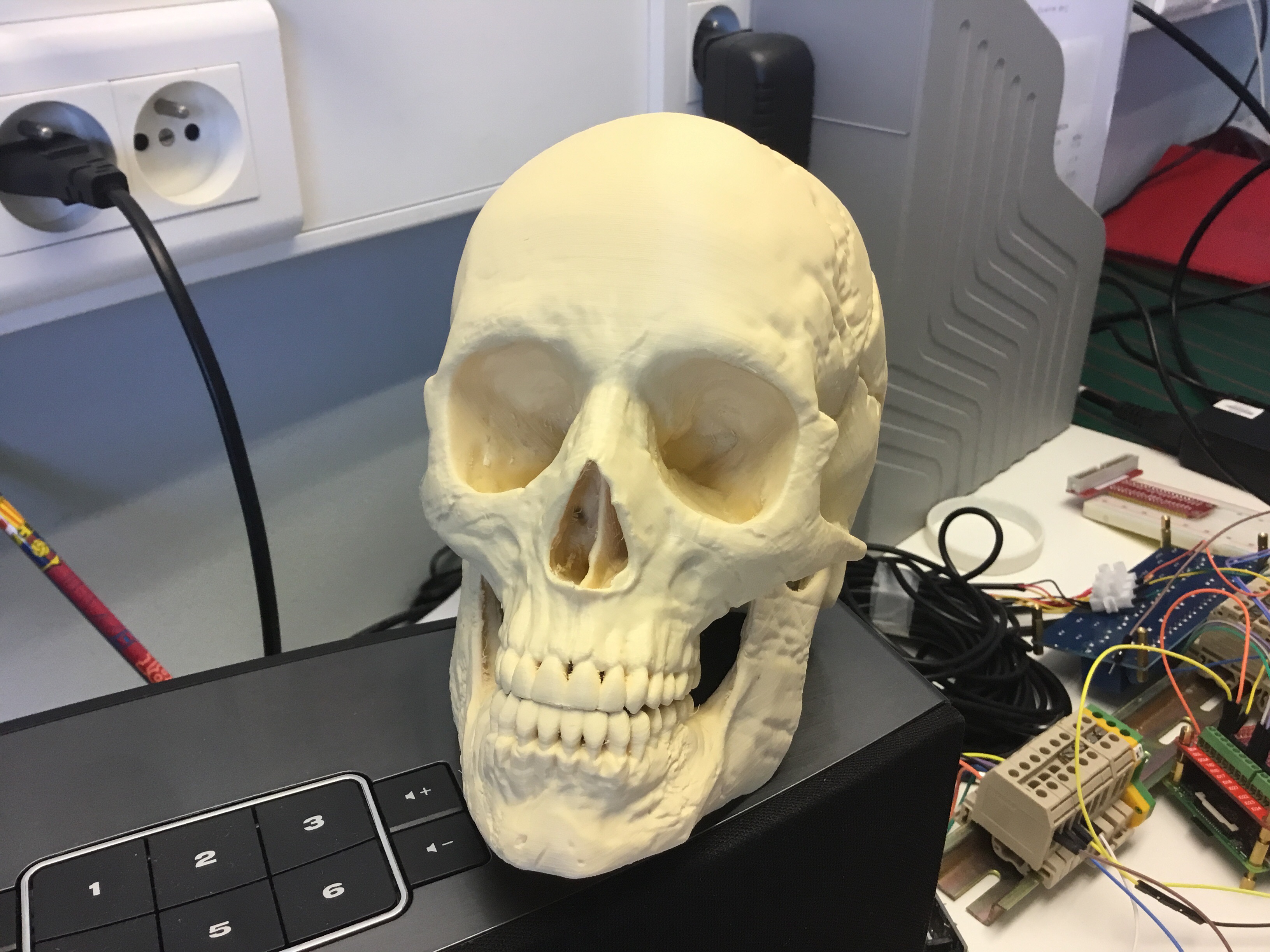

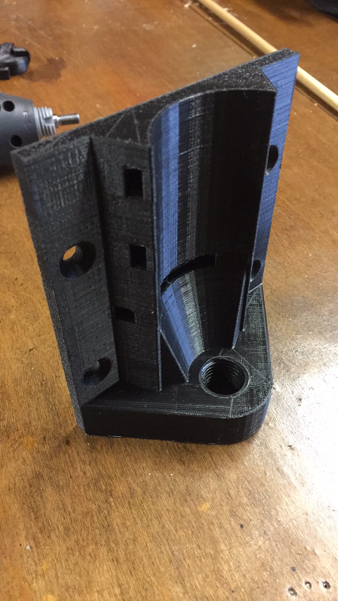

Sounds good, @Soren_Beiler, thanks for sharing! I’m not really familiar with this printer - would you be able to share some prints/ projects? it would be nice to see what it’s capable of :wink:
Here ya go
That is good to hear that you got a good unit. Based on the review by Richard Horne, the unit itself seemed terrible in the review.
I just got done watching that video, and I can say, that my machine’s quality seems better than the one he has. I found that video a bit jaded, but I havn’t has issues with customer service. I am printing parts currently, and have has minimal issues. Using their flavor of slicer, their firmware. Only issue is usb control but from what I have researched on the web, that seems to be somewhat a thing.
