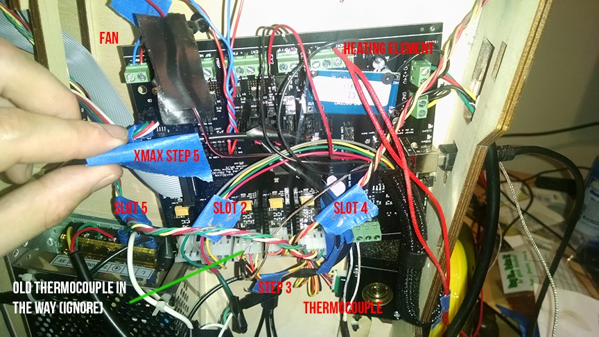

Wow! Thank you everyone for the responses!
SUCCESS!!! I have reversed the *thermocouple the wires, and the printer now heats up! It goes to 215C like i set it and now holds.
Onto the NEXT ISSUE…I cannot get my makerbot to do anything else really. It doesn’t go to home axis, doesn’t load filament (even though after the temperature goes up to 215c and the screen changes to say “press the m when the loading is done”), doesn’t move in jog mode, and so on and so forth. Could this be the case of my wiring being wrong again?
I originally labeled all the wires with tape and marker before I removed my original wires from the original board. I referred to an image I took of all these wires in place, and I replaced them based on my image. I guess I assumed that putting the wires in the same spots on the same model mightyboard would be a common sense thing. Guessing may not be the answer on my end, seeing as it has gotten me to basically cross my wires! haha
See attached image
Its hard to tell from that picture but it appears that your stepper motors are all plugged in, follow the wires and just make sure the motors are plugged in right, the board is labeled, X, Y, Z for the steppers. X is the motor that moves the carriage left and right, the Y is the motor that moves it front to back and the Z is of course the bed going up and down.
Also if none of the jogs move it could be your stop switches, try moving it so the carriage is in the middle and then you know the switches are released and see if you can move it with the jog. You could also have the stop switches plugged in wrong depending on which style of connector yours has, seems like the earlier Rep 1 some had a keyed connector some didn’t, you could unplug all the stop switches and then see if jog works, but that wouldn’t stop the filament feed motor from running.
One more thing comes to mind, did the board come with the stepper drivers installed? The little circuit boards that are plugged into the motherboard by the stepper motor connections? If you had to install those and none of the motors are working you could have them put in backwards, but if they came pre-installed on the board then they should be correct.
EDIT>>> I just looked at the pic again, none of your stepper drivers are installed, the sockets are empty! Theres your problem.
