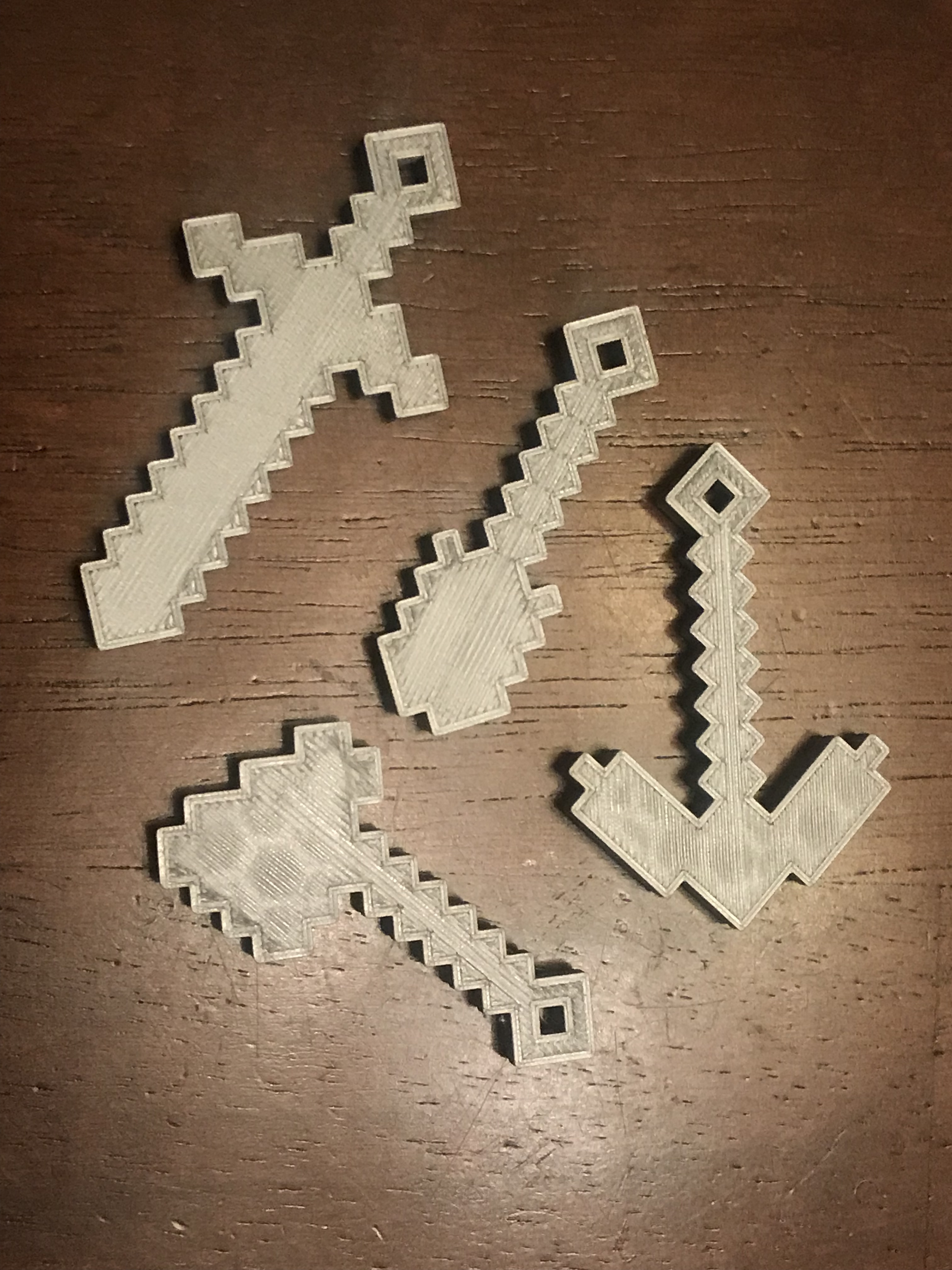

Finally made it back to post an update. I got the original fan replaced with one I ordered from Amazon. The prints were SO much better afterwards. In the process, I’ve learned even more about why that fan is there, when it is set to come on, and the importance of it. That explains why every time I tried to print before (with the fan not working), that I had stuck filament because it kept melting high up in the extruder from all the heat.
I need to figure out what settings to play with to adjust for better prints, but overall I’m pretty pleased so far. I also need to do some research on using just the glass bed with aqua net hairspray, as that seems like it may be a better route to take.
Here are a few prints I made after replacing the fan. The minecraft items turned out pretty well. The other piece had to print with supports and a raft. It’s the main piece for a xbox one thumb racing wheel attachment for my sons xbox one controller (attaches over the exist controller to make a mini steering wheel). There is a bit of stringy-ness to it, which I presume is from the temperature being a little high maybe? I really have to go back through all the settings one at a time and see what I need to adjust. I basically started all over again with my slicer settings after I replaced the fan.
Looks good.
