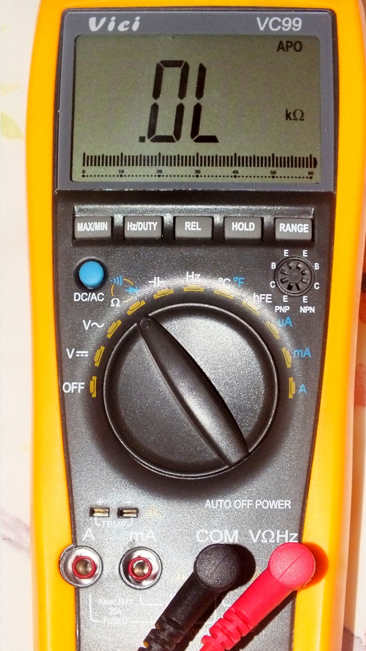

My Meter has`nt a 100k range so took readings set at 200k
Then borrowed another meter so I will give two sets of readings one from each as I am not familiar with meter reading I have attached photos of both types of meter as well as settings used.
First meter Vici set in kilohm range Reads as follows: (This is More of an auto reading meter also has a auto range but I set it to kilohms hope thats right!)
5v to Signal = 4.694K
Signal to Ground yellow wire = 0.518K
Signal to Ground green wire = 0.511K
Readings from second meter set at 200K as follows:
5V to Signal = 4.7
Signal to ground yellow wire = 00.5
Signal to ground green wire = 00.5
Not sure but both meters seem to agree I think!!!
HBT Disconnected from machine when readings taken.
Hope these are correct settings
Ignore display on meters just notice settings if that makes sence.
There you are then. Your NTC is either knackered, or the wrong sort. It should be around 100-120 K ohms at room temperature, and its reading 0.5k.

PS. Curiosity killing me! So Ive cut off the thermistor and taken a reading straight from the component legs Ive taken a picture of the result ??? Am I wrong or is that near 100K?

Just for you to ponder Last night after removing the thermistor I re-took meter readings from the HBT this time without the thermistor fitted! So open at all four tabs both for old and new thermistor positions results are:-
5v to Signal = 4.964
Signal to ground yellow wire = 0.498
Signal to ground green wire = 0.497
I used probe clips on the meter this time as to not have any influence from my body, I noticed that at first the readings for:-
Signal to ground yellow and Signal to ground green took some time to settle as both at first produced fluctuating readings from the 0.550 range up to 0.950`s then back down again several times until finally settling at the figures above. Is that normal would have thought the readings would have been stable from the outset?

It could be the capacitor is faulty and has some resistance, or it could be a faulty PCB. It’s a bit hard to diagnose via a forum. Your HBP is definitely faulty though, I don’t suspect that the mightyboard is.
