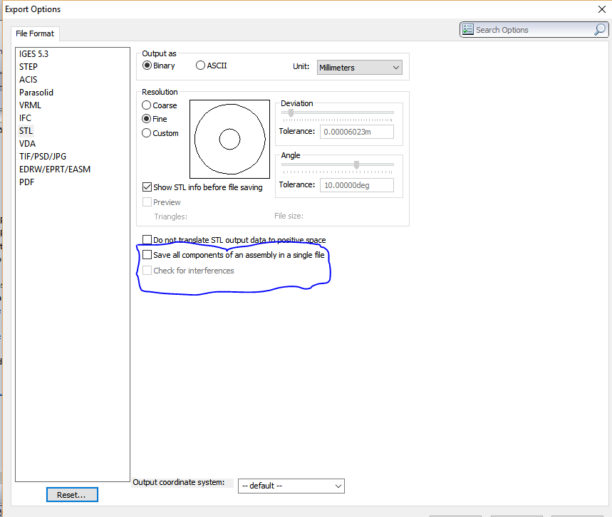

If you select the “Options” when you are “Saving As” STL File, you will see the option of Save all components of assembly in a single file. Hope this helps.
Yes there is! I do this all the time, and it’s a great help for 3D printing. In solidworks, go to Sabe as STL, and then select options. One of them will be to save a single part file or save is multi-part file. Hope that helps!
