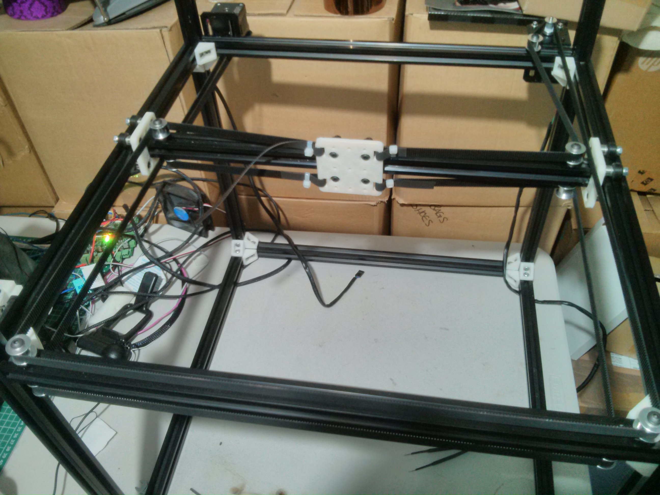

Hi all Just wanting to pick your collective brains. I’m building my own custom 3D printer it is a CoreXY design the CoreXY part I have all sorted and tested and I’m happy with that. I’m now doing the Z Axis, I was planning on supporting the Bed on all 4 corners (smooth-rod) Plus 2 Ballscrews on the sides at a central Point. however after finalising the design of the CoreXY stage I can no longer put the ballscrews at the sides as originally planned! so I’m now having to do a rethink I can either put one at the front and one at the back of the printer in the middle which will obstruct removing 3d printed parts from the front (but I can still access them from the side) or I could replace two opposite corners with ballscrews so that would be ballscrew then smooth-rod at the back and smooth-rod and ballscrew at the front or the last option is to just use one ballscrew at the back. what would you do ?

Hey … I’ve been watching those videos… My design is using 20mm v slot extrusions it’s basically a 500mm3 cube with an over and under belt config hence the inability to now use the sides as the belts run there. I should have a pic. (Found one) it’s just a quick build I’ll replace the plastic corner pieces with metal ones (waiting for those) when the printer mechanicals are finished I’ll be using 3/4mm acrylic on the sides and top/bottom this will give the printer a more professional finish whilst also providing strength/rigidity to the whole printer. Colin's CoreXY (V-Slot) by zx81 - Thingiverse 17 there’s more pics there and there should be one of the smooth-rod supports (I was originally going to use them for the coreXY stage but changed my mind)

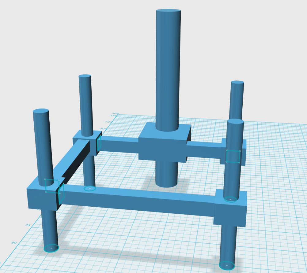

I understand what you mean however that’s not what I’m planning to do, there will be 4 rod’s and one ballscrew, the 4 rods one at each corner and the ballscrew in the back centre. originally I was going to do 2 ballscrews at the sides and use a closed loop GT2 belt to link both of them to one stepper motor, but that’s no longer possible because of the over and under belt system.
I’ve already mentioned I’ll be using 3/4mm acrylic on the sides and top and bottom
the 4 rods will have 4 SCU10UU bearing blocks. I’ve added a picture of a crude mockup

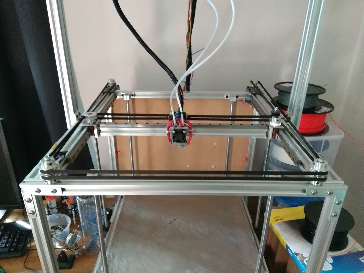

I’ve got a similar set up to your build, see pics. 10mm rods with 2 lead screws. I started with the short bearings you’re planning on but found with a 400x400 bed there was far too much play. I could tilt the bed side to side quite easily, and that was using screws on both sides. Longer (10LUU) bearings fixed this. With one screw at the back I think you’ll get binding of the front bearings and jerky z moves. Also with a single ballscrew the weight of your build plate may turn the z motor when it isn’t powered.

The other option I was considering was using 2 Rods and 2 Ballscrews at opposite corners I guess it’s something I’ll have to play around with … the 10LUU bearings I have dont seem to have much play in them at all but I’ll see how it goes once I get it assembled … just waiting for parts.
Thanks, it’s all good fun building these things. Going bigger is definitely a learning curve. Designs for smaller printers don’t necessarily scale up very well. Have you sourced a print bed yet?
