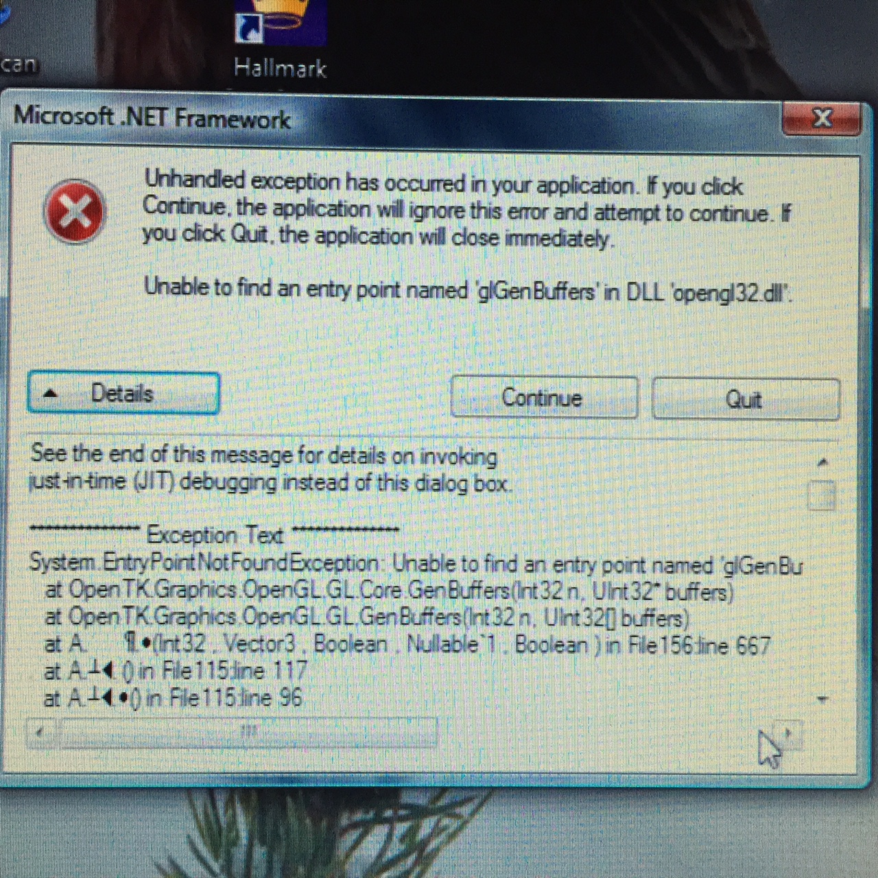

Back with another question / issue. I’ve been running ZSuite on my MAC, and it’s been buggy. I understand that’s just the case with the MAC version of the program for the time being. So, I tried to install it on Windows (first XP, then VISTA). The install goes smoothly but, when I try to open the program, I get this error (see image).
Does anyone know what it means, or how to correct it? I’d really like to try running ZSuite on my PC.

Hello your system hardware of your PC does not support the ZSuite, try to upgrade or replace the PC you have with a more 'performance, hello.

hello, your problem almost certainly depend from VGA, probably is old hardware and is’nt opengl’s compatible…

Its most likely caused by outdated graphic drivers. Since XP is not supported by Microsoft anymore, we can’t guarantee that will work there. As far as I know, Vista is causing some troubles as well, but error shown on your pic indicates VGA problems.

Exactly, everything above MS Vista.
