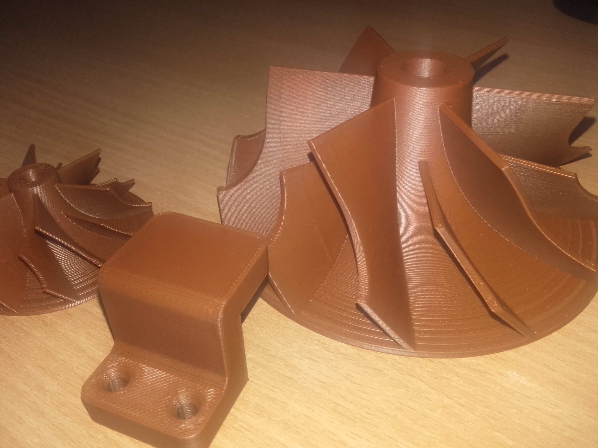

I am a CAD designer, in the field of mechanics, beginner on this forum, and own a Zortrax M200 (very satisfying), since two years now;
I recently tried a new filament, recycled and recyclable, for those who are interested of finding new filaments which are compatible on the Zortrax M200, but non-proprietary;
I made some very good printings, (very reliable, good render of the whole piece as good as with ABS filament); (parameters on photo : Z-layer: 0.29mm, full fill…); It was a very good start with this product, no problems appearing during the printings.

Hi There, we have also tested some “third” party materials and our ZORTRAX is working just fine with FILAMENTUM ABS and HIPS, ABS from UP 3d printers and we have even printed some NYLON PA12 from Fortus :slight_smile: and some other HIPS idont remmeber brand.
Hello Peer,
I agreed with you, this filament is really very good and gives excellent results/
Support and raft are very easy to remove.
