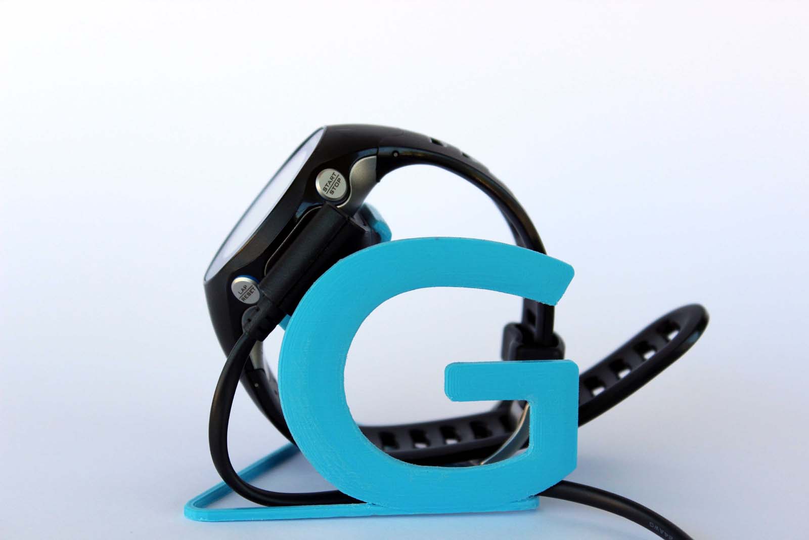

I started with a very straight, simple component for my RC helicopter, and now I have created a watch mount that is not only balanced to support the watch but has multiple curved surfaces offering functionality and a cool design to compliment my Garmin watch

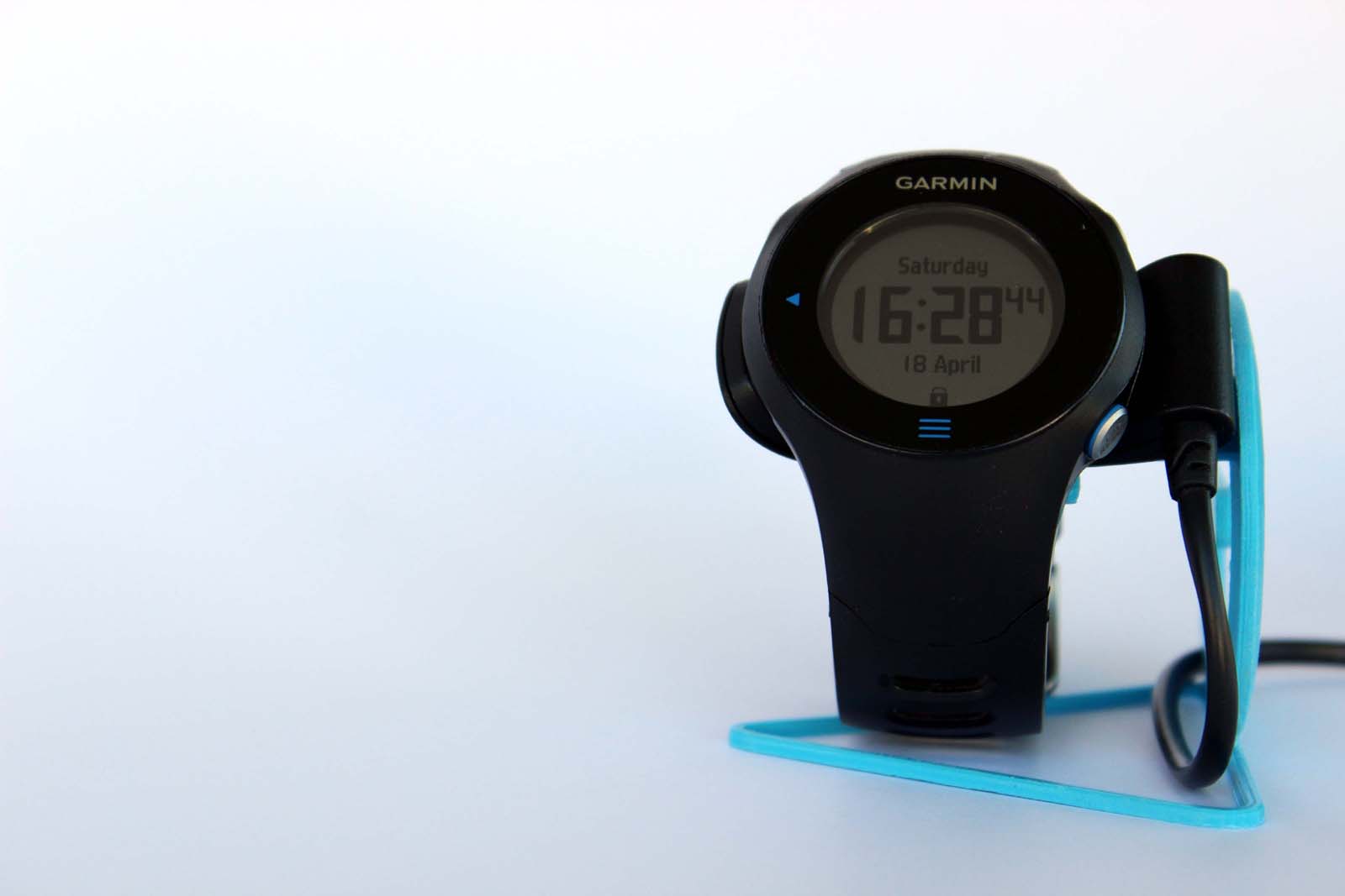

I wasnt happy with plugging in the magnetic charging cable each time and simply leaving it on the bench. I wanted to place the watch onto the stand, have the time visible and have it sit there on display waiting for its chance to be worn again.

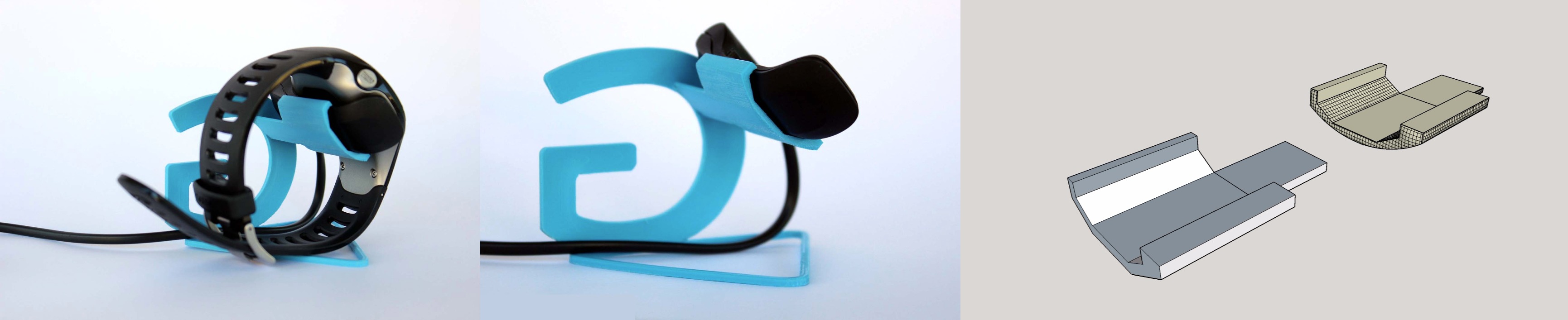

First of all, Sketchup can consume your life. The time spent drawing can be extensive and sometimes frustrating. So, the key is to draw your design first, measure everything as accurately as possible so when you start building your object on the computer, you already know what you are trying to achieve.
Keep it simple, don’t expect perfection on the first design, I made six other versions before I got to this final design so be flexible. When making changes to your model, copy and paste and make a new version. I found that after an hour of tweaking I hated the design and wanted to go back, but couldn’t.
Make different groups so you can move and adjust individual aspects of your design and then at the end, right before you are ready to print, explode all the items, form an outer shell, then combine it into a single group. Before you print, make sure it is watertight - it wont be. Fix up any little problems and then you are ready to export your item into an STL. You will need to download the STL exporter for sketchup to do this and it works really well.
I work in mm and I recently read that Sketchup wasn’t designed for mm, so I work at mm(x10) and then at the end of the build scale down by 0.1 and this will then print out correctly and the features/build options of Sketchup will work more accurately.

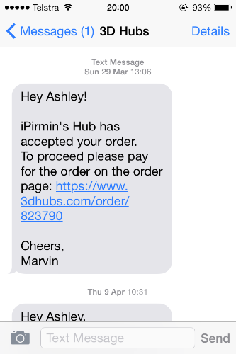

Once you submit the order you will be amazed at how simple the process it, the communication from 3DHubs is excellent and you know exactly how the print process is going. I got a SMS to say the job was accepted, the print had commenced, the order was ready for pickup all in the space of a few hours! I walked down the road and picked up my order. If you are lucky enough to own a 3D printer - register it with 3DHubs, but if you can’t afford to buy one, then this is the best and only website you should consider when you need to print an item.

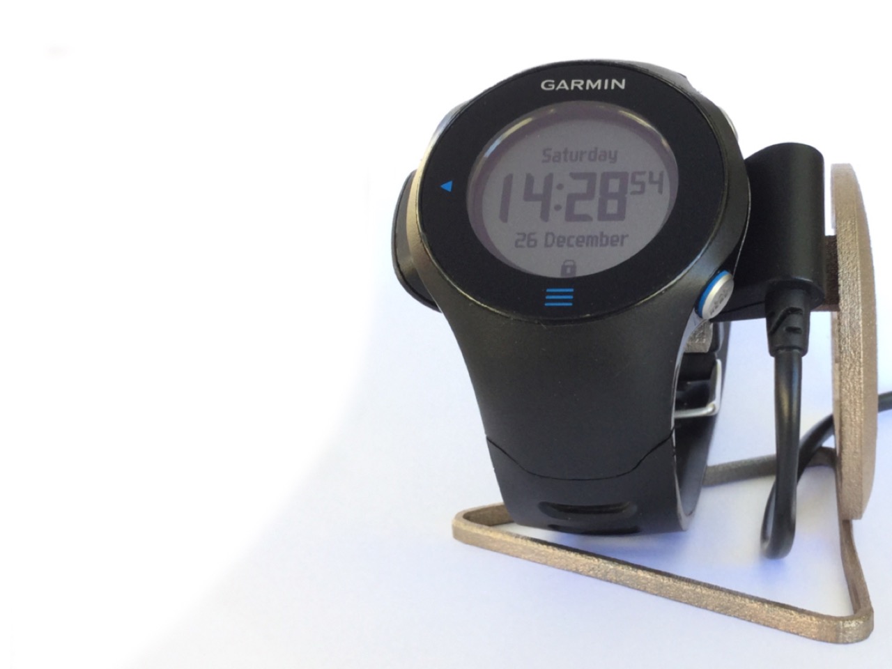

A quick update, I managed to get it 3D printed in polished grey steel. It’s also magnetic so the recharging cable clicks into place.
It really looks stunning! Do you have the files uploaded on Thingiverse or a content platform of sorts?
You can find it on Shapeways so anyone can order it. I found they have a great website and offer the best metal prints.
