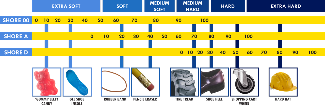

Hi Nicoline, I have never thought there was much difference between TPE and TPU, but you are saying TPU is more resistant. That sounds interesting. By resistant I assume it also means it is more durably.
I am very confused about the Shore Hardness scale. In the 3D printing environment, people talk out Shore Hardness of A 75 being very flexible, but when you look at the durameter scale, then a shore hardness of A 75 is hard, as shown on the enclosed picture.
Hi plisberg,
I think that the shore hardness displayed for the filaments are at ~ 100 infill, they are more flexible otherwise.
