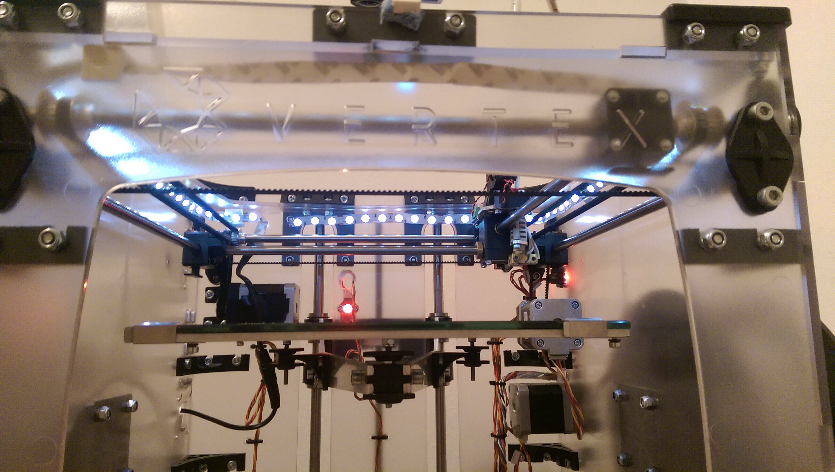

I have added a power switch and some ikea light, both on thingiverse! The power switch i designed myself
that’s cool :slight_smile: how do the lights perform ? is it worth installing ?

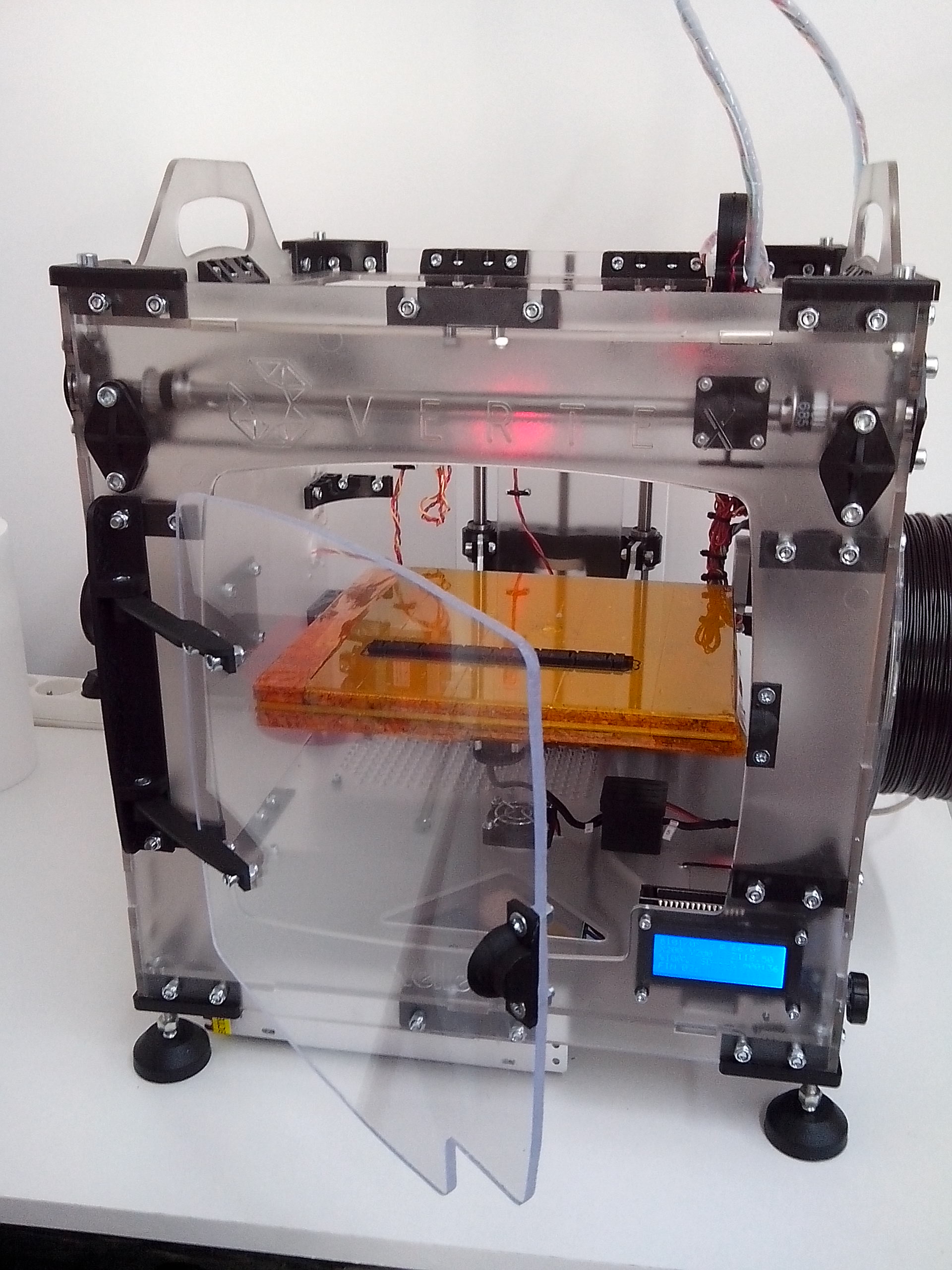

A custum heatbed.
Top bearing for Z axis. (to eliminate noise when traveling. And add support)
Printed the shield for the display electronics.
Playing around with a 90mm fan mounted horizontal under the buttom, for cooling the mainboard. Instead of the flimsy 40mm fan.
It works ok, but i am going to replace it with a 80mm. Fan instead.
I will post it on thingiverse when satisfied.
