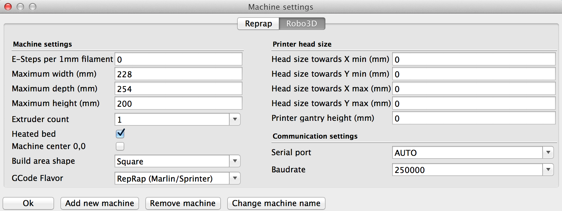

Yes, you certainly can. While print-over-USB for the Ultimaker 2 is currently not “officially supported” by Ultimaker (the company), because some users have experienced mid-print errors caused by slow or faulty USB connections, the Ultimaker 2 (and Cura) can do it.
You will just need to pass the UM2 “RepRap Flavor” G-Code, instead of “UltiGCode”. If you are using Cura, you will have to go to:
Machine > Machine settings…
find “GCode flavor” in the Machine settings window (it’s on the bottom-left for me)
and set it to “RepRap (Marlin/Sprinter)”
Alternatively, you can use other slicers (I use and rather like Simplify3D, although it’s not free) which will enable it more or less automatically.
You may encounter some issues with USB printing, like mid-print stops or glitches that cause your printer to behave weirdly or print incorrectly (although I think most people have no problems with it, myself included). To minimize these issues, use a nice, short USB cord (no more than 6ft, ideally—USB protocols do a lot of error correcting and the longer the cable is the more error correcting that needs to happen) and connect it directly to your computer, instead of through a USB hub.
If you have issues with connecting to the printer, make sure you have the Serial Port and baudrate correct (in Cura “AUTO” works just fine for me, but in Simplify3D it always tries to connect via my Bluetooth “port” by default, so I have to remember to change it to USB).
Hope that helps!
