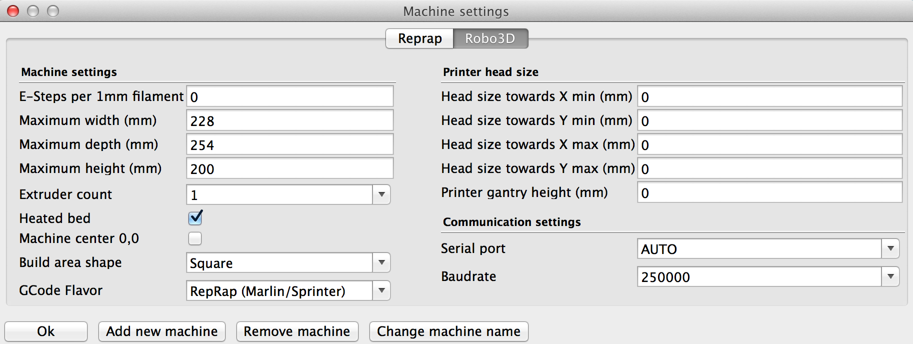

This is possible without 3rd party application.
Just set the settings of the GCode flavor to Makerbot
You just have to set the van in the gcode to activate it.
But i don’t know how to fix this.
question: why would you build you own image? there is a ready to go image called “OctoPi” which has everything pre-installed… just download the img and flash it to your drive…
I don’t understand what I have to do to get started in the sense:
- connect my laptop tot the USB of UM2
- and then…
Open Cure,
Go to machine settings.
Change Gcode flavor to (makerbot… something)
I don’t have Cura available at the moment.
The icon changes to Print from usb.
Then you can print with usb.
