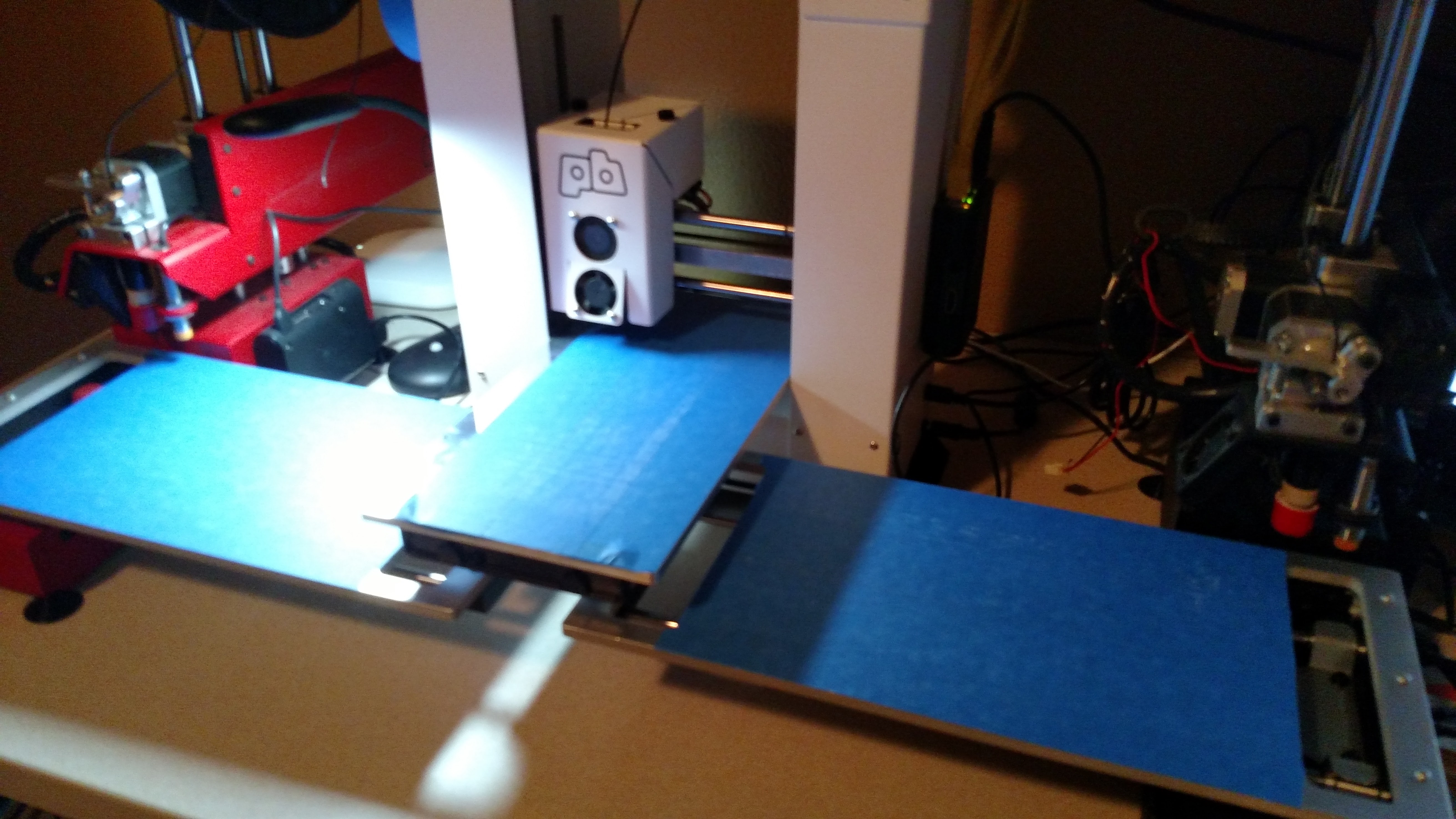

I recently bought a Printrbot Play, and I’m experiencing some problems with my first layer. The first layer looks acceptable for small objects, but when I print some bigger objects (with a greater surface) it just looks terrible.
As you can see on the picture, it looks like the infill is way to big to fit inside the perimeters of the first layer. It is actually crossing the bottom perimeter, and causing the layer to “wave”.
The small square on the left has this issue also, but less because of the smaller surface.
I use PLA to print with, and I use blue painters tape for the adhesion. I also use the G29 command for auto bed leveling.
I’m trying to find a solution for this problem quite some time now, but I had no succes so far.
Here is another picture of the bottom perimeter:
If you take a closer look you can actually see the perimeter inside the infill!
I would really appreciate any help! :slight_smile:

Turn down your bed temp and nozzle temp and turn on a layer fan on low for the first layer. That print aside from any other issues has heat issues.

You shouldn’t need a raft, they are a pain to remove. You are too close to the print bed. You need adjust the Z height with the M212 Z command. When your layers are being slightly smashed, the results become more and more evident as the head moves away from its origin. This is because the roughness compounds on itself. I would suggest moving the Z up .1 MM at a time and printing the same object. Eventually the first layer should come out very smooth. Also, make sure your bed is fully tightened down so there isn’t any vertical movement during printing.
Your first layer is too much “squish”, raise your nozzle by 0.1mm in relationship to your bed and try again. If your machine has auto bed levelling Enter “M501” into your console and it will give you a list of settings, look for the M212 line and note the z value. To adjust your nozzle up away from the bed make the number larger by 0.1mm (ie if it says z -0.6, make enter “M212 Z-0.5” if the number is positive ie Z0.6, enter “M212 Z0.7”

I have 4 printrbots and I have first layers down to a science.
First: purchase 3m blue painters tape #2094 (see inside of role)
Then lay tape across your print area.
Second: Use a cloth and rubbing alcohol to remove the waxy film that is on the top of the tape, you may want to rub it a few times to make sure its clean.
Third: lower your Z height (M501 to see what your height is, M212 Z-X.X to set it closer to the bed, them M500 to save and M501 to check our change was saved)
You want the first layer to be pretty close to the bed, it should come out thin-ish, but not be too squished.
Fourth: I print at 210 degrees for the entire print. You can try cooler or hotter based on your filament. I use Hatchbox PLA.
Fifth: Print your first layer slow. I use a 60mm/s total speed with a 25mm/s first layer speed and 200mm/s travel speed.
I have over 5000 prints logged on my 4 machines and these settings have been golden! Hope they help!

I achieved this result, which is a huge improvement!!
IMG_20160529_232713.jpg 281
Here is what I did:
- I turned down the nozzle temp with 5C
- I use the fan now for the first layers
- Raised the nozzle with 0.2mm
- Applied glue on to the painters tape (We don’t have Elmers glue in Europe so I used Pritt stick :slight_smile:
- The last thing I did was changing the direction of the infill pattern in Slicer. I don’t know why but this really helped a lot!

It it still looks like your nozzle is a bit close to the bed, or you are slightly over extruding.
What at is the height of your layers? And I would suggest turning the fan off for first 3 layers
I agree if the fan is on for the first few layers it CAN cause it to cool too much and make the corners warp (at least this is what ive been told)
I have experienced this firsthand when I started printing, had the fan on for first layer… Extreme warping and almost total lack of adhesion
