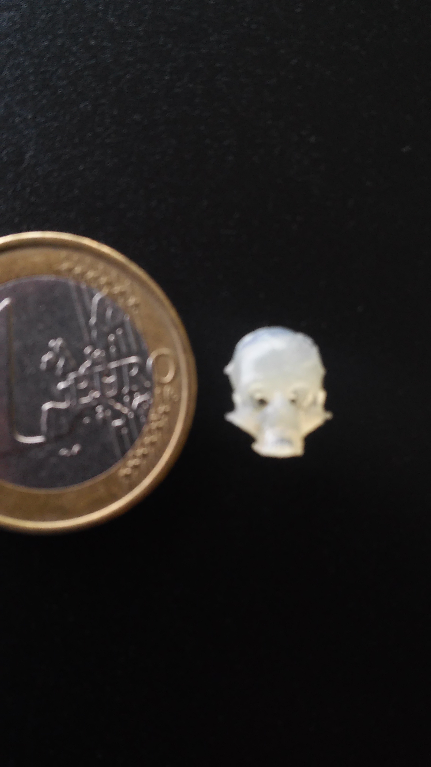

with form1 + we have make a human skull of hight 10 mm full detailed ( i mean skull stiches, tooth ,bones ) allfull detailed ,such details are very hard for every FDM printer the best solution is to print them in SLA machine
