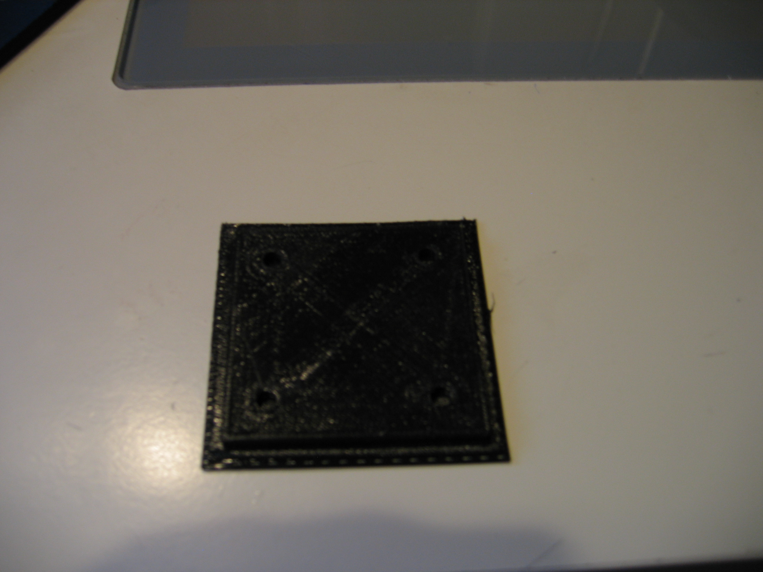

Hi Gav why not print in flexibel FPE black ? this is flexibel !

Hi Gav,
nice watches.
See the images i made for a customer. It is a flexible damper for a insertbearingblock and it looks Ok . It won’t be as smooth as the watch you sell because of the somewhat lower resolution. but i will do for prototypes
