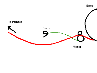

I’m thinking a small loop of slack that can hit a switch when it gets tighter. The switch runs power to a DC motor (no stepper driver required).

You should set your tension so the reel extruder always slips first. In fact ideally you should just run a pair of smooth driven wheels on them that are 1-2% larger than the nozzle one, and just set them soft enough to slip slightly, this way they’ll always be helping the nozzle extruder without causing any damage to the wire before the feed tubes.
