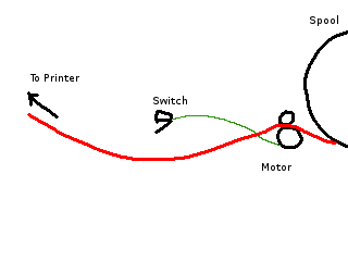

i purchased an extra extruder to ease the pull on my main extruder.
I connected both stepper motors in parallel (I cut the 4 wires to the extruder and attached in parallel, the remote stepper motor. Both have the same gear size (12mm). To my surprise (I am new to this 3d printing as i got my first DIY printer just a couple of weeks ago) the new estruder was pushing the filament fast, but the old extruder with nozzle was pushing the filament slower than usual, as i saw the print that was having under extrusion in the result.
Can someone help me with how I can fix this issue? I would like to know if its ok to connect 2 steppers in parallel with the same driver or is that the reason i dont have enough power to energize 2 motors?
Thanks for all

You can, but there are cautions to make them work right together. Same wire length to each. Each has to be the same stepper type/part number to insure they both will draw the same current. You have to adjust the current up on the driver circuit as now you have twice the load. If one is doing more work (most likely the one driving the plastic into the extruder because extruder pressures can be high) it is going to load down and require more current because it is doing more work. This will unbalance the system. It’s actually better to parallel the input signals to multiple drive chips and drive the steppers separately. This is easier if your chips are the plug in type.

Z-axis motors are sometimes put in series, sometimes parallel. In series the current trough them is the same, so torque is the same. Parallel, voltage is the same, so theoreticaly RPM would be the same but these are steppers so there isnt realy a V/rpm thing… I’d put them in series. (And I did, for my Z-axis)

I was putting an extra extruder not to push the filament into the nozzle, but to pull the filament from the spool and not have the extruder have to work hard to pull from the filament roll. With a slack in between the two extruders, so that there is always the same slack between the two extruders. The PTFE tube seems clear and everything works perfectly without my added extruder whose purpose was only to pull from the filament hub and let a slack before the main filament.

There’s nothing fundamentally wrong with push-pull extruder setups, it’s a trick regularly used in the welding world to negate the friction in the bowden tube and allow less clamping pressure on soft wire/filament to prevent distortion causing issues elsewhere. Quad driven rollers are often used on single drive units too for wire over 1-1.2mm
However, your stepper driver should be current clamping, so wiring them in parrallel will give them only half the current each, if you have enough voltage overhead (steppers are usually a very low nominal voltage and your driver uses all the extra to maintain current draw when microstepping and similar), then wiring the two in series shouldn’t hurt performance anywhere near as much.
You should set your tension so the reel extruder always slips first. In fact ideally you should just run a pair of smooth driven wheels on them that are 1-2% larger than the nozzle one, and just set them soft enough to slip slightly, this way they’ll always be helping the nozzle extruder without causing any damage to the wire before the feed tubes.
