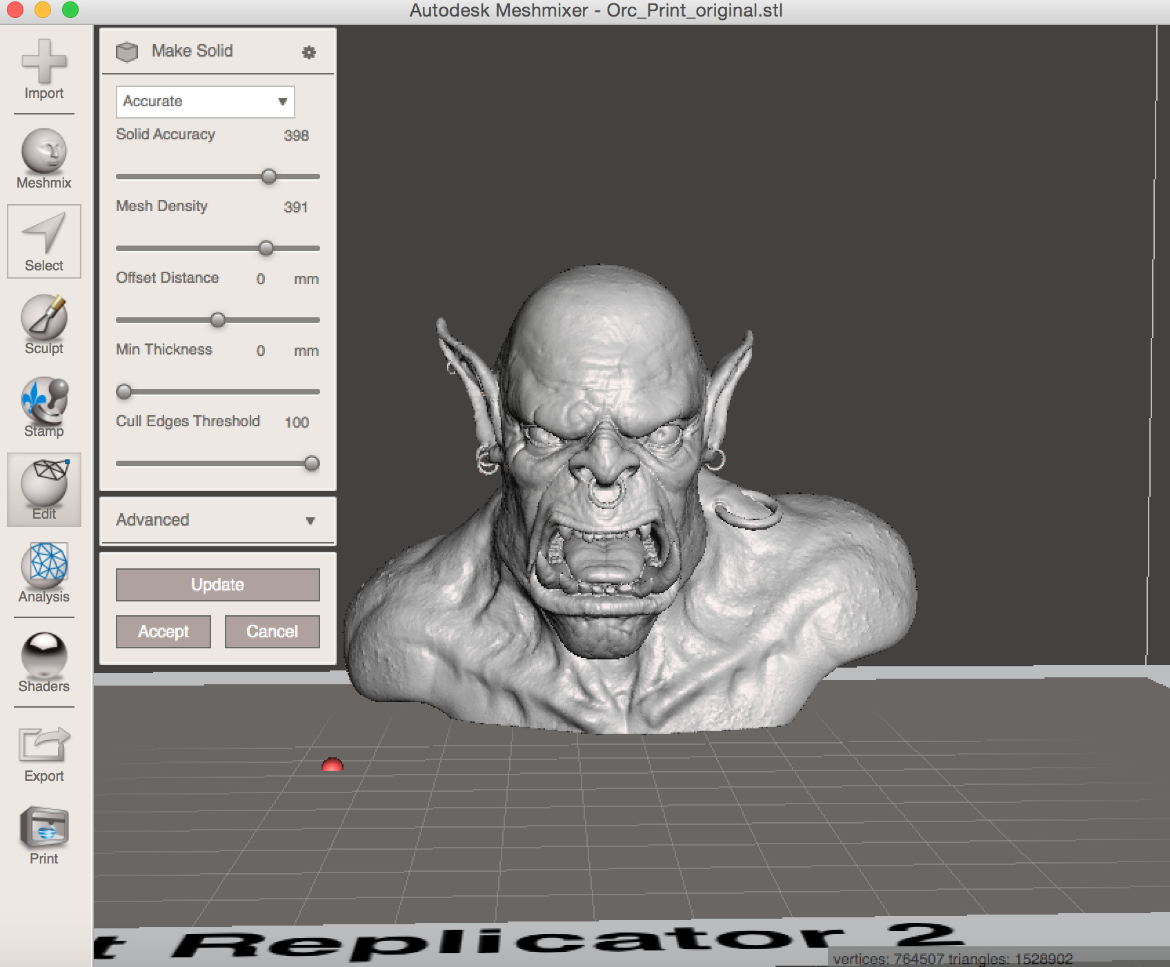

Autodesk Meshmixer [Free]
1. In order to reduce the polycount using Meshmixer you have to import your .STL file
2. Select your model by double clicking on it
3. Then click reduce and drag the slider over to the percentage of polygon’s you would like to have remain. Usually 80% is a good amount that will still preserve the polygons that determine the shape of the model.
Before:
Polycount: ~1.5million
After:
Polycount: ~420,000

There seems to be a missing step between 2 and 3. What is “reduce” ? It does not show up when one selects their model.
Hi @Starwind0, it can be a little confusing seeing as Meshmixer has “Edit” in two different spots within the program. First, use the ‘Select’ button on the left hand side. Then, double click your model (which will turn your model into a dark shade of orange) and a new menu should pop up on the left hand side that at the very top says ‘Edit…’. Third from the top after clicking ‘Edit…’ says ‘Reduce’.
