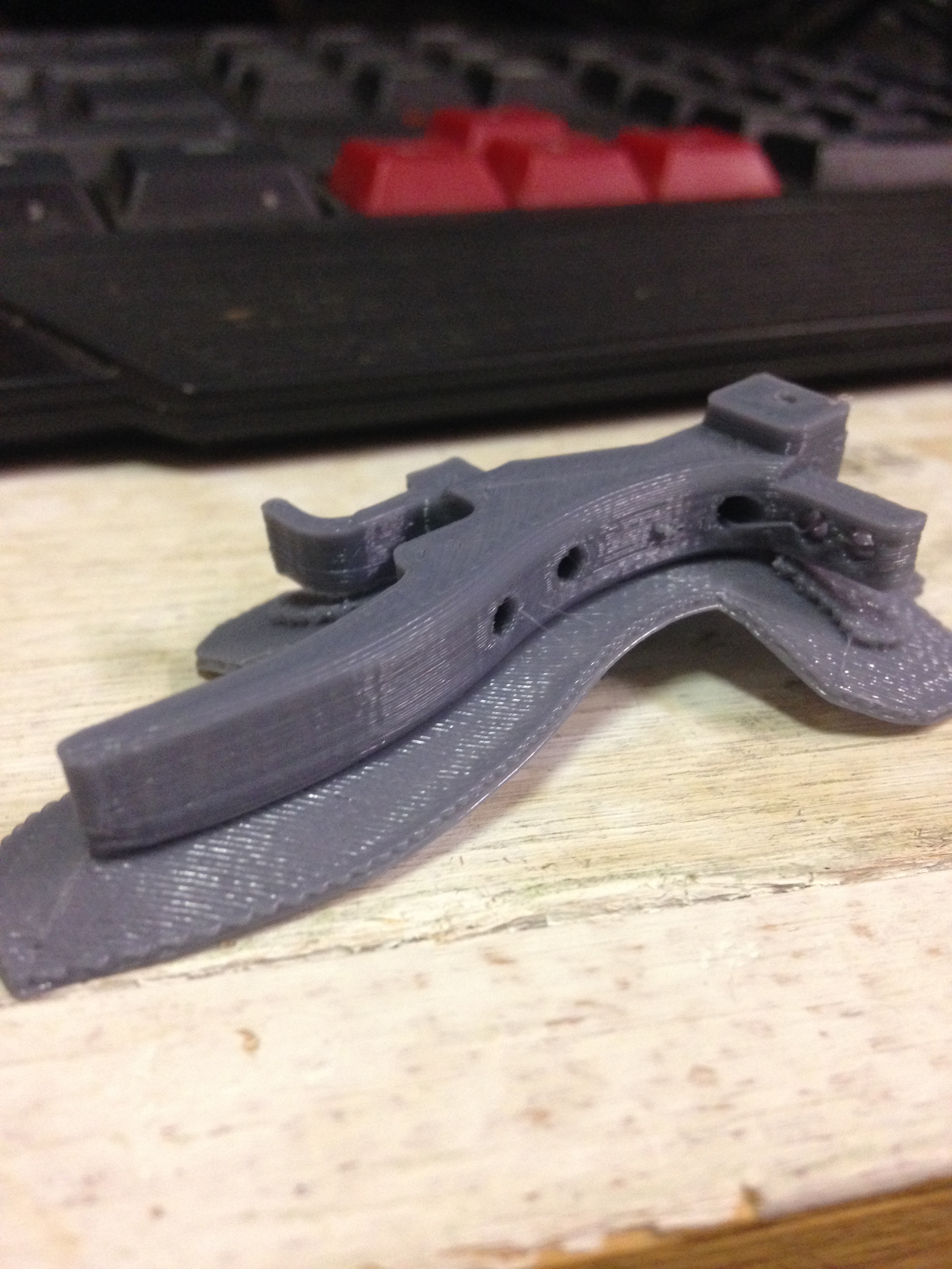

hello, I have been using matter control with a Robo R1 plus. I have been having a raft problem of the raft not being able to come off of my print very easily. How could I fix this?
did you try re-leveling the bed? and if so I would say could be the temp printed at?
You should have an option for airgap, increase that by .2-.3mm. Airgap is how close it prints the actual print’s first layer on the raft. Closer (value closer to 0) makes it stick better to the raft but too close and it’ll practically become part of the print like a brim.
Robo 3D’s have autoleveling by default and from the looks of his print, temp seems fine. Couldn’t hurt to add more possible solutions.
It depends on the slicer software you use. With Simplify3D it’s the “separation distance” field whose value needs to be slightly increased. In slic3r there is an equivalent field.
You may be overextruding plastic as well and need to tweak your flow rate but from the pictures it doesn’t seem to be obvious so I would stay with the separation distance parameter

I re-leveled, and my prints are looking better then ever. I have it set at 50c and I’m being told to just use glue stick and no temp, then I’ll have the raft peel off from my print easier. My supports are the only thing that is getting messed up and if I can print on glass with supports, but it seems like they warp all the time on glass but not on the raft
I have been using matter control the one that comes with the Robo. It has an air gap of .3 already. I could go further and see what it does. It never hurts! Haha
I’m using pla for the moment. I tried using glass and it works fine for the first layer of the regular print. It is just when my support layers go on the glass it warps that’s what I’m trying to figure out. If I can do that I will have great prints.
