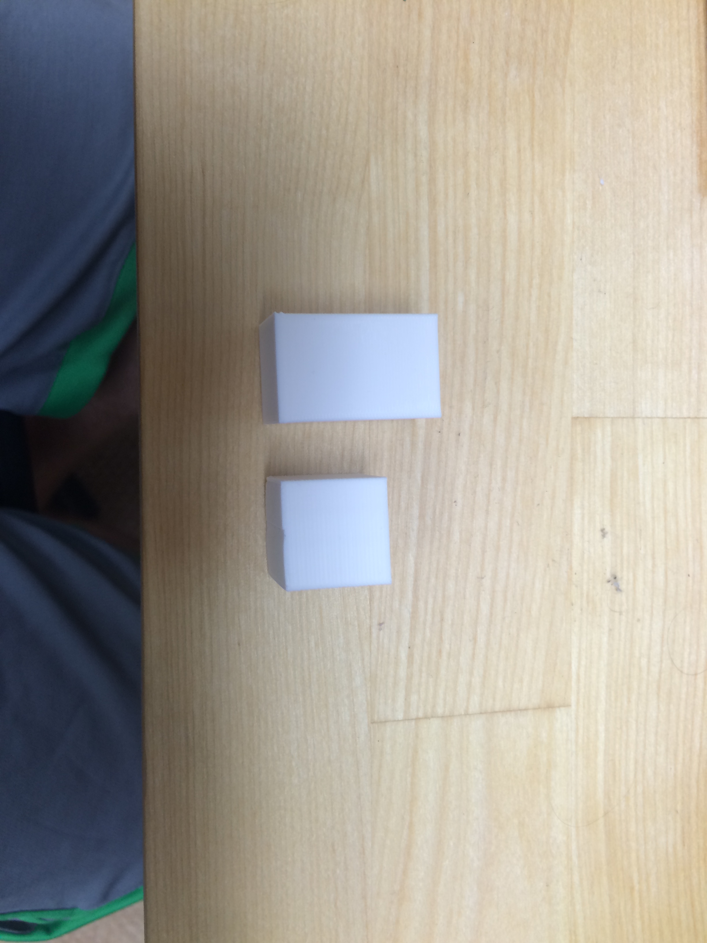

For some reason every print I do, it gets stretched by 10mm. Here is an example: Right cube is correct height (20mm) and the left cube was the same cube but printed 30mm tall for some reason.

Hey @qqron17, could you provide some more information? What printer and slicer are you using?
I am using a modded Da Vinchi 1.0a on RAMPS 1.4 and Simpiify 3D v3.1
Now this is a good mystery!
You say it stretchs the print by 10mm. Not a percentage?
That is, if you print a 30mm cube, does it become 40mm?
If you print an object that is not a cube, what does that look like?
Step one would be to make sure you have selected the correct printer in s3d, and reset your settings from scratch s3d-reset.
