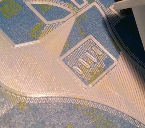

Hey Patrick. It does look like your z offset may need to be adjusted a little lower, however I expect that the majority of your adhesion issues are due to your bed prep. What type of blue tape are you using, and how did you prepare it for printing? Painters tape is coated with a wax, which helps its primary function for masking paint edges. It makes a lousy surface for hot plastic to stick to, though. It’s important to remove this coating before trying to print. Some say that the brand of tape makes a difference - I can’t say for certain because I’ve only used Scotch 2090 since it was confirmed to be good. You also need to wipe down the tape with alcohol before printing to remove the wax and any other oils or contaminants. Most people use isopropyl alcohol, I use denatured alcohol from the hardware store just because I had that on hand but no isopropyl when I started printing.
Scotch 2090 tape is very easy to find, although it will cost a bit more than store brands. It’s the one with a white stripe on the packaging and says “general use” or “multi-use” (I can’t remember for certain.) It will say Scotch 2090 on inside roll, but I think it’s also listed on the outer wrapper as well. I use the widest roll I can find, it technically costs a little more per square inch but it’s a lot quicker and easier to lay down and I have less seams.
I hope this helps, if you still have trouble let me know.
Thanks, I had not heard about the wax and alcohol. I am using 2090 3m scotch tape and freeze hold hair spray.
Try without the hairspray as well. I’ve never used it with blue tape, it’s my understanding that it’s used with a bare metal bed. I’m not sure if it’s good at getting a better release when printing is complete, I often have trouble getting my prints off the bed without marring the tape and having to put down a replacement strip.

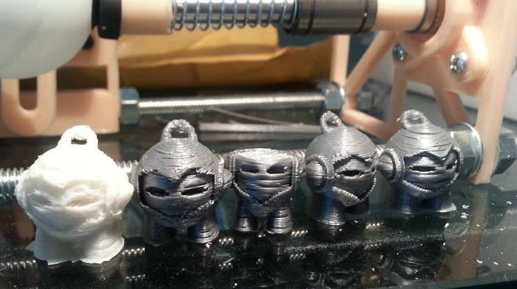

Marvin in 3D Solutech “Real Silver” sliced with Cura 15 and printed on the stock Printrbot Simple Metal heated bed model 1403 with thing:356001 and thing:607836 upgrades; printed at 0.09525 layer height (all layers), 187C, 15mmps, 4-shells, 30% infill, 40mmps travel, 0.98 extrusion multiplier (on calibrated extruder), 100% fan @ 0.2mm, PVA (Uhu) over PET on 0C bed in far-left corner with 25mm diam, 2-shells “cooling” cylinder printed in close-right corner:

this is amazing; all the little support material is right where it is supposed to be.
wow, I wiped the bed with alcohol and it’s super sticky! Thanks who suggested that.

What filament did you use for the shiny marvins on the right? Do you have more pictures of stuff printed with that?
Its the same filament as the other picture, but at 200 micron. has a satin look.
I would use a layer height of .2064 and a base layer height of .254 this is the reccomended layer height using the 3/8 lead screw according to the prusa calculator and printrbot. Also try slowing down your print i had luck printing marvin at 30 mm/s and also adjust your z offset to the hundreth of a mm and use a raft when printing small intricate objects.

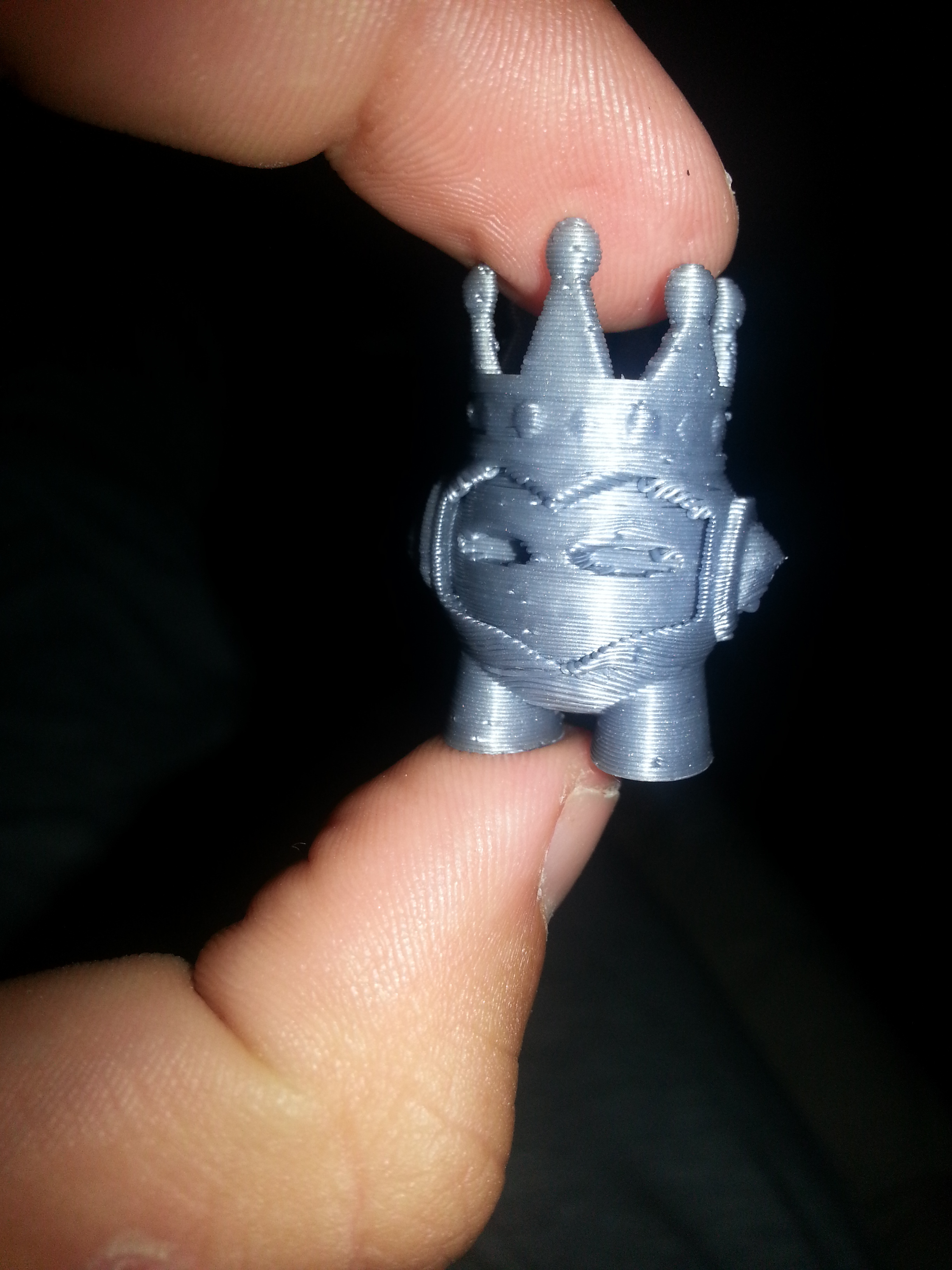

fiveangle, thanks for the details here. Have you ever printed Marvin with ABS at 0.1mm?
What settings would you use for ABS?
I assume that your “cooling cylinder” is a second model which you are printing to move the hot end away from the primary print to allow each layer to cool. What retraction settings do you use when doing this?
I have attempted to print Marvin with Yellow PLA and Black ABS on my Printrbot Simple 1403
The PLA print came out nice, but I am still having trouble with ABS.
I have images posted on my hub page:
https://www.3dhubs.com/montgomery/hubs/craig
