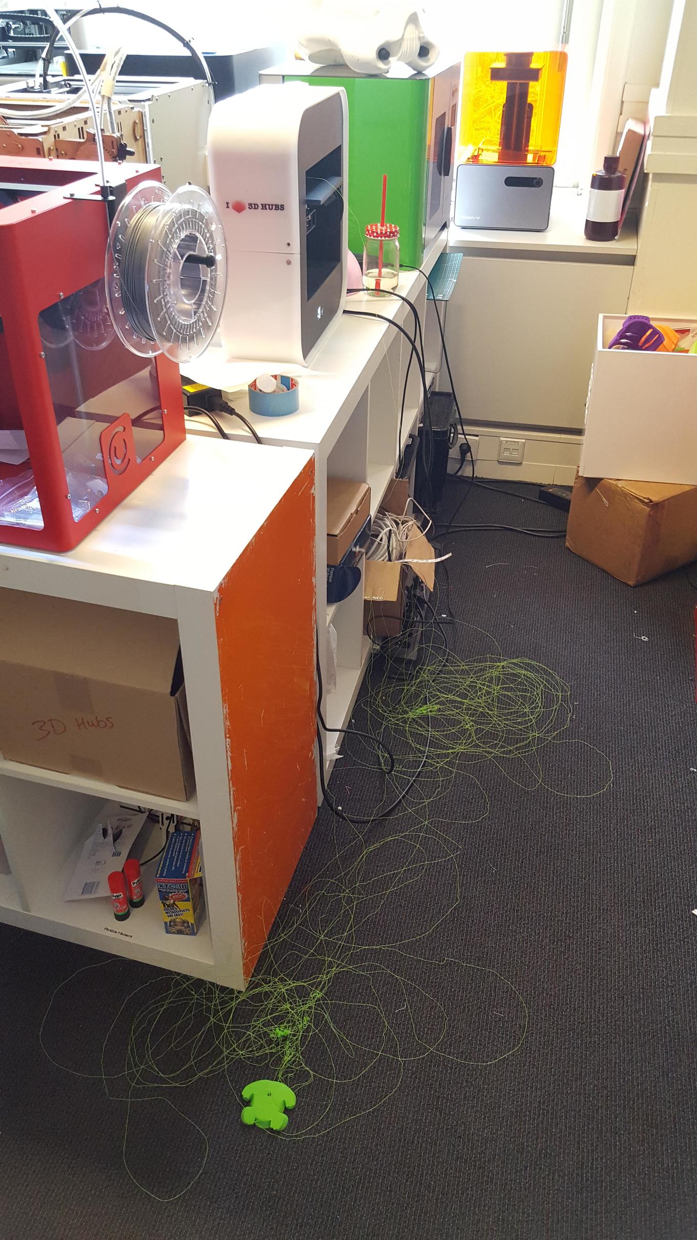

3D Hubs caters towards a wide range of customers. With 3D Printing being a fairly new technology, many customers are not aware of the potential limitations of 3D Printing and the models uploaded often reflect this. I have seen my fair share of spaghetti models and crazy post-modern futuristic buildings designs. While the designs look cool, actually getting them printed is a very different story. What’s the best course of action when there are some questions when it comes to the printability of a model? Of course, it depends on the type of printing technique you use, the main focus of this post is printing with the General Purpose Plastics material group (GPP).

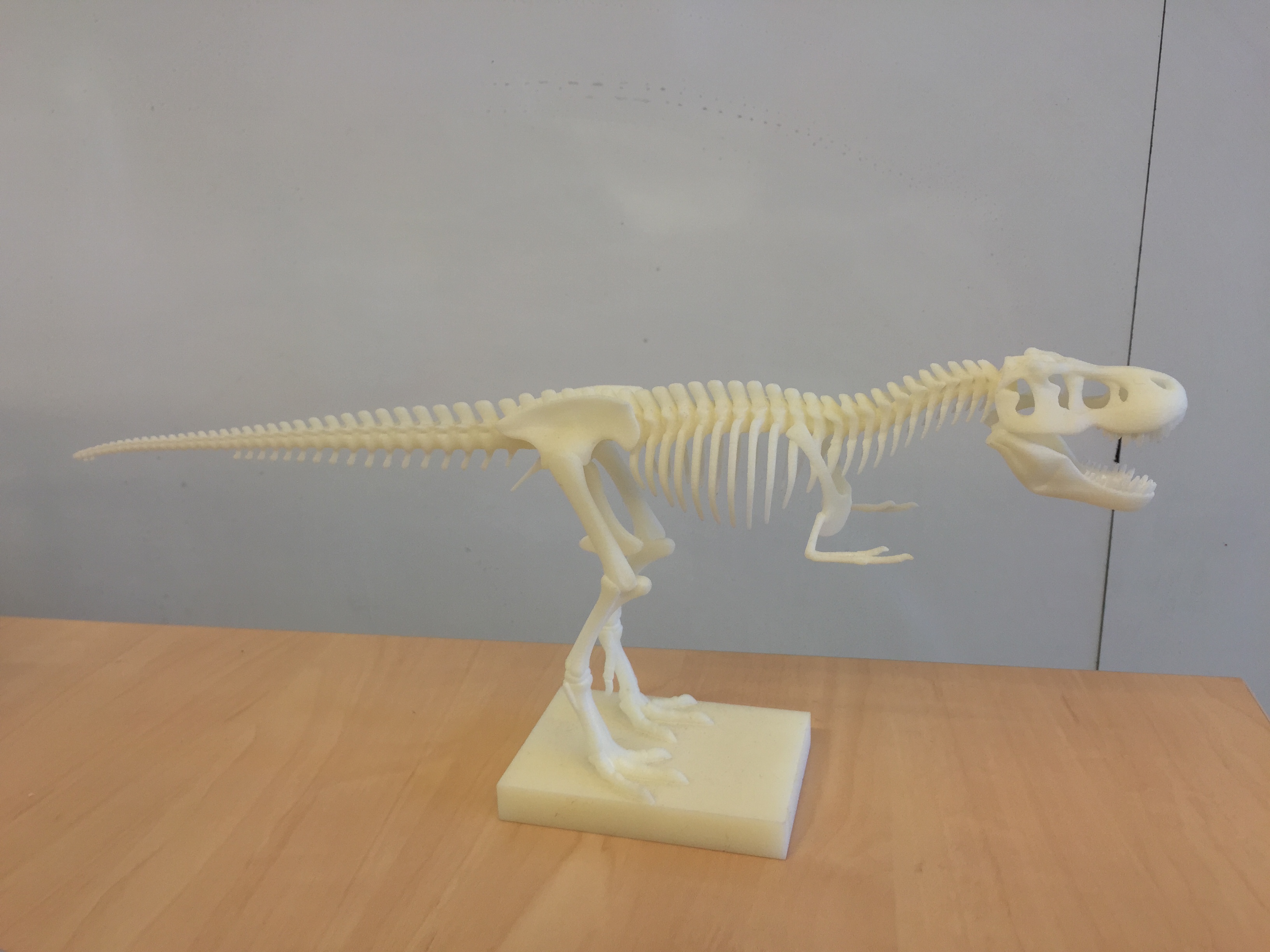

It’s printed actually… But not with GPP! Lots of overhang and complex design which makes it impossible to print with GPP. This print is done with the strong & flexible nylon material group.
There is a very small chance of success with these sorts of models.

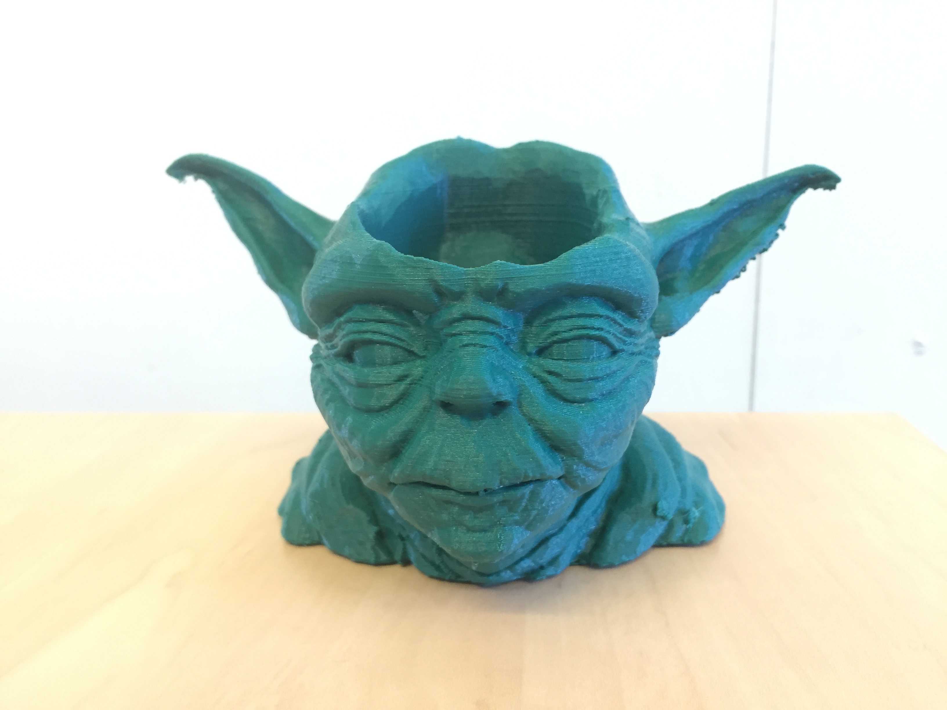

Borderline Designs
It’s printed with GPP… But as you can see, it’s definitely not perfect! The bottom side of the ears have some bumps on it, due to the overhang.
